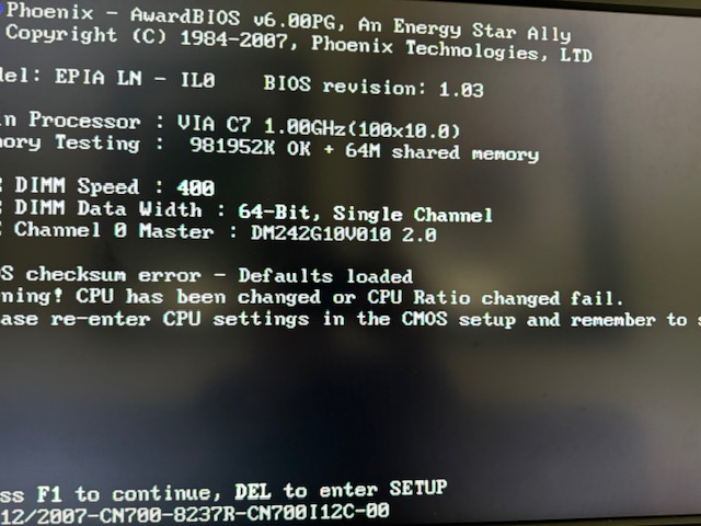

It works again! It was giving me a message after hooking up to vga . That I had to hit F1 so I replaced the battery while under power . And behold! It’s Alive again.
But now on every boot it gives this massage so I think I have to go into bios set the time using the password and the auto power at ac loss and then save ? As it won’t boot without me shorting the pins the start the pc
If you or anybody have screenshots of correct bios settings it would be great

You have it correct. Enter the BIOS, make sure power on is set to auto on power loss and save settings. I think the checksum error should correct itself.

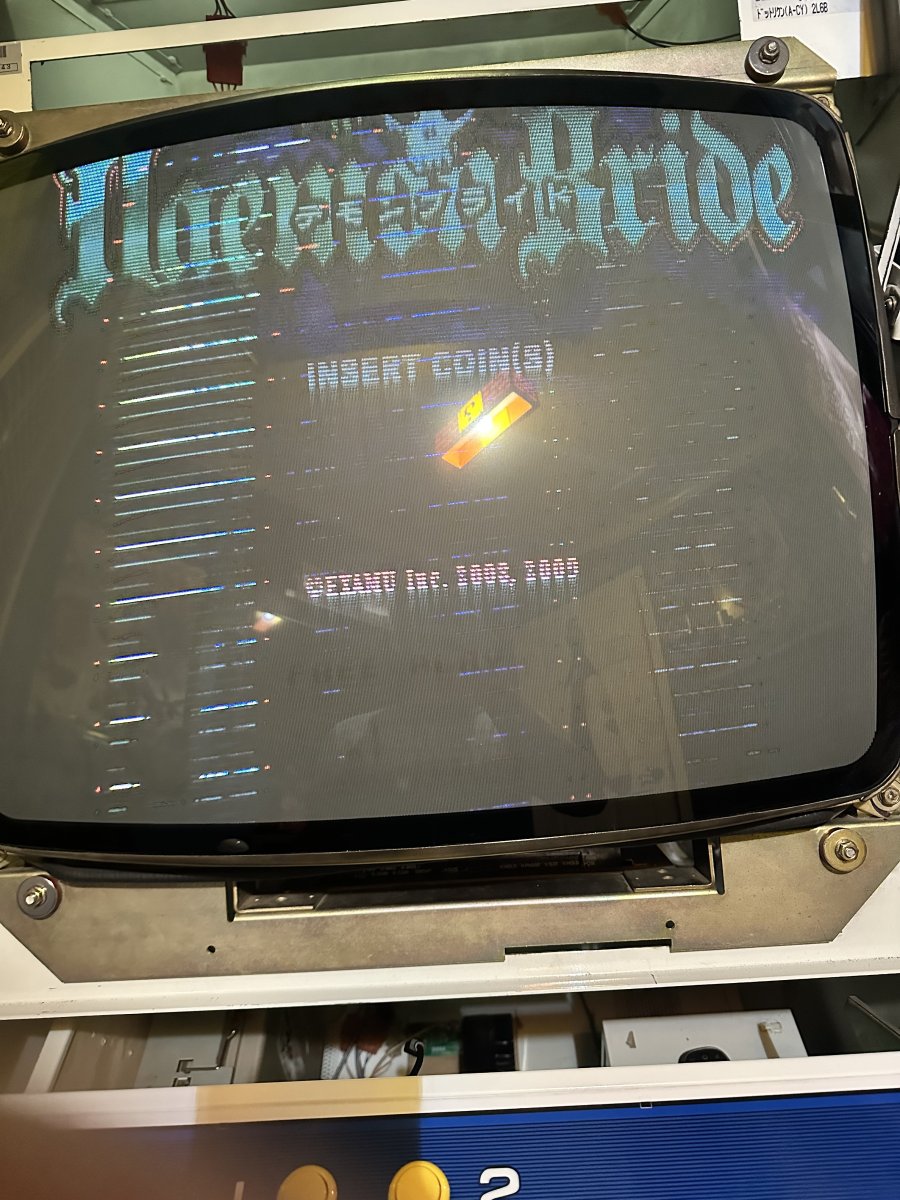

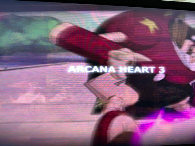

Hey guys could use a little help. Just received a EXAMU exboard with Daemon bride and having problems with the picture vertically scrolling. I tried adjusting the vertical hold on monitor which helped but the picture is still scrolling. I have dip 1&2 on as well as dip 8 on for 15khz. I checked all connections and weather I have the power switch on back of pcb up or down does not make a difference.
