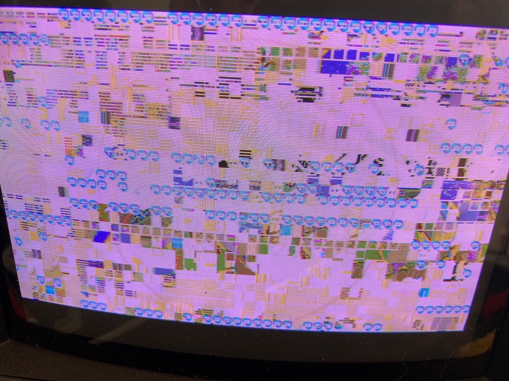

Behind the wall of garbage I can see what appears to be some of the fix layer, or it could be nothing at all, it's just something flickering. Something else is definitely wrong here. That's frustrating.

For the graphics fault i'd scan the 157's first, followed by the ram and 161's.
Tile rom does the title screen and overlay text and not the in game scroll layers so you want to check starting from the back. The scroll layers will be mask rom(s).
For the CPU problem, check clock lines and reset first, then traces to the roms and main ram, followed by any buffers / select lines connected with the cpu.
CPU may be toast if it's running overclocked, seen that all the time on bootlegs.
It's repeating the same thing over and over again and I've got no sound, so I don't think it's booting. It looks like a RAM test screen.

It no longer gives me a full screen of garbage, instead it gives me a shrunk line of garbage in the middle of the screen, so I think it's actually giving me the correct output resolution now meaning it's getting further than it was in the boot process.

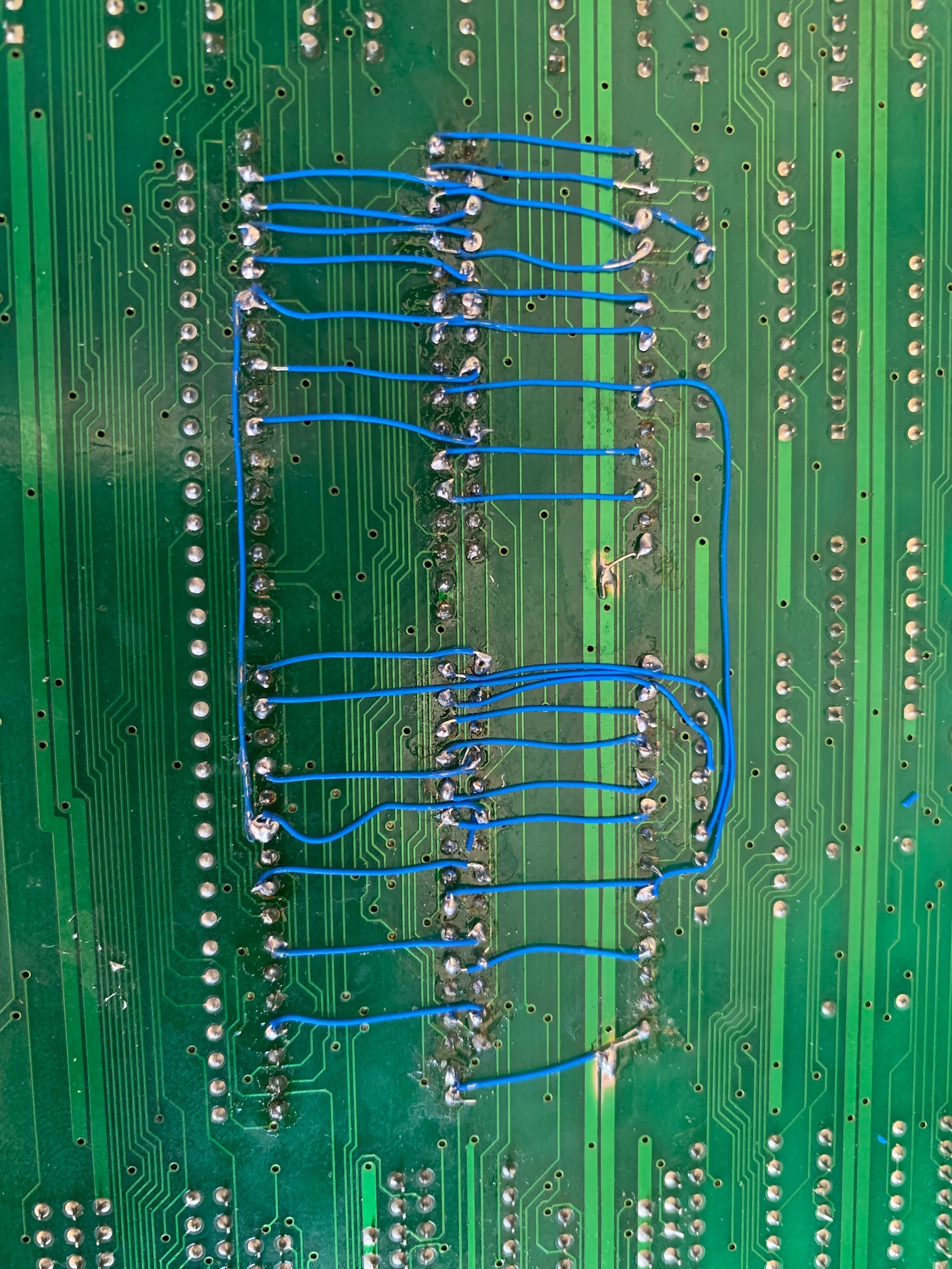

So I thought I would update this thread as I have spent quite a bit of time trying to get this board to boot but sadly it seems to be too far gone. I'm not going to be going any further with this, at the end of the day it's a bootleg, albeit an extraordinarily rare one. I have dumped the ROMs along with @sylphia for preservation.
I have done extensive trace repair after removing everything from the area to trace where it is all supposed to go and it now boots to a screen of garbage (it's reading main program code but crashing) instead of the rug patterns I was getting before where it was searching for the work RAM and couldn't see it.
And here is a shot of all the repaired traces. Yes it's a bit ugly because I haven't cleaned it up, I just needed it to have all the correct connections in place to see if it would boot. Also, ignore the flux I haven't yet cleaned off :)
