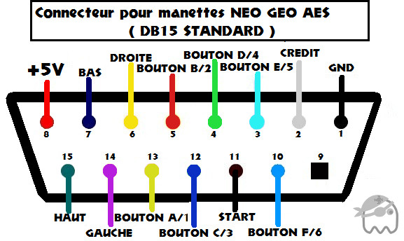

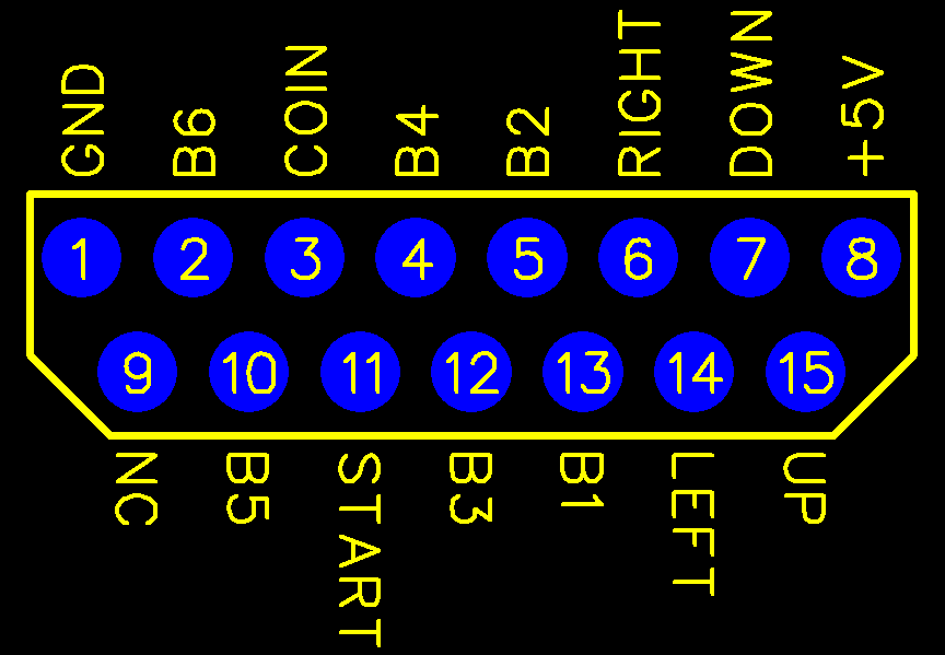

Yes the Snes to Neo adapter will work. Their pinout isn't ideal however the HAS appears to allow button remapping so this shouldn't be an issue. Their pinout has buttons 5 and 6 wired opposite to how they should be if one were to extend the Neo pinout in the same fashion as the standard pinout.
@Frank_fjs
Looks like "Select/Coin" is wired to DB15 pin #2 instead of pin #3 like in the NeoGeo pinout, so this one will need to be manually re-wired on that adapter.

I wouldn’t talk about standards written in stone in this case. I mean, on one side we have Neo Geo AES DB15 pinout and, on the other side, Jamma pinout… then we have logic, but no written standards. I agree that mapping AES Select pin to Jamma coin pin is the most logical choice, but again, it seems to me that Retroelectronik is not breaking any ISO standard. Again, mapping B5 on pin 10 and B2 on pin 6 pleases my inner OCD having even buttons on the upper row and odd buttons on the lower row, but again… that’s it. They are smartasses and their strange SNES2NeoGeo adapter pinout matches their SuperGun pinout, but I see this more problematic for the Supergun (which has an additional screw terminal for input) than for the adapter. You can use the adapter with their Supergun, with HAS Supergun (through remapping) and honestly, with NeoGeo and platforms with less than 6 button, the worst that can happen is that you have to use SNES L button to insert coins. We can even reprogam the Arduino easily starting from this
https://github.com/burks10/Arduino-SNES-Controller (I'm a software guy, not a hardware one).
