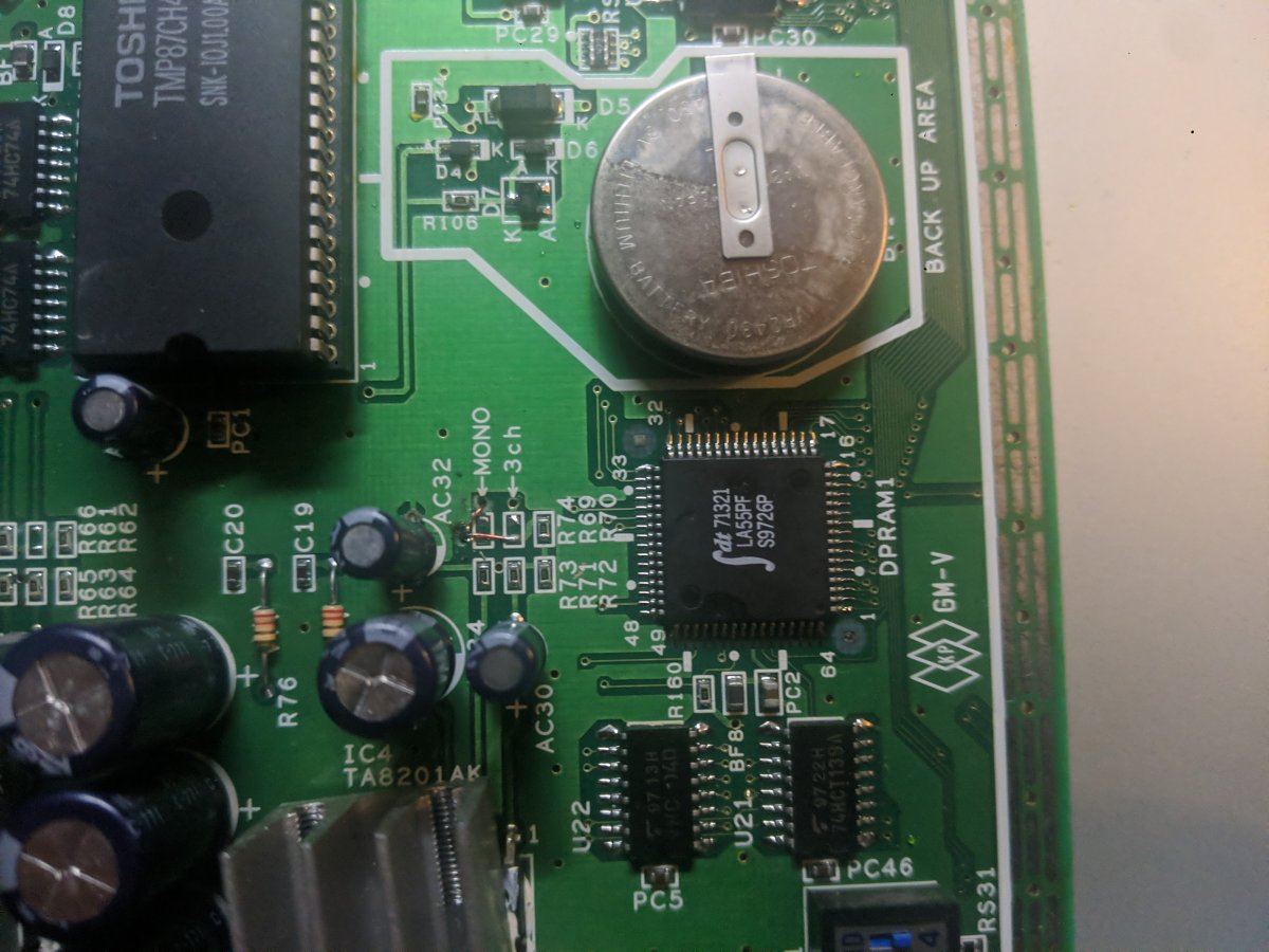

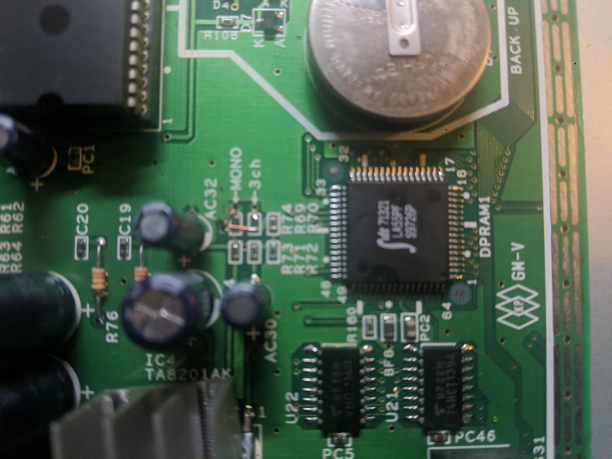

notsonic Champion Joined Oct 23, 2019 Messages 1,023 Reaction score 1,268 Location NJ Apr 4, 2023 #21 It seems like it would be a better idea to mod your cabinet for stereo than to mod the board for mono, no?
mathewbeall Champion Joined Nov 6, 2017 Messages 1,770 Reaction score 1,286 Location Mission Viejo, CA, USA Apr 4, 2023 #22 Certainly could - I have a JAMMA cabinet though - so switch back and forth. It was just easier for my use case.

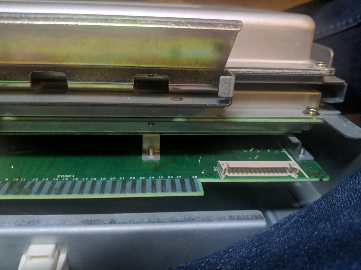

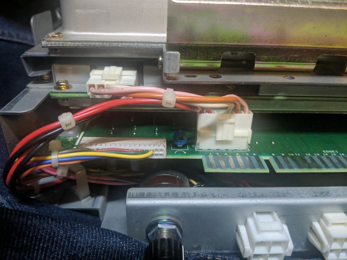

cruzlink2 Professional Joined Oct 12, 2015 Messages 272 Reaction score 395 Location Brooklyn, New York Apr 4, 2023 #26 the one I am work on is different than the one in this picture. Last edited: Apr 5, 2023
cruzlink2 Professional Joined Oct 12, 2015 Messages 272 Reaction score 395 Location Brooklyn, New York Apr 5, 2023 #27 Here is the one I am working on. Attachments IMG_20230405_000434.jpg 158 KB · Views: 51 IMG_20230405_000438.jpg 139.2 KB · Views: 51 IMG_20230405_000501.jpg 136.6 KB · Views: 50 IMG_20230405_000504.jpg 159.3 KB · Views: 54

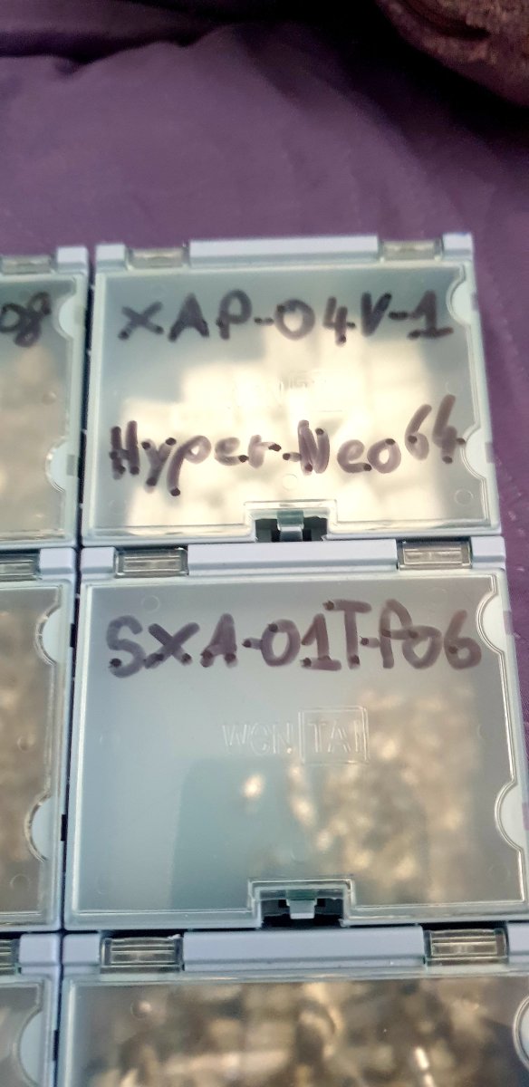

chacal231077 Grand Master Joined Dec 21, 2017 Messages 683 Reaction score 230 Location France Apr 5, 2023 #28 Hi! everten For Hyper Neo Geo 64 Motherboard rev.2 only Connector Stereo : JST XAP-04V-1 connector & SXA-001T-P0.6. Contact
