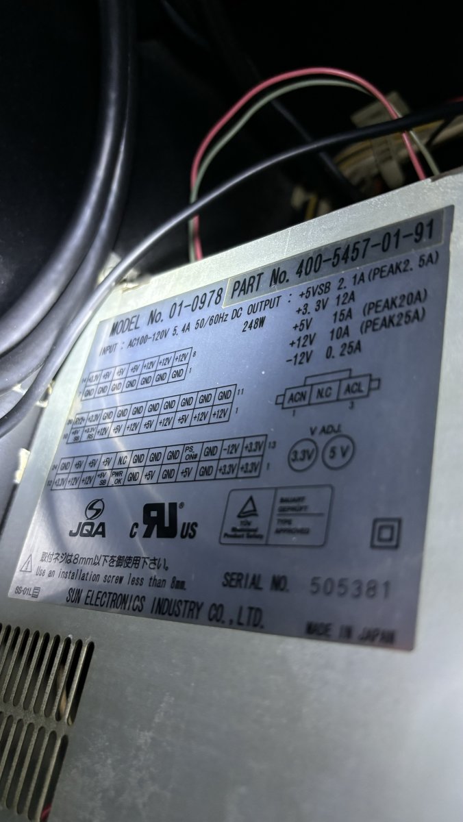

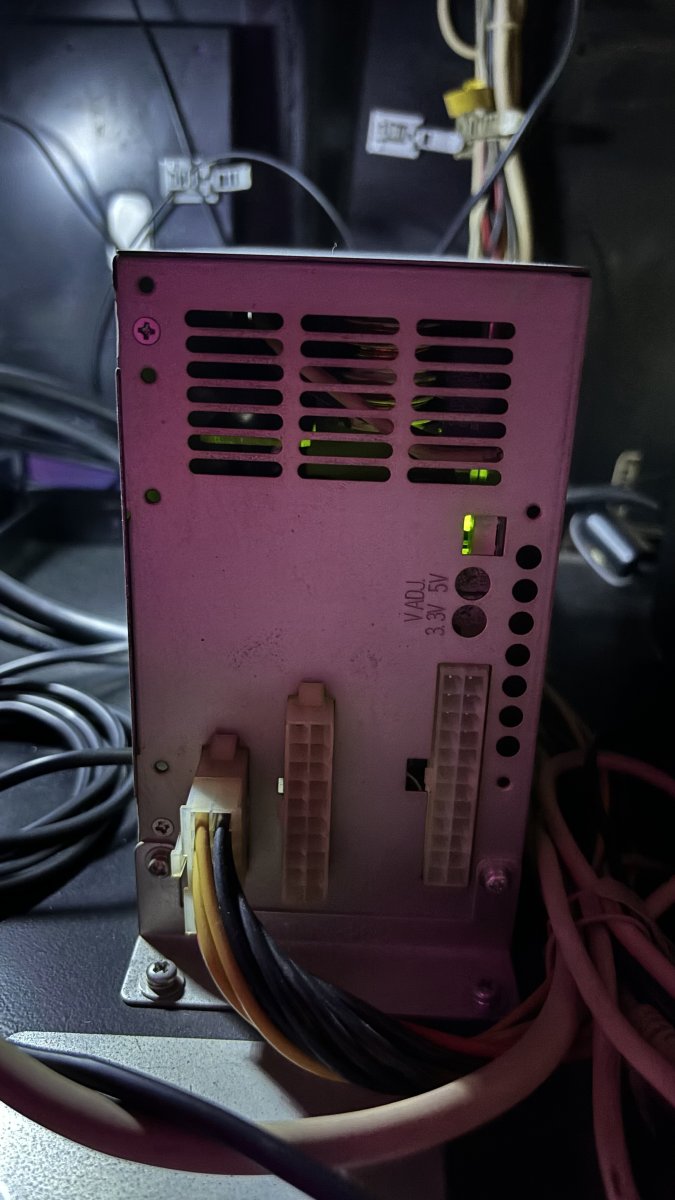

Hi everyone. I’m looking for a more modern power supply for my Japanese Sega Lindbergh. The power supply I am using works but it is super loud and it revs up and down as if it was on its last breaths. I searched online but I couldn’t find any alternative that had the same ports. Please take a look at the pics I posted.
Any advice would be greatly appreciated.

It doesn't have the same input connector, not the same format but the outputs are identical, that's why I use Ringedge motherboard power supplies.
