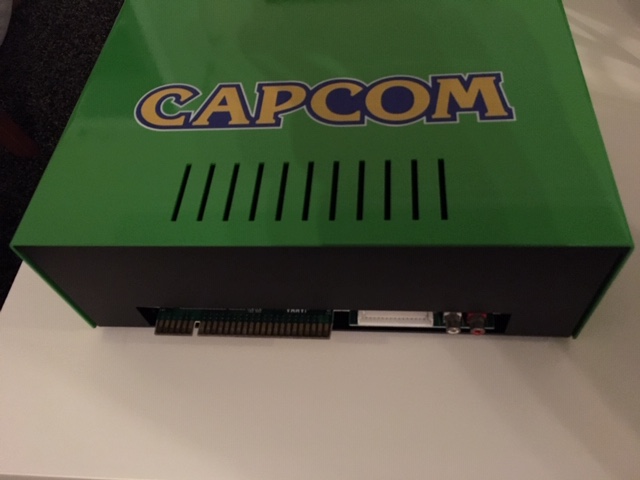

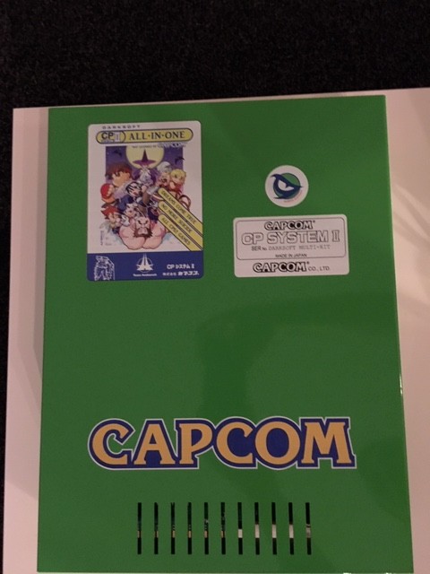

I just snapped the photos today. Slowly but surely putting my kit together.

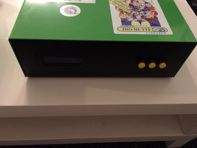

I wanted to post a little PSA about setting up newer CPS2 multis in this enclosure. When I got my enclosure I was having issues mounting the LCD screen. Simply put the LCD was too wide to fit in the cutout that was provided on the enclosure.
After talking with Jasen he determined that at some point the LCD part that the Darksoft Multis were using had been changed for a different one, and the new LCD is 3mm wider than the old one. The solution that we came up with was to put spacers between the mounting standoffs and the LCD board so that it sits behind the opening instead of being recessed inside of the opening. I couldn't get washers in the correct size at my local hardware store so I just added 4-40 size nuts to each standoff and screwed the screen in that way.
This creates a new problem though, the actuators for the tactile switches on the LCD board are not tall enough to pass through the wall of the enclosure once the spacers are added. The best way to solve this would be to swap the switches with a different part that has a taller actuator. According to my measurements they would need to be at least 15mm tall. The best drop in replacement I could find so far was this. at 16.3mm tall it's actually a little excessive, but the next tallest switch I could find with the correct footprint is only 13mm tall which won't work here. An alternative to replacing the switches would be to desolder the existing switches and solder them back to the board but raised up a couple millimeters. That's been my stop gap solution until I make my next parts order and get the replacement switches.
Other than the LCD change issues everything went great and I'm very happy with the enclosure.
In case anyone was wondering my Multi Kit was purchased at the beginning of June, I'm not sure when the LCD was changed, but if you have purchased a multi recently you might also have the new LCD.
