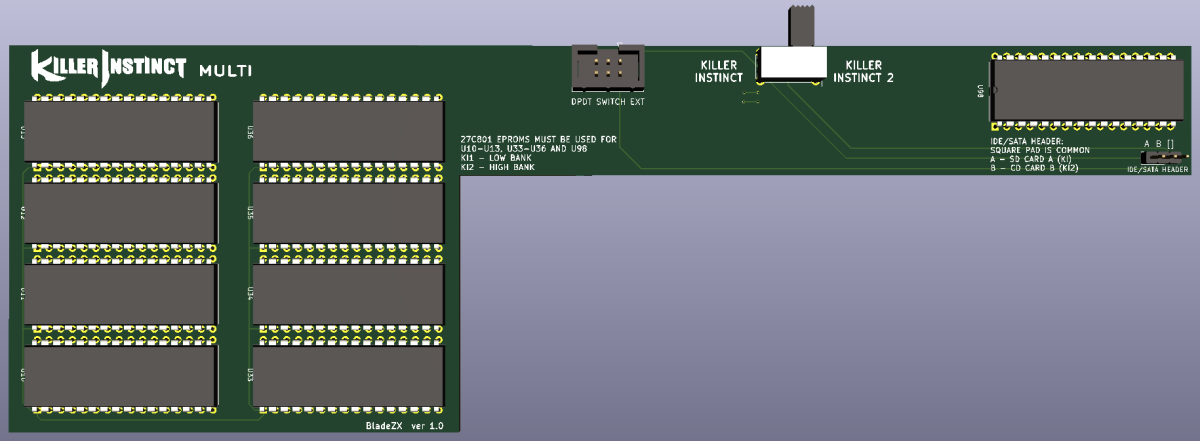

The reason I ask is this, I got everything installed to my cabinet using the exact same parts in this guide, and at first I thought it was up and running perfect…
I was running KI from side-A of the 2in1 SD/TF adapter, and KI2 from side-B.

I finally decided to remove the 2in1 dual SD adapter completely and run each game from the micro SD cards directly to the board while keeping my switched 5V and GND lines hooked up to the linked ROMS respectively, and sure enough this way both games play flawlessly back to back.
