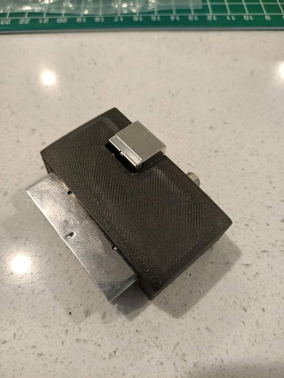

Ha, I'm getting there. Will extend it just wanted to verify fitment and things lining up first. Otherwise it's a waste of time and printing materials.
Think I'm just about done.
It's a bit of a wonky print as I just rushed it to prototype, low print quality settings etc, but she fits like a glove.

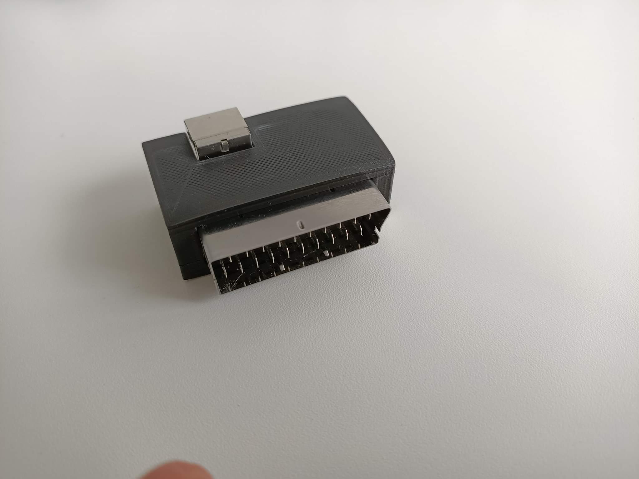

This is exciting to me. This Mini din 8 to scart adapter means you can use generic cables, separate audio if desired, feed in stereo audio from games such as CPS2 etc, it has proper scart voltages for CRT TVs to push AV / RGB / 4:3 mode and based upon a suggestion from @jassin000 I'll be incorporating a scart pin sync output switch to accommodate the OSSC hardware mod to utilise TTL sync from F3 and other troublesome games via the OSSC scart input.

seems a bit short
The idea is SCART ports in 2019 are silly...
We should be promoting/using 8pin mini din as the 240p scene standard.
I intend to insert a few of these adapters into my OSSCs and SCART switch so I can achieve that goal.
Having a low profile is key to this "set it and forget it" viewpoint.
If anyone did not see the OSSC mod yet take a look here...
By switching Sync pin 20 to Sync pin 12 you can process Sync using AV3 port.
F3 can work via AV1 (no HD15 cables/HATs required)!

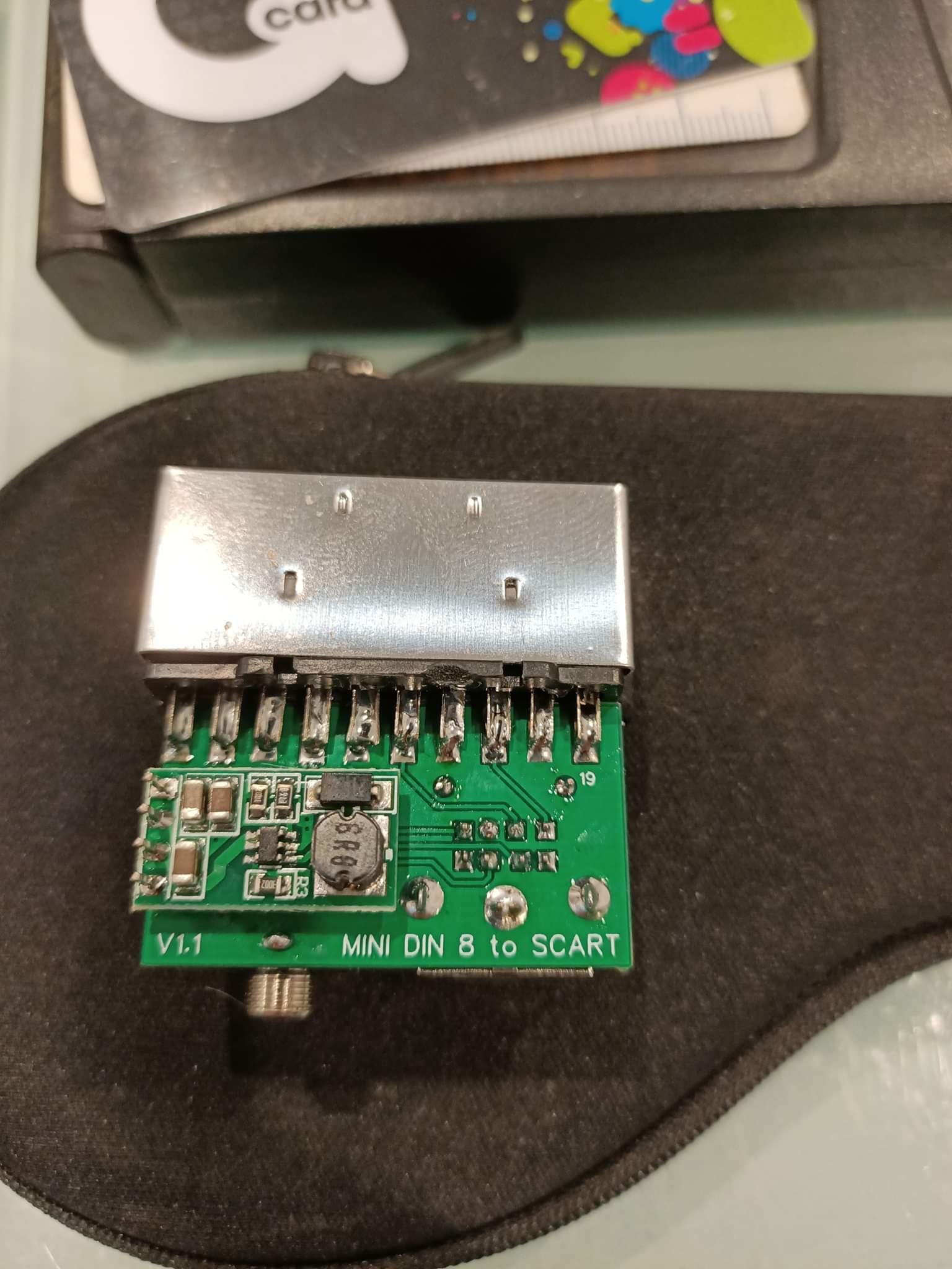

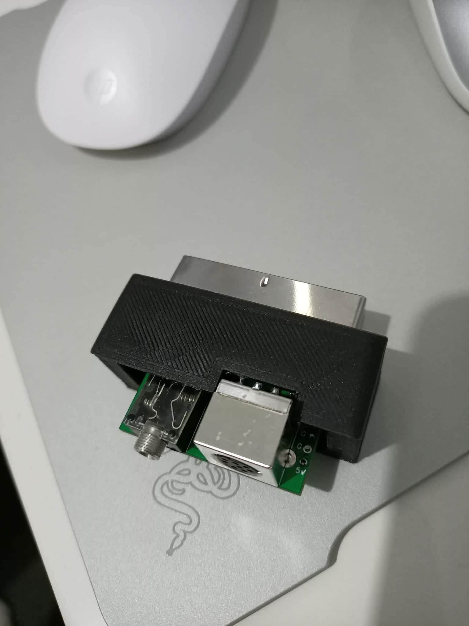

DC booster boards for the impending mini DIN 8 to scart adapter boards arrived today. Fit perfectly, function perfectly, still fits inside the 3D enclosure. Yes!
This was the last piece of the puzzle. Can now release these into the wild.
