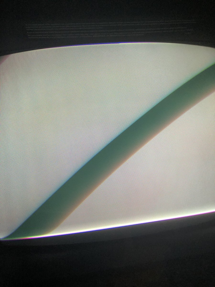

So i have a board with no sound but worked booted up.. then i pushed down on the soundboard a eprom to see if i could check the chips.. then now i get a white screen?? No led on main board nothing and i can smell the pcb alo. Heres a pic

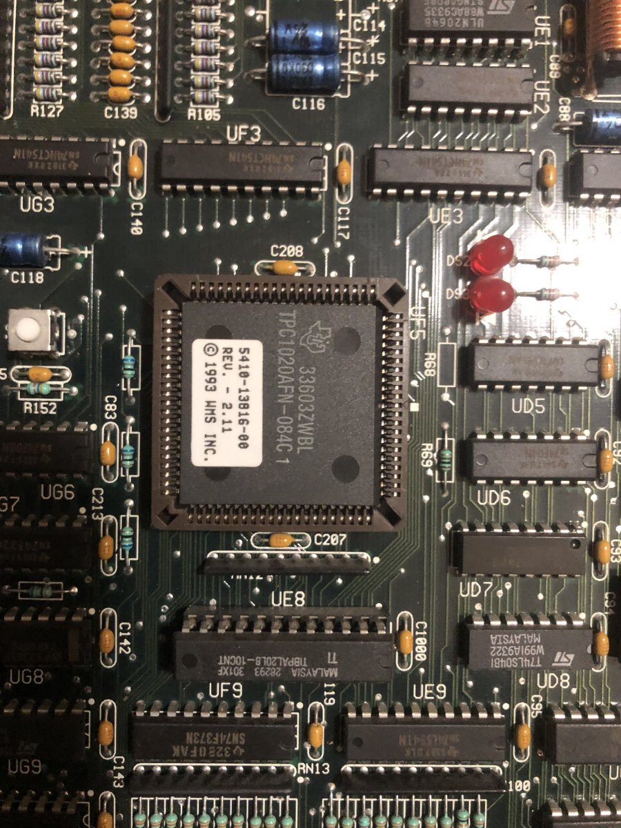

Smells coming from this
When you said you smelled smoke, I was afraid of that. That’s the main CPU.
start with this, disconnect the sound board completely and all harnesses. MK2 will run fine without it, just wont have sound.
next remove and inspect, then reinstall the chip you say smells funny. you'll want to use an appropriate IC puller for it and not just pry it out with a screwdriver or something.
while you're at it , pull inspect and reinstall the other 4-sided socketed chip while you're at it.
check for burn marks, signs of oxidation (all of the pins of both the chip and the socket should be look shiny and polished). Also check that none of the pins look mis-aligned, crooked or pushed in too far (on both the chip and the socket). and check for cracks in the socket, especially in the corners. The plastic can become brittle over time the corners will crack and then it doesn't make good contact on the pins anymore.
Once you've done that try powering it back up without the sound board or any of the sub-harneses, see if it boots and check the 5V and -5V pins on the JAMMA edge.

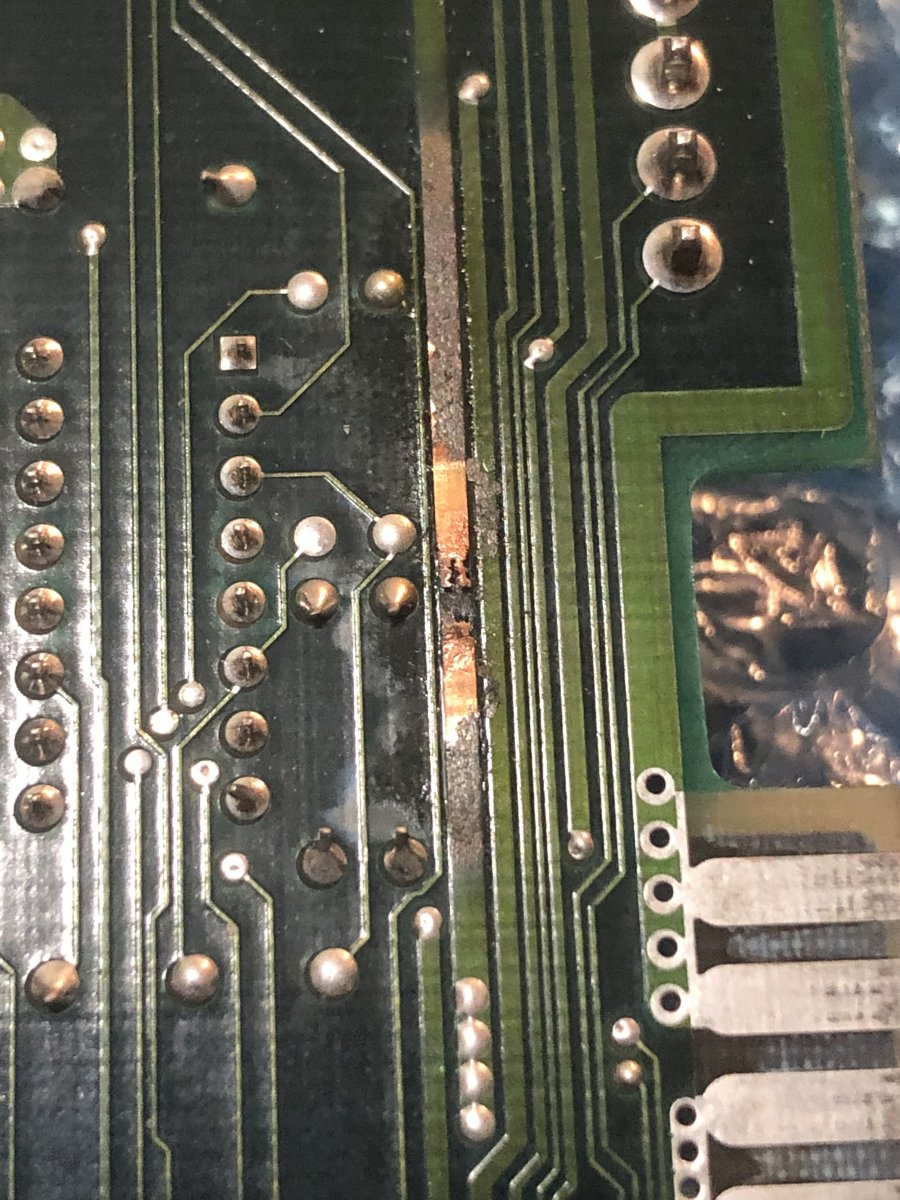

I spotted this new to me
Looks like you fried one of the voltage rails, considering how fat that trace is. You could use a multimeter to figure out whether it's 5V or 12V, I doubt it's -5V.
Either way, you'll need to patch that trace. You may want to have someone more experienced take a look at this, considering there could be more extensive damage judging by that spectacular failure.
How do you repair a trace? Ill try my self
you have a serious problem if you cooked a trace that fat. it looks like a main voltage line right off the JAMMA edge.
I'm pretty sure that's the 5V feed to the sound board power connector.
repairing the trace isn't a problem, it's a symptom, you need the find the root cause and fix that otherwise your trace will just blow up again.
the large metal coil near the sound board power connector, when you were pushing around did you accidentally short the sound board or something else against that?
No i just pushed down on a soundboard chip and it did that somehow? Not even the same board? Lol
My guy, there is ABSOLUTELY no way that you get a white screen of death off pushing down a soundboard rom. My brother in Christ, you can play it without the soundboard entirely.
When you pushed the soundboard rom down did it drag the main board inadvertently? Could you have hit something else nearby and caused a short by bumping into it?
Because you’re saying you’re smelling smoke, have broken traces, etc. off the soundboard, it’s like saying “I bumped into the garage door” and I go outside and your car is on its hood ripped in 2.
