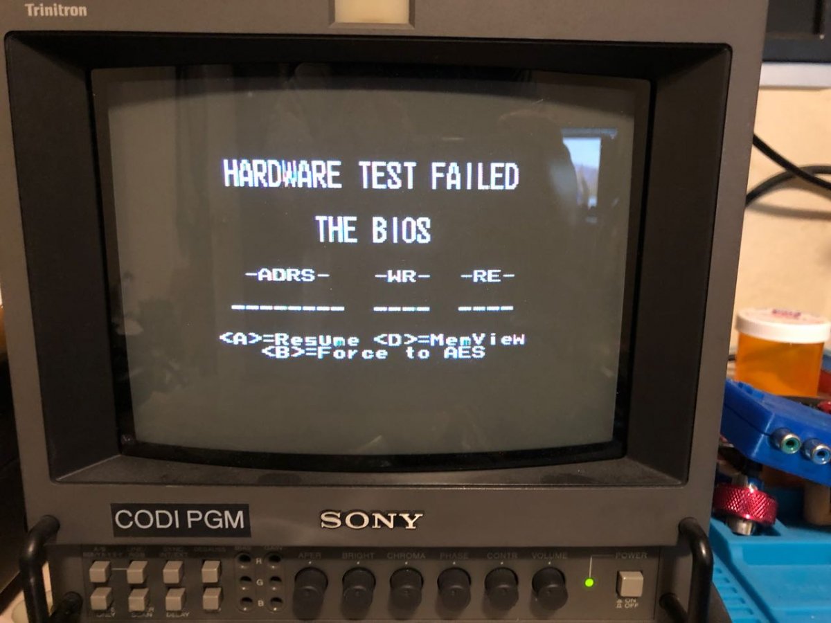

So taking another stab at fixing this MV1FZ that's been under my workbench for years. About 90% of the time, when powered on it presents the following less than helpful error.
With the UNIBOS, I can press <A> and from then on it works flawlessly. I've already replaced the RAM, but that seems to have had no effect. I've run the NeoDIAG BIOS and cart on it, and it passes every ttest.
So... what's wrong with this thing? Any ideas?
make a fresh bios on a faster eprom and report the result.
With the original factory BIOS, it simply halts. The UniBIOS copy I'm running is one purchased from Razoola back in the day (has my name on it & everything). No issues there. This has been a head scratcher for years.
You should check on the status/health of your hard dips. If the stock bios was really halting/crashing it would trigger watchdog and a reboot. If you are getting a video signal but its a black screen its an indication the bios is in a paused state because it thinks hard dip 8 is in an 'on' position.
Interesting... will give the hardware switches a test and see what's what.
Edit: So what I see is that there is some connectivity when a dip is off, reading around 0.8. But that seems to be normal compared to other boards. So the dip switches look OK. In addition, if I do toggle switch 8 it halts as expected. I only get the BIOS error when it boots normally.
