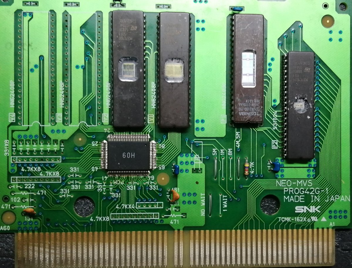

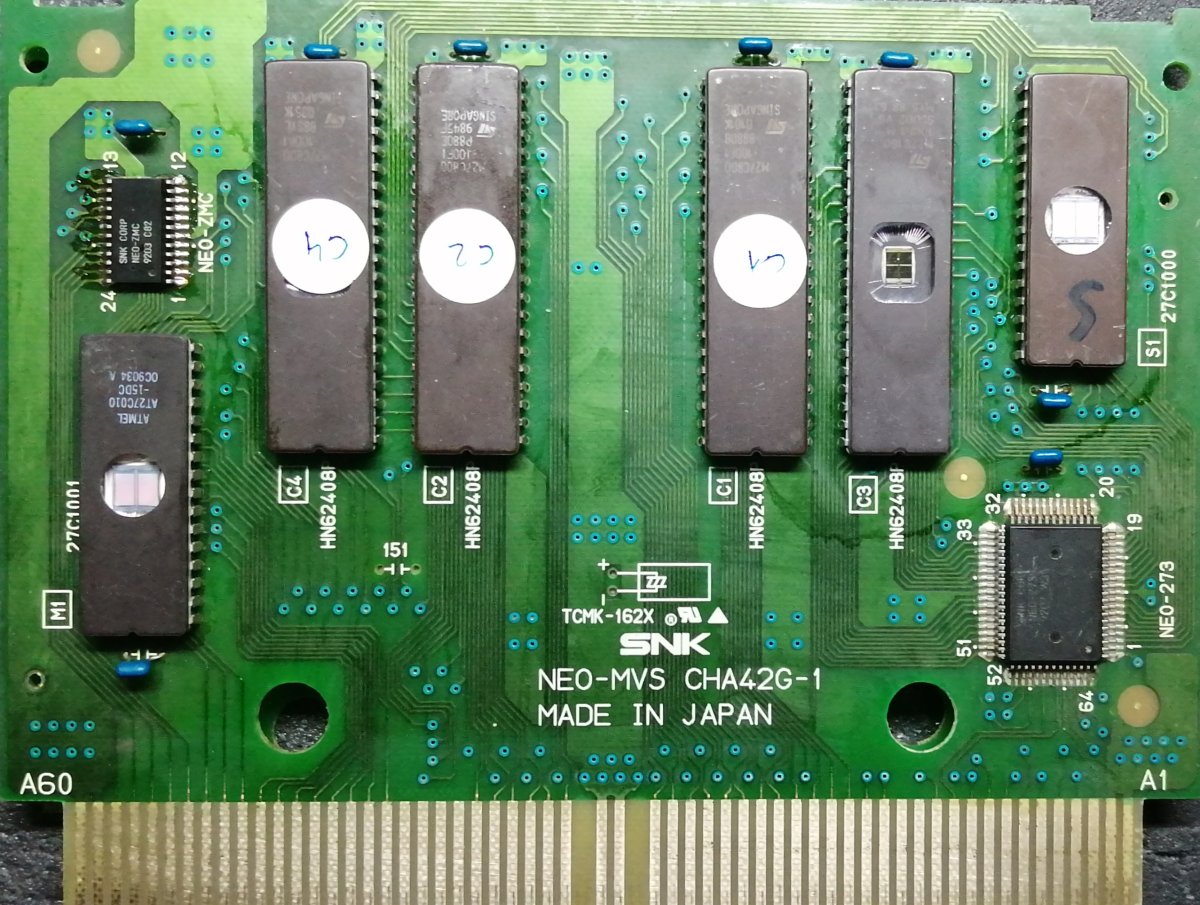

Hi, I'm converting a bootleg Puzzle Bubble in a King of the Monsters. The 2 pcbs are 42G-1 and I used the mvs-scans as template. I used the roms following the basic principle, M1 - 27c010 | S1 27c301 or non jedec 27c1000 or 27c1001... | 27c400 for P1 and 27c1024 for P2 | 27c800 for C-Roms | 27c800 for V1 and because I didn't have more, a 27c160 for V2.
The game works, the music kind of works, but the sound effects are only noise. The puzzle bobble was working with good sound before the conversion, I removed the V roms and verified them without find any error. The V2 was burn doubled (v2+v2) I did it right? I replaced the zmc with any changes, I don't have a spare pcm to try, but is a little strange if it was working prior the conversion.
Any ideas? Thanks!
