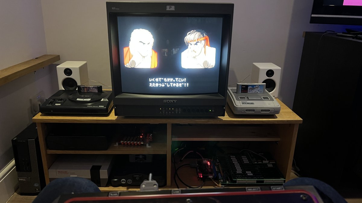

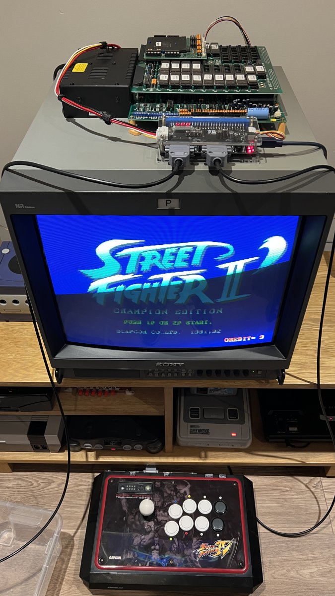

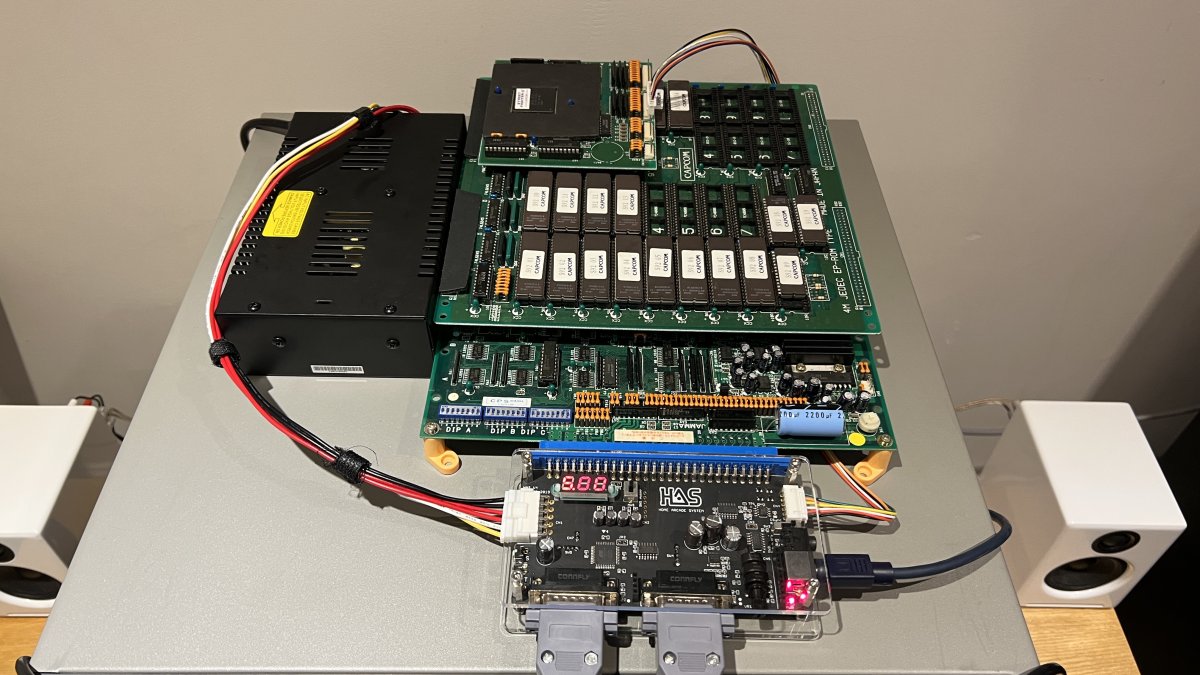

Hope it’s ok to ask this here, but would anyone know if it’s possible to change the language from Japanese to English on a Japanese SF2CE CPS1 board?
After defeating an opponent, the cut scenes are in Japanese, would be cool if could swap to English!
Change via extensive ROM hacking/editing? Yes, its a ton of work but totally possible.
Change via USA conversion? Yes, you'll need to burn the USA set and install it (all versions of CE should use B21 C-board).
Change via something super easy, like flipping a DIP switch? No.
Understood! Thank you. How about swapping some Rom chips flashed with the USA version? I have an eeprom flasher. Apologies as no doubt answered elsewhere. 😬🙌
