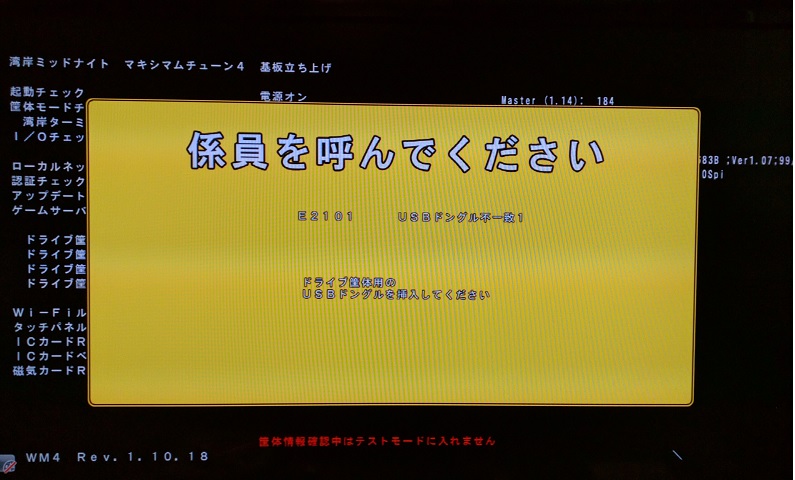

I picked this up on YAJ, was labeled as junk and unconfirmed start but I got excited and got it anyways. It arrived today and booted up to cool warning noises and the below note.
USB dongle doesn't match drive fail. The dongle does say it is WM4, and so does the HDD..hmmm.
Anyway a bit dissapointed but at least the ES1 appears to work. Now it will be just hunting for a drive/usb dongle combo, since the ones I have are mismatched and I believe the drive won't be able to be used with another dongle from what I have read. Not sure the MBR 0s trick would help here, but any suggestions or just save this in hopes of getting a good usb/hdd combo or a multi? lol

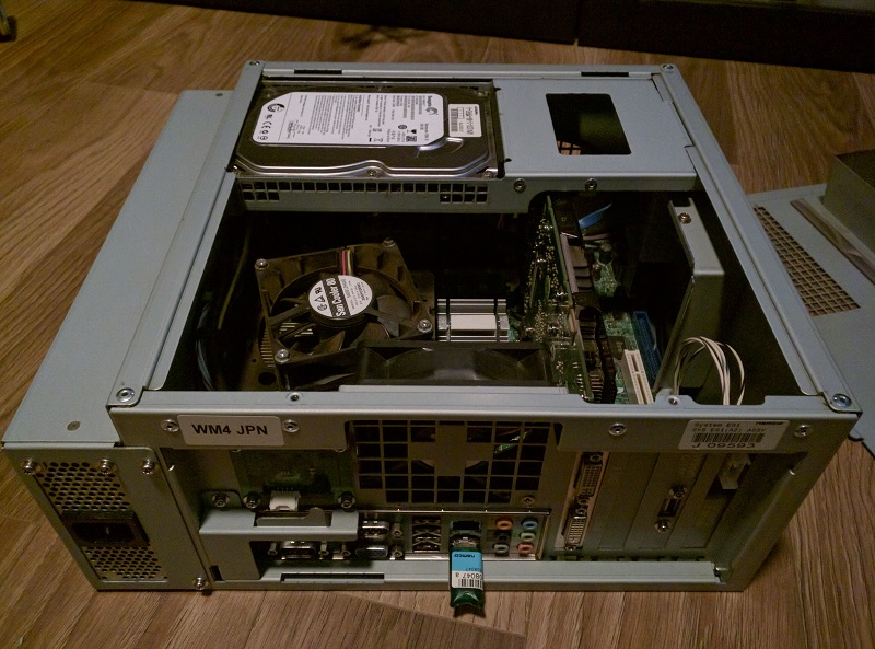

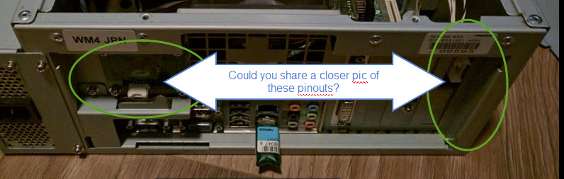

If you could, would you be able to take screenshots of the PCB that is right below the 'WMMT4 JPN' label? I need to confirm the pinouts as well as the one on the right (the last PCI slot).

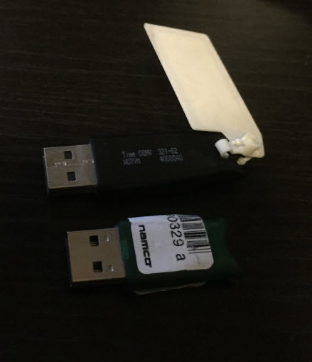

Also, how do you know the USB/HDD combo doesn't match? From what I remember, WMMT4 is supposed to use two dongles (based on that warning message it is saying to insert the specified dongle). If you unplug the dongle you have in now, check to see if the error code changes. I could be wrong but it should come with dongles like this (see my attachment)

Ahhhhh it needs two dongles?! Lol dmnit. Oh well add it to the learning curve haha. I used Google translate on the error and it came up with the following:
Please de-click call attendant
USB dongle does not match
Please insert the USB dongle for the drive enclosure
I guess now you said it requires two that makes more sense.
Sure I can take some pics tomorrow when I clean it out..came with some baby Japanese spiders yay. The shipping on buyee I feel has gone up and the exchange rate sucks now. I had other stuff to ship with it but I did look at just shipping the ES1. $120 EMS, $140 air, $60 Sea

When I saw a WMMT3DX+ machine, the 2 dongles were plugged in. I was curious and unplugged one of them and the error was similar to what you are getting. On WMMT3DX+ the error was more obvious.
Hmm you may be correct. Below the error screen it lists WM4 Revision 1.10.18, so definitely not a base install. Even if I were to find a second dongle do you think both are tied to the HDD?
It's more so that the HDD is tied to a specific dongle set. I'll double check my opinion but the dongle is a one way security check. Basically, HDD checks the dongle is plugged in, verifies its the correct one with the HASP algo that matches what is stored on the HDD. You should be able to bypass the USB dongle altogether and modify one of the game files on the HDD so it doesn't even look for that dongle. (ie. dongle free WMMT4)

The pics were mainly to give me some insight on if the ES1 machine can be plugged in to a N2 cab or even Chihiro based cab. I think the answer is sort of.
I see 3 ports:
JVS (obviously standard)
Card reader port (is this really the card reader port?) <= I'm wondering if this is for steering since I see 4 pins.
Serial 3 Card Reader (IF) (What is this used for?)
Anywho, in your 'Card reader port' pic, could you take a pic of the backside as well? Is it connected to some sort of PCI card inside?
I mixed up the links when I was pasting. Fixed it ugh sorry long day. Anyways here are the pics of this "thing" lol
Plugged in
Top four pin goes directly to JVS input on outside. Left side long connector, motherboard header (power, leds, reset, etc) AND motherboard COM3. Bottom Connector goes to PSU.
Clear view unplugged
Also the Card IF reader port goes directly to COM4 on the motherboard
Thanks for sharing!
So it seems similar to SEGAs setup.
COM3 might be used for Steering/FFB
COM4 might be used for Card Reader
