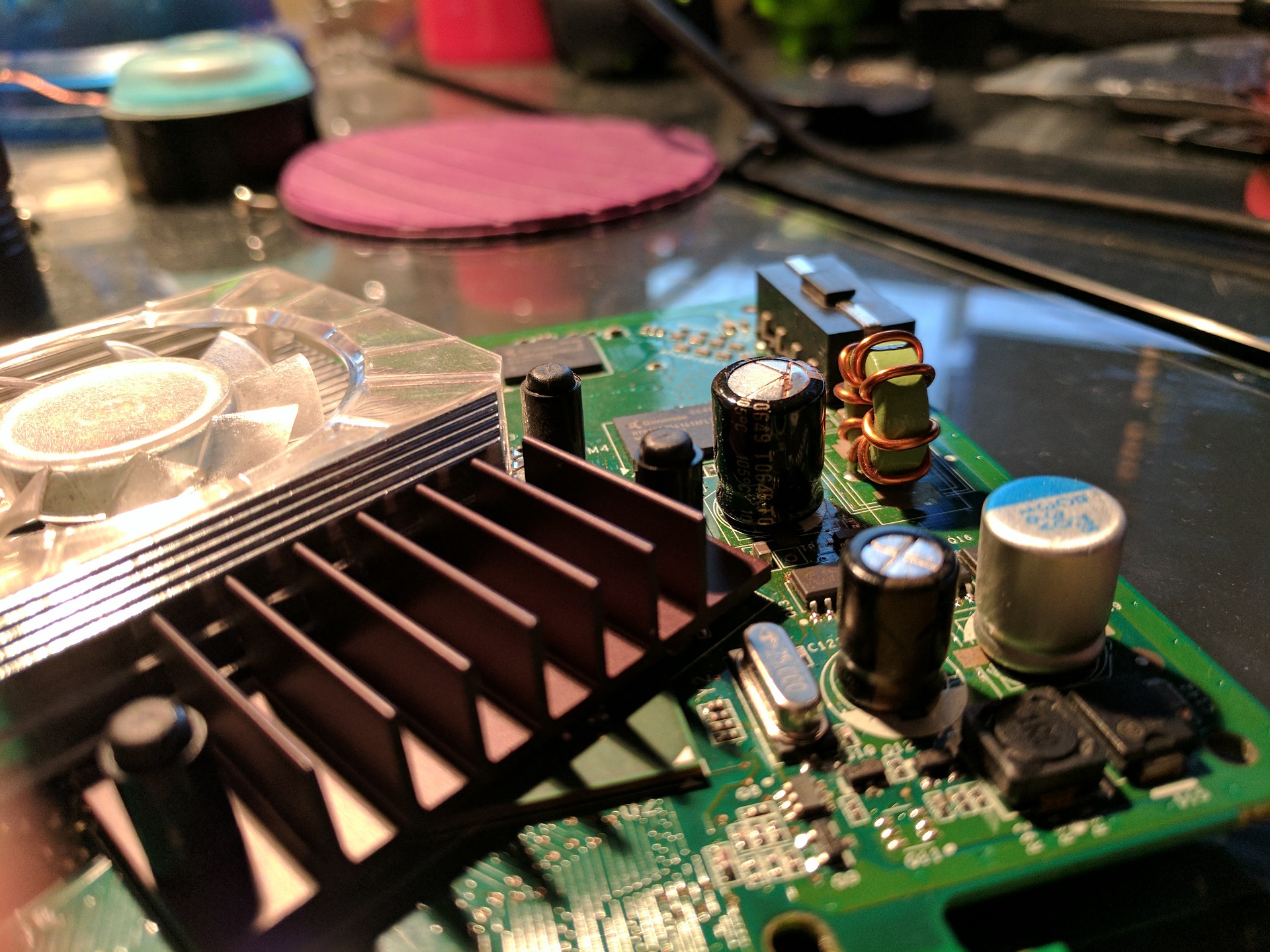

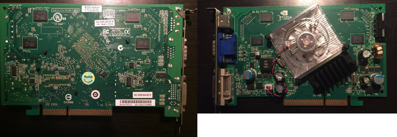

on the screen weirdly and then shut down. After turning it off it only turns back on to a black screen. So I first reseated the RAM and Video Card..nothing different. Pulled the video card out and looks like (to me) one capacitor has started to leak. Normally I thought when these start to die they still display garbage on the screen, but since it boots to a black screen or sometimes no VGA output I am guessing this video card is totally dead...or there is another problem.
Do you guys think a capacitor replacement might cure this? I really don't know enough about video cards or the N2 to know if this is the only problem. It doesn't seem like it continues to boot and no sound plays (could be attract sound off).
I thought there might be a way of getting a new video card and flashing the firmware like the type x2 but I have not seen anything available or completely missed it.
