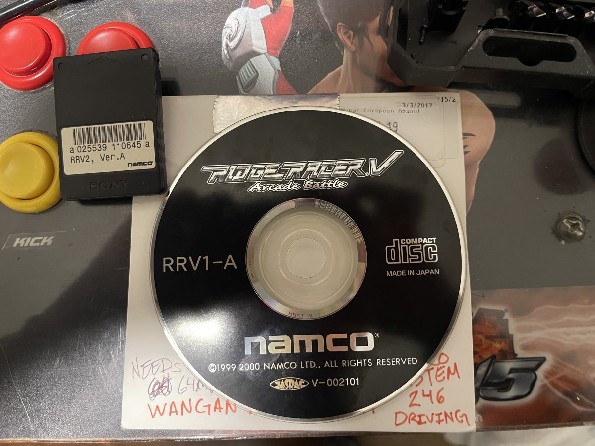

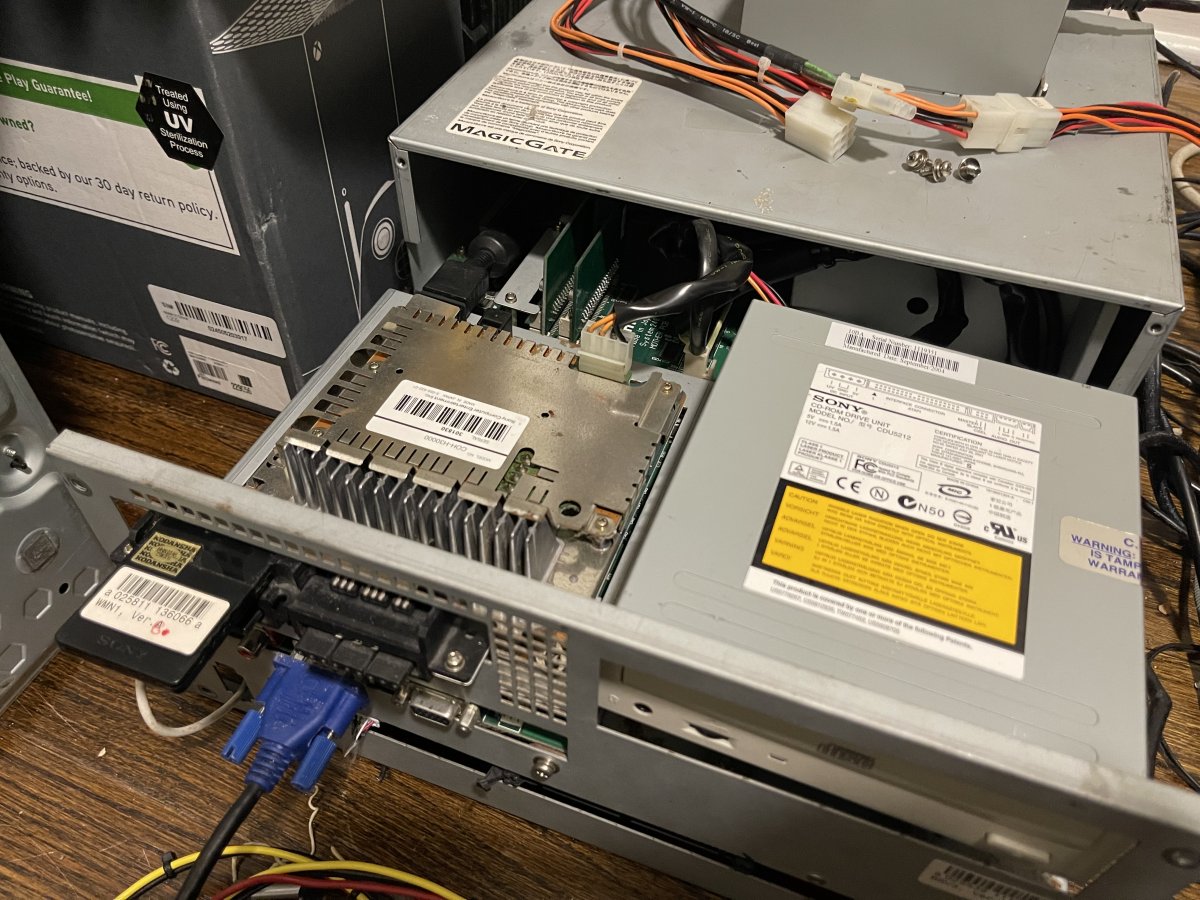

Namco V257 STR PCB is a PCB that can be connected to the 246(Driving) chassis via its proprietary front cable port to provide normal driving game and force-feedback functionality. Game that supper this PCB may verify that the force feedback motor is powered by performing a power-on test that checks the wheel potentiometer value while turing the wheel via force feedback. If this check fails, the game may not boot ( Ridge Racer V and Wangan Midnight).
Just wondering is there any solutions around this?
Told it cant be done
I beg to differ. with today mods and the absolute genius of the arcade scene, surely in 2022 we can play these badass racing games on a 246.
