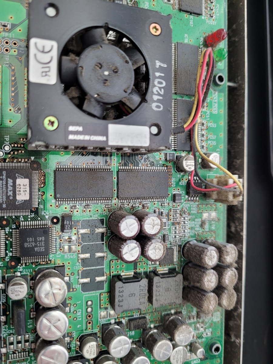

I recently lucked into some cheap Naomi 2 hardware and I'd like to get this fully restored with either a CF or netboot setup. First order of business will be to clean this thing up properly.
Confirmed that the motherboard does fire up and I can load a game but at least one or all of the fans sound terrible. Opened up the case and I can guess as to what might be contributing to this - I'm gonna assume this board has been neglected for a while in a dusty location by its previous owner (got this from a local in Las Vegas, so that's not exactly uncommon).

The case fan can be replaced with any 60x60x15mm 12V fan. The stock fan moves 16cfm and is 32db loud, I believe. I would recommend going with a quieter fan if you intend on using this outside of a cabinet as 32db can be surprisingly loud. Sunon and San Ace make very good industrial strength fans and can be found cheaply on places like DigiKey.
I don’t have recommendations on the CPU fans, unfortunately.
The dust on the PCB can be removed using a soft bristle brush, (make sure it’s anti-static) and a blower. You can used compressed air can but that can get expensive if you use them often. I picked up a camera lens cleaner that works really well. For the spots on the PCB with caked on grime I would recommend 99.9% isopropyl alcohol and cotton swabs.
Thank you @kikaso ! Much appreciated!
I'll start with the case fan and if I need to replace the CPU fans hopefully someone has done this and can shoot me a replacement recommendation. Otherwise guess I'll just measure the existing ones and look for something similar.
