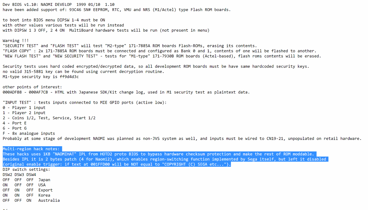

these 2 dumps we have is kind of "hardware testers", for mother boards and ROM boards testing, reprogramming, etc servicing purposes, it seems made mainly for repair workshops.
they are good dumps, but not BIOSes for NAOMI dev. boxes, at the moment we have no NAOMI dev.box BIOS dumps at all.

I don't like drama, so I am going to answer this once because this is seriously getting tiresome and to be honest, I feel like your behavior is borderline toxic.
- About the multibios "research": Seriously it's a 2 bytes change enabling sega functions ANYONE can spot withing minutes using IDA. Using the beta hat/bootstrap using trial and error isn't rocket science either (sega wrote that, you didn't; it's not exactly hard to find either, considering it's used in all "development" bioses and in the HOTD2 prototype bios, putting 2 and 2 together isn't hard.) Don't act as if you suddenly were a messiah and that only you could have figured out all that stuff.
If you didn't bother checking the actual holly hash before trying to use the beta hat to bypass it, well that's not my fault now is it? There aren't millions of possible patches to re-enable the sega code for region switching, did I say I did not reuse your patches (I am assuming p1pkin is you?) I did not; in fact I openly stated I applied the original bootstrap on top of the already existing multi bioses.
The patches themselves are fairly easy to find nonetheless, in fact, I did not want to post these before they were being tested on real hardware, but I here are other (older) versions of the BIOS I made with the exact same multi bios patches (which I had posted on the openjvs discord for testing purposes).
https://mega.nz/file/8011wRYL#XvAMRHD42EDJbghhGAEM1B5mQfErOPxd8qXZNtPP6Zo
As you can see for yourself, the patches are at their proper locations.

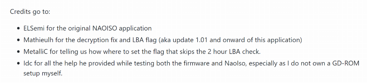

I did not post all this for credits or to compete or anything, if I was in this for any kind of notoriety, I have done much greater achievements than any of this (I daresay easy) stuff, I don't need to be "stealing" whatever you've done, if you feel that way, that's your prerogative, I don't care.
- About the "development" bios:
I didn't own an arcade system less than a month back, so obviously others, such as MetalliC, will know more than me about some (probably most), related arcade development stuff, since they have been been messing with arcade boards for years. How am I to remotely guess that a development bios marked as such and as a good dump isn't "from a development box", and how does that make it not behave like a proper development bios? How can you or anyone else even tell as "no dumps exist". I work with what I have that's dumps, and open documentation.
Finally, I am not saying you aren't helpful, the info about the time bomb flag for instance was genuinely helpful, I in fact credited you for it! I don't shy on giving credits where it's due.
https://github.com/mathieulh/SEGA_DIMM_CD-R
Finally the "DEVELOP" part in the NAOMI BIOS is actually openly documented here https://git.redump.net/mame/plain/src/mame/drivers/naomi.cpp
Can we now please stop the drama? This is pointless, I am not competing here, if you feel so insecure as to believe I am somehow stealing your work/credits/whatever, that's up to you.
it isn't hard to find something if you know what, but at that moment it was not known BIOSes have hidden region-switching feature, so discovering it had involved a lot of analysis, and actually was side effect of whole BIOS research&disassembly, which took quite much of time in general.
this is another story. actually I've checked patched BIOSes, but using Dreamcast, and that was wrong move - as it turned out now, neither of retail NAOMI BIOSes pass the check using Dreamcast. so, I've got negative results, even if patched bioses works fine on NAOMI as we see now :)
