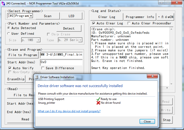

I'm not sure of any other version of the software, I've just used the one in the documentation. I'm more than happy to try it, the logical part of my brain is saying it doesn't make sense as I've been successful in writing 7 simms (when you count the U9 and U10 simms). However, I'm more than happy to try it out to rule out it.
I've also just tried a windows 7 box - same issue (although it did come up with a no driver found for a lunuxg_printer, have nfi it was trying to find a printer, it first showed up as proman hi-speed something)
I've also just tried a laptop with win10 - no go. Also used changed around 4 or 5 different cables all still displaying the same error.
Pins/sockets and pads have all been given a good clean with IPA
If all the other SIMM chips programmed fine, but 5 isn't working - I would guess that particular ULTRASMIMM is faulty.

That's the only thing I can think of, but I just wanted to completely rule everything out just incase it's user error :)
Matt
I agree with Matt. The other SIMMs programmed fine with the same hardware and software so it would seem to be an issue with that particular SIMM. If it doesn’t void the warranty and you’re comfortable with SMD soldering, I recommend reflowing the solder joints on the flash chip.
