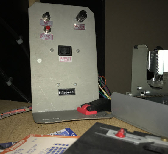

Having just acquired a pair of Maximum Tune cabs, I'm going through the grueling process of disassembling them as much as possible and moving them into my basement. I just got to the point of getting the major parts assembled for one of them and the Chihiro boot sound about gave me a heart attack! I looked in the coin door and found a volume knob... turning it did nothing... because the wires had been ripped from the pot. I wired up a new pot, turned it on - heart attack inducing volume with absolutely no control! I looked at the wiring diagram and apparently this volume knob is only used to adjust the seat speakers. I further research volume controls in the manual and come to find that the intention is for you to control the volume in the game's test menu. This means even if you set the game to the ideal volume, you have to have incredibly loud boot music when turning it on or cycling out of the test menu!

So my challenge is figuring out overall cabinet volume control - preferably in the form of a knob in the coin door.
Audio initially appears to go to a BASS AMP pcb. There are pins on a header for this PCB that have no wires going to them, but I haven't been able to track down any details on this PCB, nor have I found other games that use the same amp in a different configuration. Maximum Tune 1-3 and Mario Kart 1-2 appear to all have it set up the same, with no overall volume control knob.
Any help is appreciated. I'm not very familiar with audio circuits to know what to look for to see if volume control is integrated into the amp, nor am I sure what I can do otherwise to add in volume control, short of replacing the amp with another kind that has volume control.
