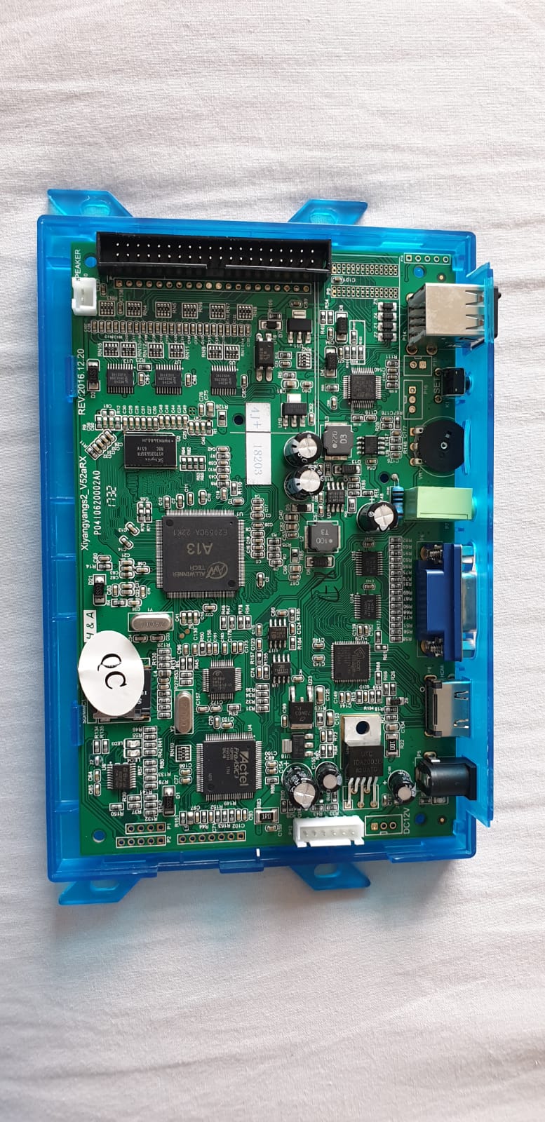

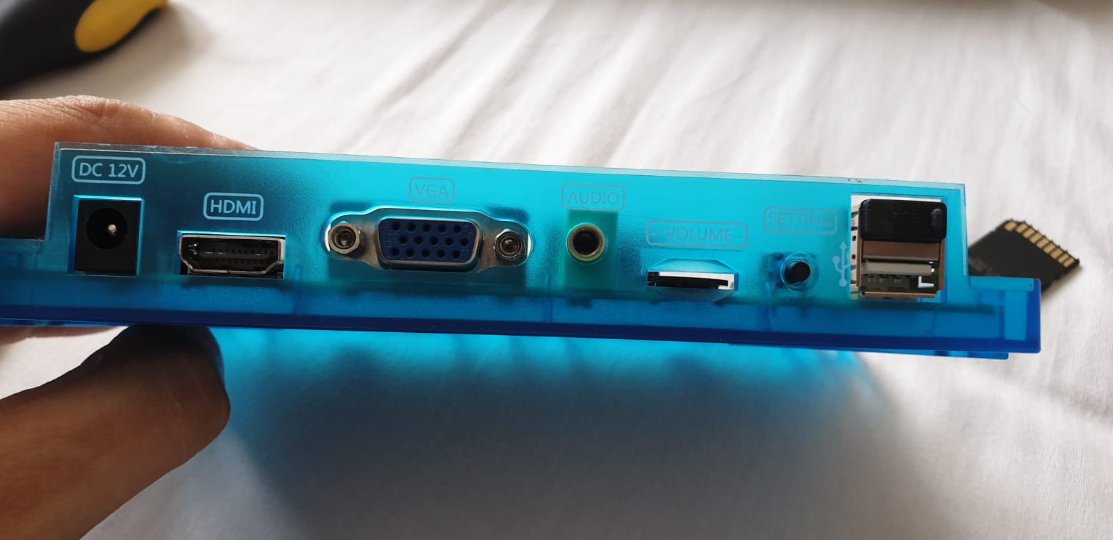

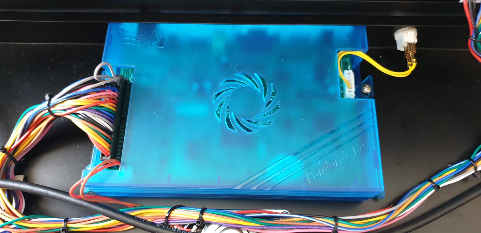

hi there
i have pb4s
which image an i use - how would i back up the linux image etc
finally how do i know if this would work on pb4s
:) sorry for all the question am newbie

no luck with newer PB as the partition of the linux is encrypted and you wont be able to modify/access it.
jus tried one of the images
https://mega.nz/#!R8cUwZxA!squ4jv08Wr4zT-kxxrnmDKQcVuCQewx25IOTByXpvXM
1299.ext.gamelist .img
on pb4s - no luck - the board flashes looking at the memory card. tried this with a 32gb card that may have been the issue not sure
i managed to clone the original with no issue at all - worked with 8gb card.
need to try other images but not sure if am doing this right - am using win32diskimager
tried retropan image - displays sows loading then restarts on pb4s+
Then i tied all the other image in this thread nothing boots up - do i need to copy any keys over from the original SD card to make these images work?
win32writer works and Ether for the image - but the image never boots up on the pandora. I have read people have got other images working am just stuck
