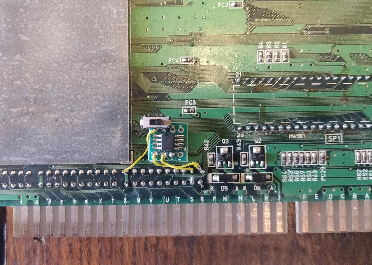

PICKnMIX must be enabled by holding the start button during the splash screen every time the Neo Geo is powered on. The problem I've found is that when using my Neo Geo on my New Net City with @invzims Jammafier it takes too long for the JVS I/O to initialize and I can't press the start button before the splash screen is already past. My solution, as with most things, was to write up a small program on a microcontroller to hold the start button for a couple of seconds at bootup then release it indefinitely. You can manually turn it on or off as needed using a switch.

Here's the prototype.

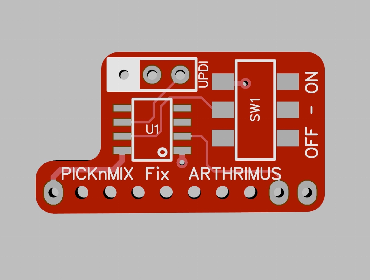

As you can see I'm tapping into the pullup resistor arrays for the button inputs to access the start button, GND, and VCC. I have a NEO-MVH MV1A and I've designed a little PCB that will fit right over the pins of the resistor array for a more elegant solution.
It's specifically set up for the MV1A because that's the only Neo Geo PCB that I have access to, however if someone could check the pinouts of the resistor arrays of other Neo Geo motherboard types I might also be able to accommodate those. I just need to know where P1 Start, VCC and GND pins are on those other motherboard revisions and I can see if the design will fit.

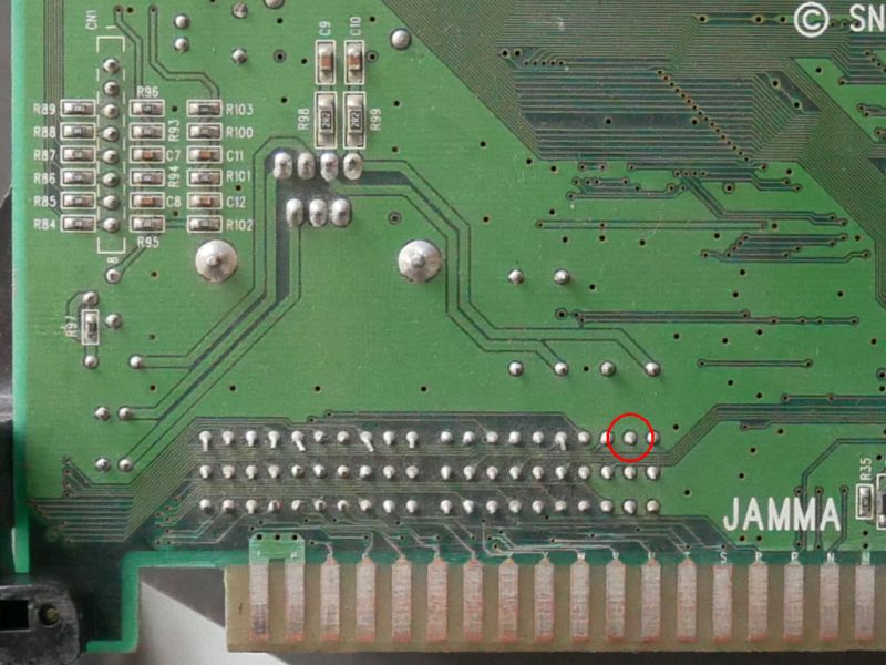

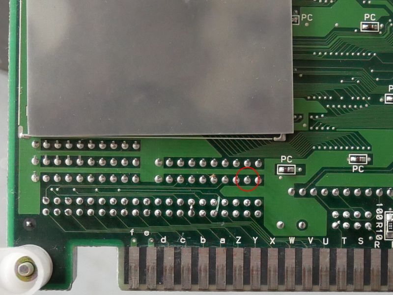

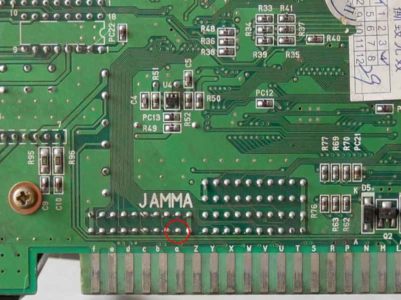

Could someone who has a an MV1B, MV1C and/or MV1FZ and a multimeter do me a favor and probe out the pullup resistor arrays for the button inputs near the JAMMA edge and tell me where P1 start is located on them? Pictures would help a lot as well. I'm trying to find out if this design might work on other MVS revisions besides the MV1A that I have, and if not, how it might be able to be adjusted to accommodate other models. Many thanks.
Thanks a lot @nem based on these photos I think this board will fit all of these models just fine. It looks like on the MV1B and MV1FZ you will need to trim the legs of the other resistor arrays in the area in order for it to fit, but otherwise the pinouts match.
Do you know if it will work with the MV-1 motherboard? To clarify - does this require any soldering or does the PCB simply fits over the resister pins without any actual soldering? How difficult is it to install with the $9.99 version if one isn't that seasoned with soldering or PCB work? I am definitely interested! Thanks.
http://www.hardmvs.fr/html/MV-1.php
It would need to be soldered but it's not a complicated soldering job.

Based on the info provided by @nem I have put together some mockups of what installation on other boards should look like.
MV1B:
It looks like the only special consideration for the MV1B is that the legs on the resistor array above the one we are installing on will need to be trimmed down.
MV1C:
It doesn't look like there will be any issue installing on the MV1C
