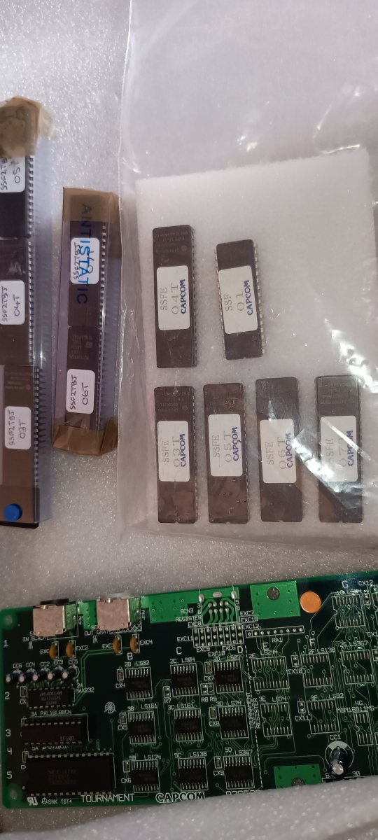

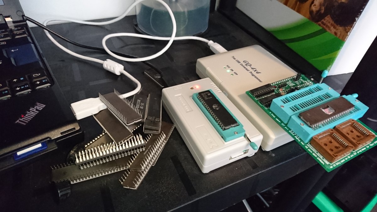

you gotta burn a couple roms keep the originals in the event that you ever want to go back. If you have a burner you can burn them or you can contact a place like hobby roms and they can burn them for you. IF its on battery pick up an open key or a infinikey
Had a quick look at the game. You will need to reprogram all 6 cpu roms because the Japanse and USA versions does not run the same unencrypted code. (Some games share the same code between several regions.)
If you want to run the game encrypted (on battery) it's also possible to reencrypt the USA roms with the Japanese key. If you do that you just need to reburn the 6 cpu roms (Rom 03* to 08*).
