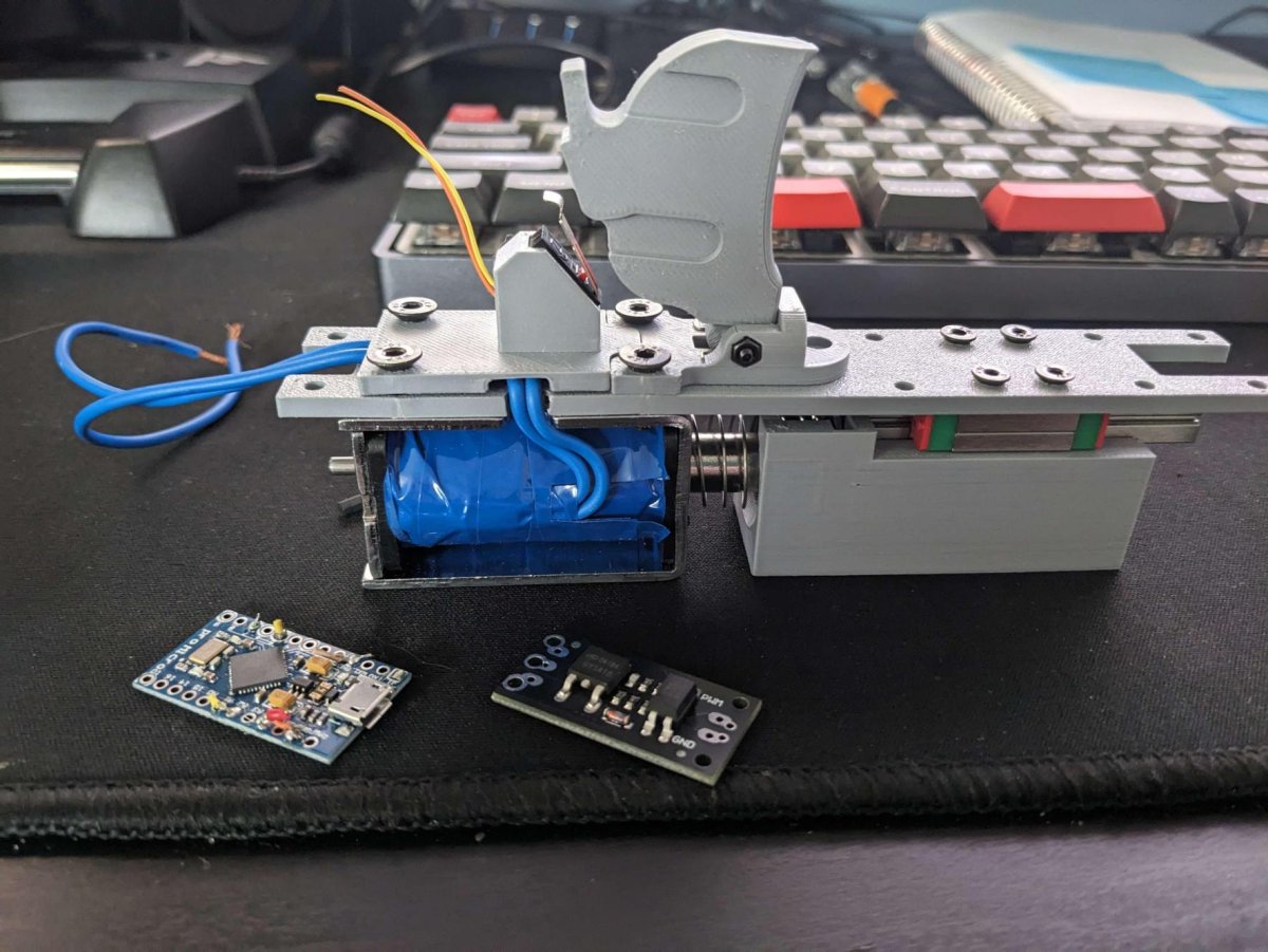

It's a loose approximation of the Namco Time Crisis pistol.
It retains the full slide recoil and the only screws visible will be the two on either side of the slide.
To resolve the buildability concerns a majority of the components are installed onto a central frame that then drops into the shell as a single piece.

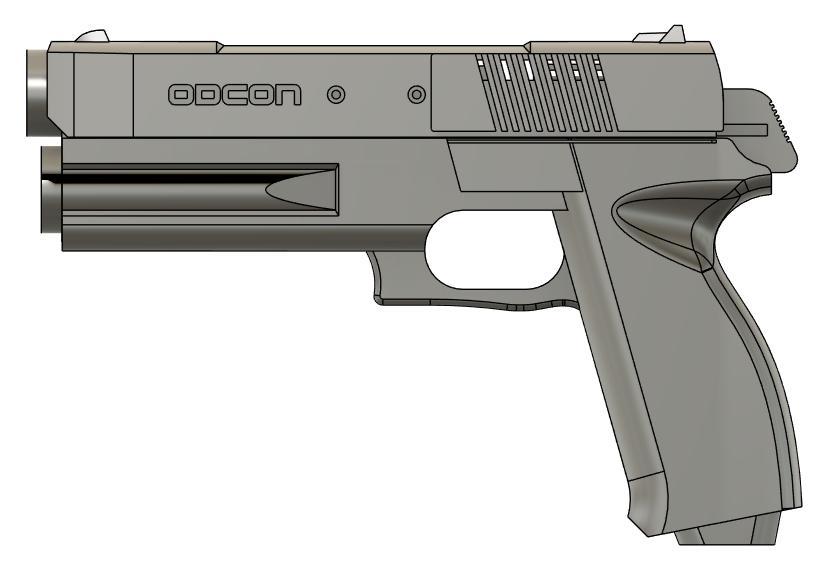

I thought that this would make it easier to design the outer shell around too, that wound up not being the case though.
Designing the shell around this while also keeping the size reasonable has been a little more painful than I anticipated, so maybe this solution is dead after this release. Time will tell.
For reference, once I had settled on the central frame design and spent a month or two ironing that out, it took me another 3 months to trouble shoot and rework the design to have a shell designed that looked good, assembled nicely, and was functionally sound.

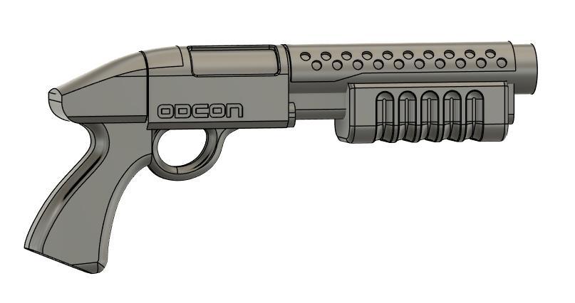

Normally on a good weekend if the ADHD is working in my favor I can knock out a rough gun like this Konami Crypt Killer in about 3-4 hours:
(not something I'm pursuing yet, but I've got a couple designs like this on the back burner)
