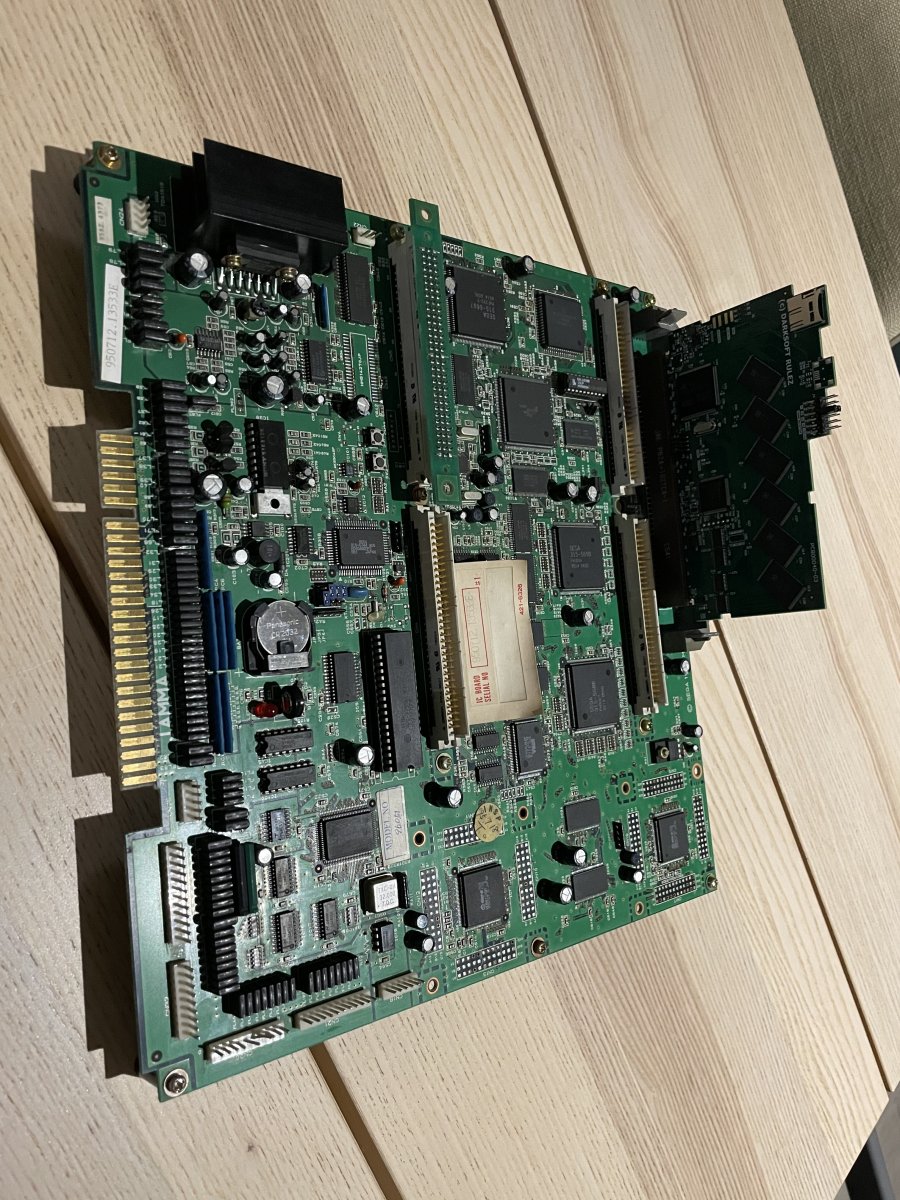

Hi everyone,
Hi! I have some trouble with my darksoft multi stv, some games work ( Like shienryu, colums) and some don’t (like terra diver which Launch but freeze after few seconds, radiant silvergun didn’t boot… first i was thinking that could be my sega stv mobo, but i have 2 mobo ( which perfectly works with my Die hard cartridge… ) and it’s exactly the same issue on both,

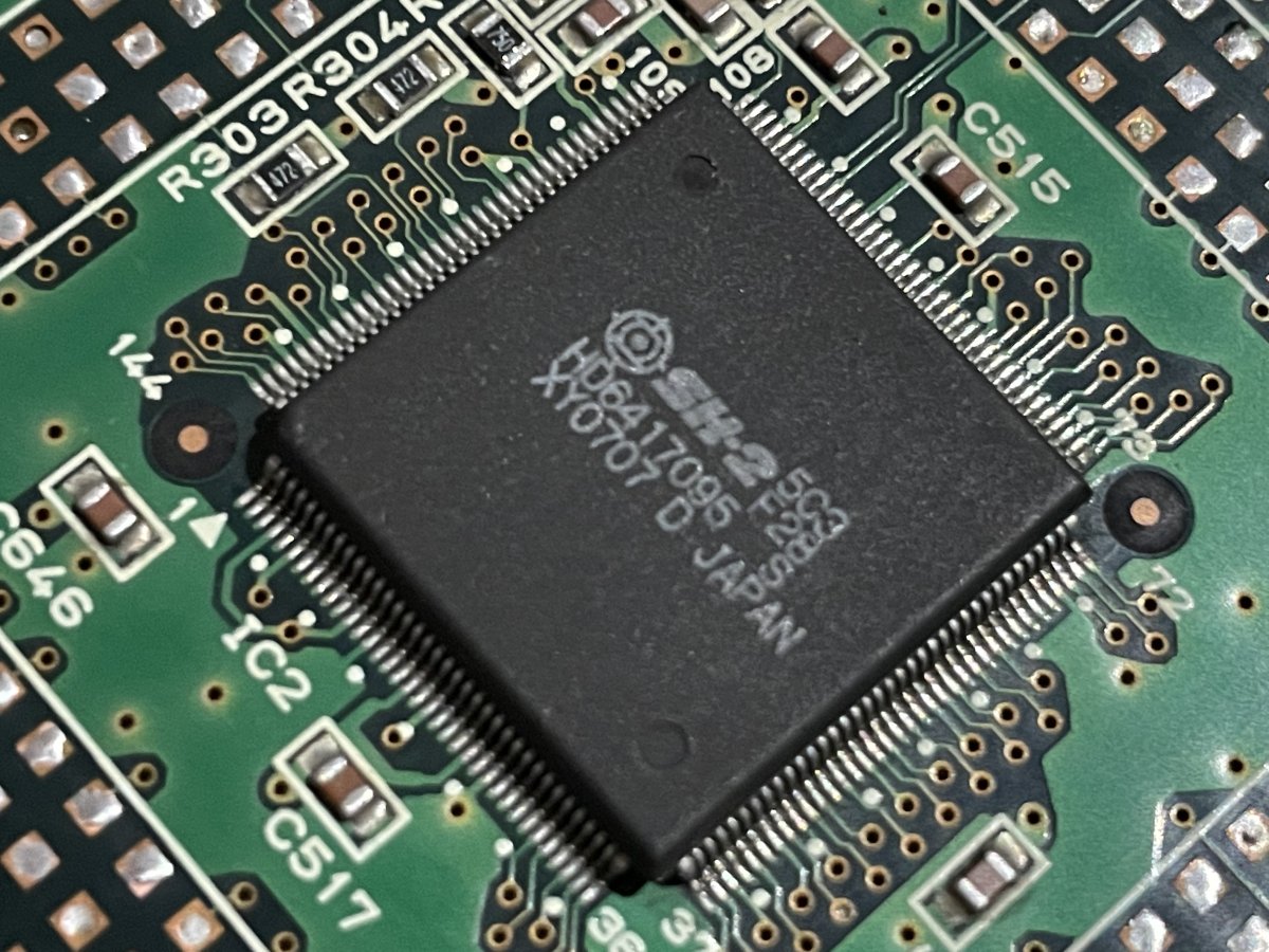

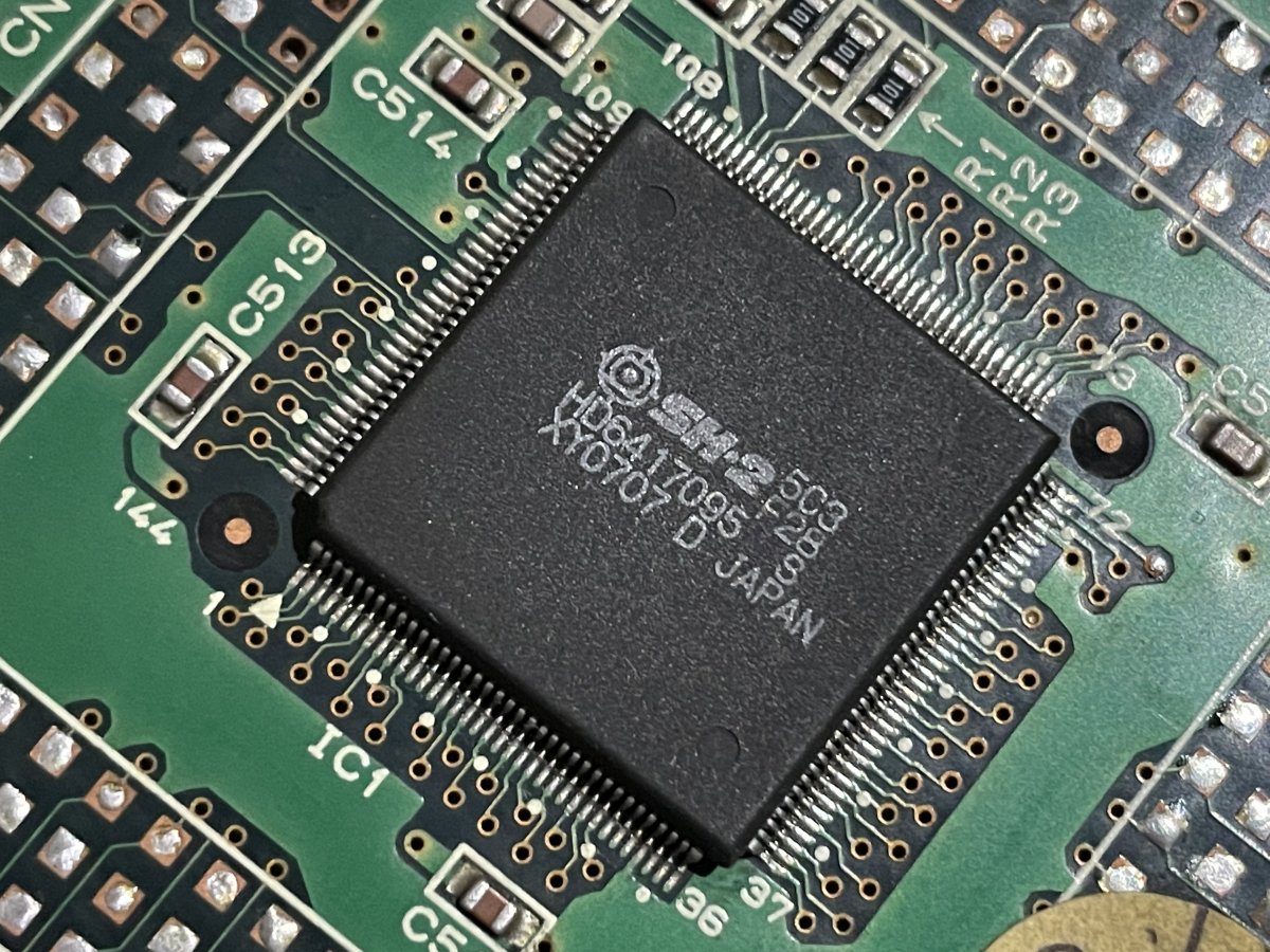

The fact that a motherboard works well with some games doesnt mean that the PCB works well. If you are skilled with the soldeing iron, I would advice to do a rework on the 2xSH2 that each mobo has.

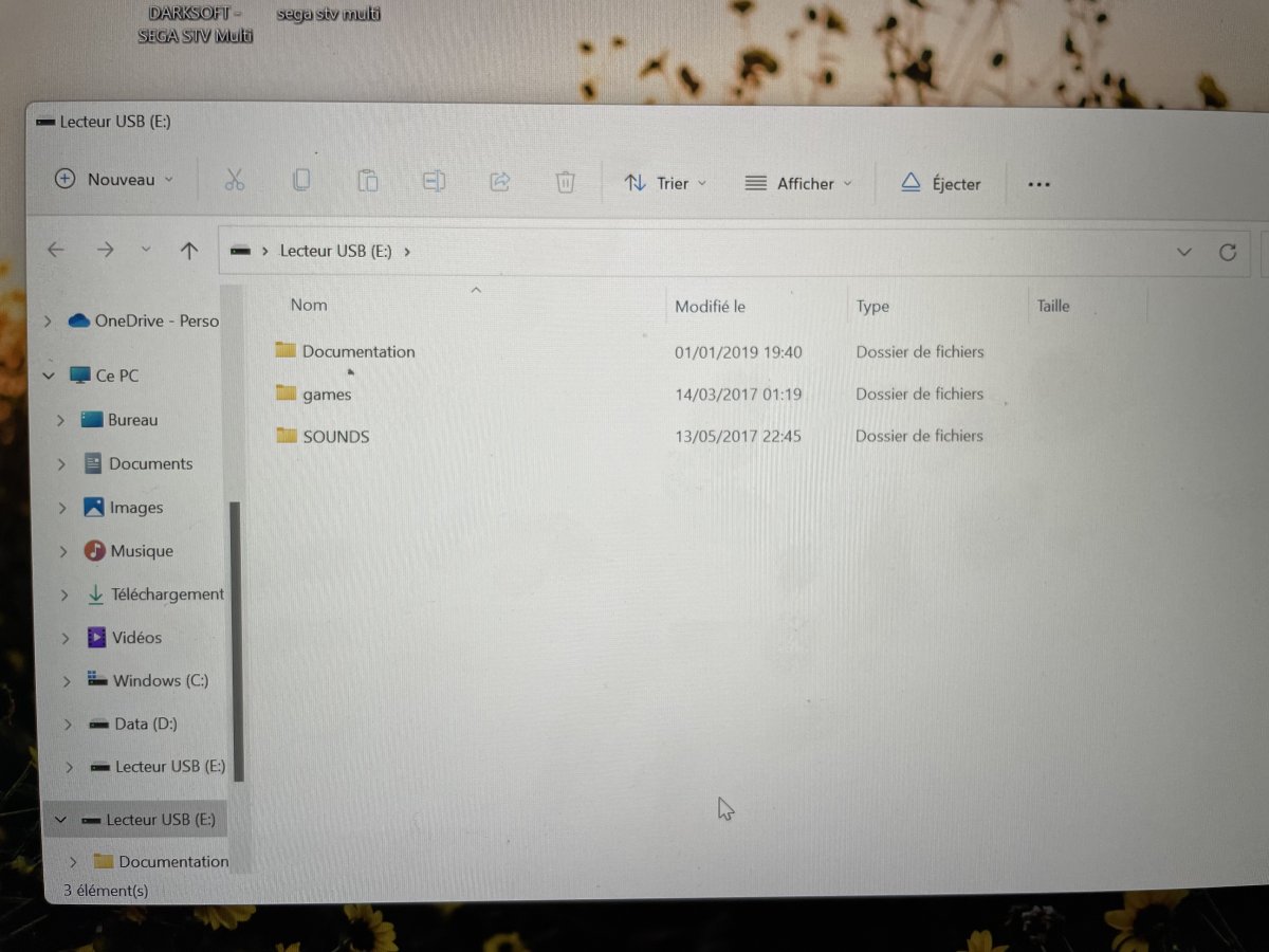

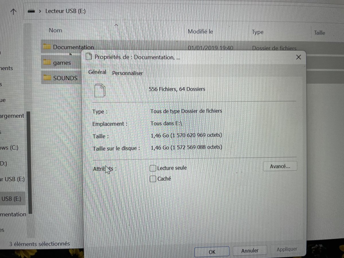

My cart is a micro sd hc 16gb (sandisk) , I was using a PC (windows 11).
Here the pictures on what is on my sd card

Everything looks OK. Are you able to rework those SH2? Do you have someone near you with a 3rd STV mobo?
