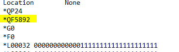

The solution I found is to manually edit the jed file. Two changes are needed.
First you have to modify one of the first lines specifying the number of bits, from 5892 to 5893:
