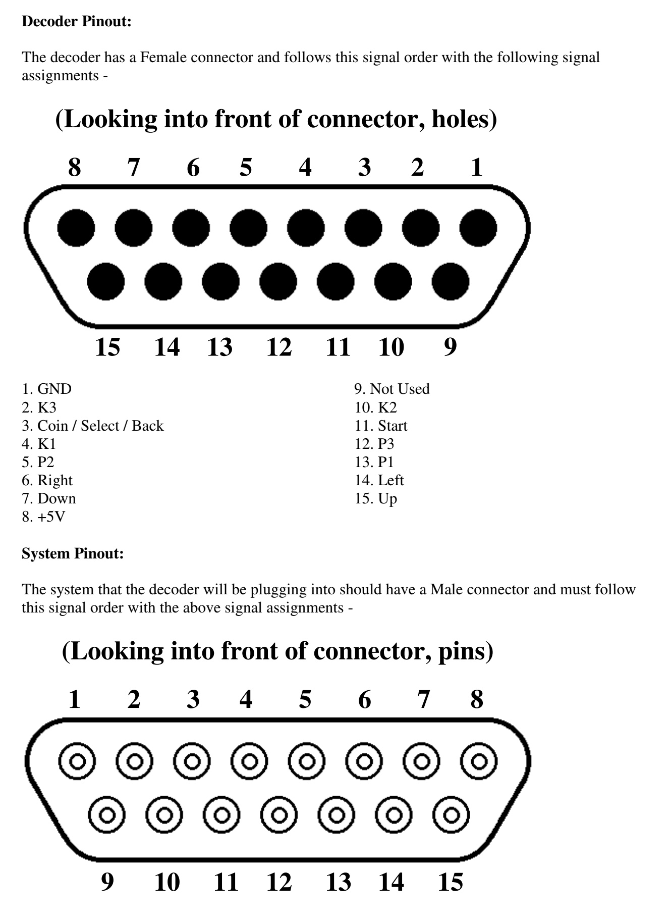

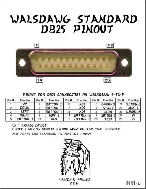

Looking for a regular joystick and buttons controller that has a DB15 connector that will plug directly into the DB15 connector of the S-JIHP and work without any mods. Does one exist?
I tried a Microsoft Sidewinder controller that is DB15 and can't get any buttons to work. Basically, I am struggling to get basic "start" button and player controls to function so the gun and steering wheel can function (basically get the game started). Does an X-arcade work directly into the DB15 of the S-JIHP? Neo Geo controller? Any options would be great.
I bought a break-out DB-15 connector from JasenCustom's thinking I could just wire buttons onto it but still no success. Hoping for some thoughts or a direct pinout of the DB15 connectors on the S-JIHP to try and match up with some general controls. I have the IBM sidewinder but can't get it to "start" the game as a start button.
Would an undamned USB to DB15 adapter work with this port? I think I asked that before, but thought I would check. Then any PS3 or Xbox 360 controller would probably work?
