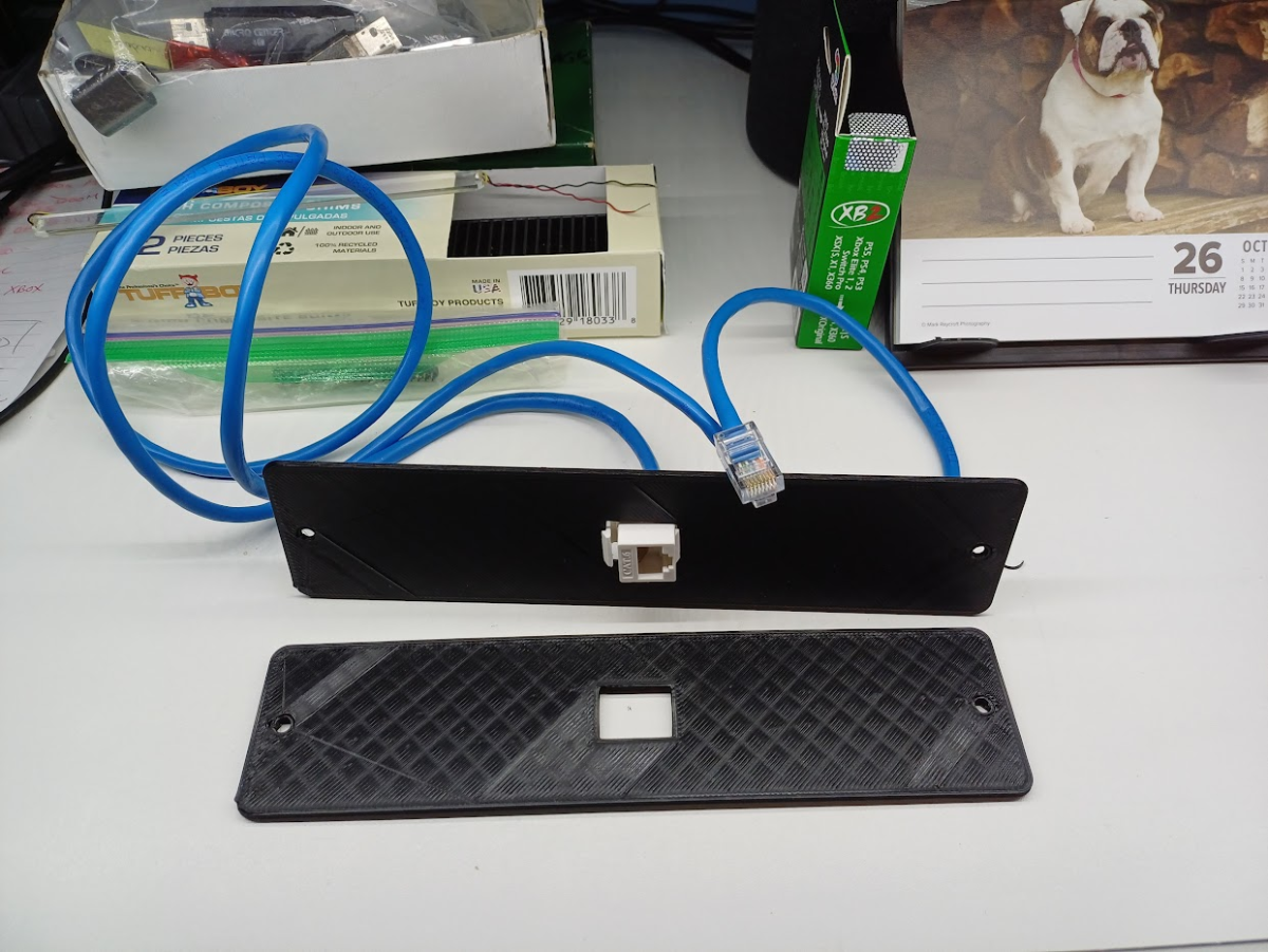

Since I am using the cab for a SEGA NAOMI board with Wipi and wanted optimal transfer speeds, I decided to hardwire the cab with ethernet. Just running a cable through the open hole was pissing me off, so I made some mods to the design by @RandomRetro.

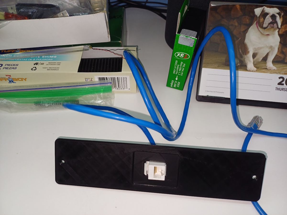

I downloaded the STL from Thingiverse and wiped out all the extraneous lines that STLs create. Dropped the depth to 3mm from the original 4mm and added the hole for ethernet and a hole surround at 2mm depth that allowed the ethernet jack to snap in.
https://www.thingiverse.com/thing:6283979
The first design at 3mm was too thick for the ethernet jack. The second at 2mm felt a little flimsy and I skipped the raft to print it fast and had a bulge on the bottom layer so I had to cut it. In the final design, I opted for 3mm depth and made the jack surround 2mm so it would be solid and still work as intended.
