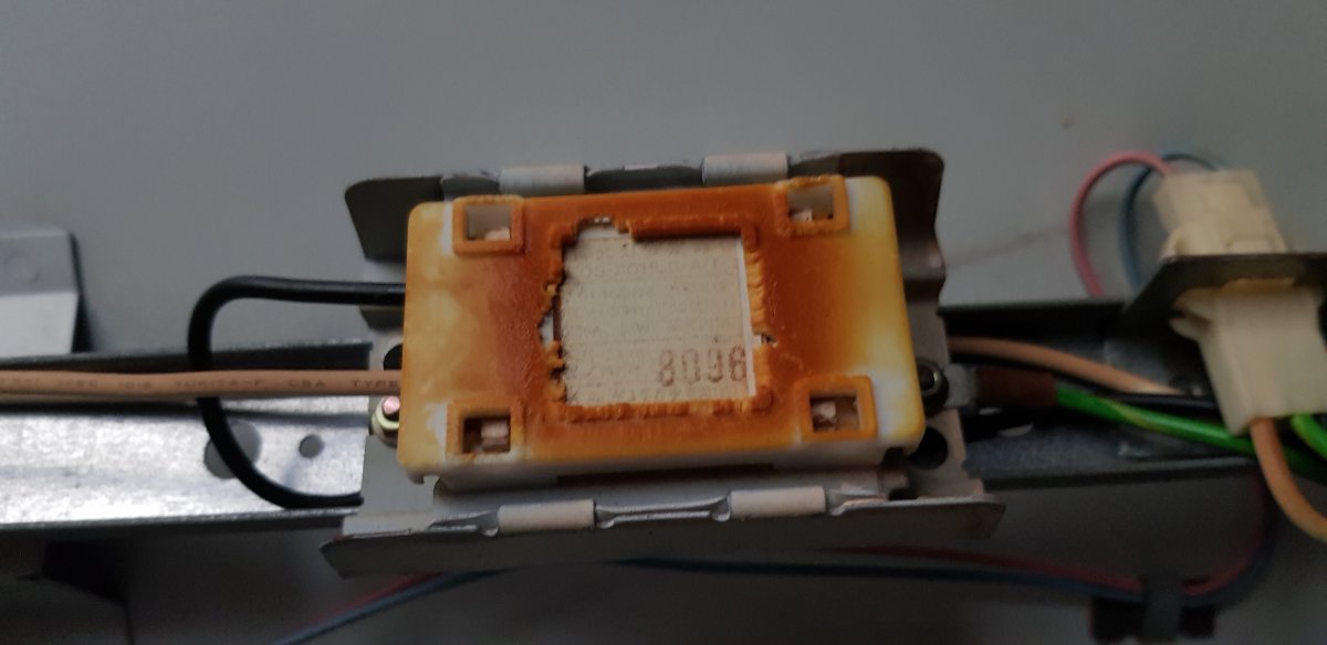

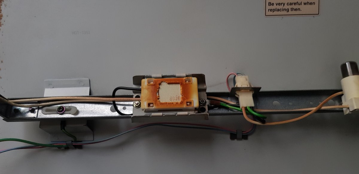

V VictimOfINK Beginner Joined Apr 13, 2023 Messages 7 Reaction score 0 Location Melbourne, AUS Apr 17, 2023 #1 Hi Guys, Would anyone know what this part is called that sits behind the Marquee image at the top of the Blast City? Mines showing heat decay damage and would like to replace the part of possible. Cheers. Attachments 20230417_161609.jpg 61.7 KB · Views: 54 20230417_161614.jpg 61.5 KB · Views: 56
nem Legendary Joined May 29, 2016 Messages 6,828 Reaction score 7,240 Location Finland Apr 17, 2023 #2 It's a ballast. The damaged part is a plastic cover that you can remove.
