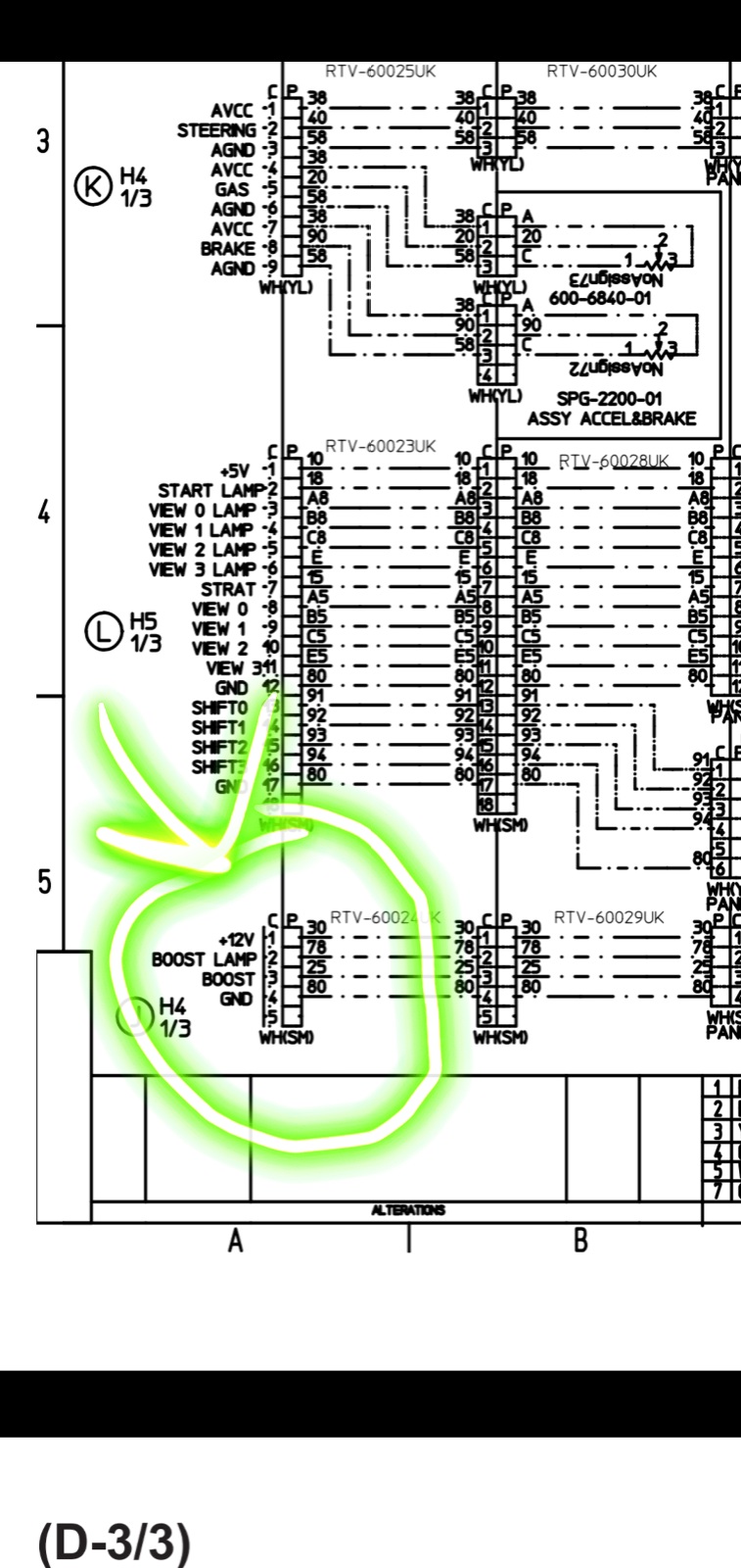

Niclas Enthusiast Joined Feb 19, 2017 Messages 205 Reaction score 92 Location SWEDEN Dec 23, 2018 #1 I canot find boost pin. I the read the wiring diagram But i dont understand where to find it on the I/O board? Attachments 2018-12-23-17-13-07.jpg 296.4 KB · Views: 311
nem Legendary Joined May 29, 2016 Messages 6,820 Reaction score 7,229 Location Finland Dec 23, 2018 #2 According to the schematic found in this manual: http://www.progettosnaps.net/manuals/pdf/segartv.pdf Pin 27 on the 60 pin digital input connector.
