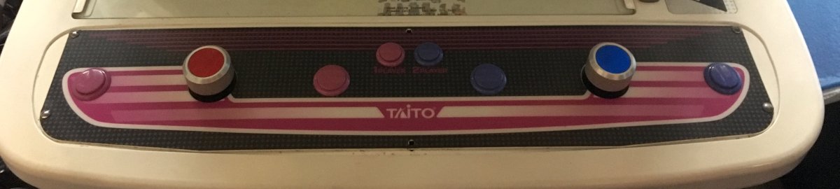

Ok...so for the DEPTH measurements, the AC/NAC's will have about 15mm clearance, the Egret 2/3/AWSD will have about 20-25mm, and the Cute's will have about 20mm clearance.
Also, the Cute will be a touch tight on the length measurement (from front of panel to rear of panel near monitor) with about 5-8mm to spare at the front, and at the back.
The one thing I am noticing, is that because of how shallow these are, and the 100mm width....they will absolutely eat up a width of a 6-button section of a control panel.
So with the forgotten worlds panels, that's obviously fine...but if these were to be cheap enough, to say....make a spinner panel like my attached picture, with a 30mm fire button on each side, you'd have to space everything accordingly.
Shouldn't be an issue on the larger panels....but for the Cute, a forgotten worlds 2p panel SHOULD work (it will be TIGHT and need to be prototyped to be certain).....but a spinner panel could only have 1 fire button per player, not both.
If I can provide any other info, please shout, and I'll try to accomplish that.
It should go without saying, that the Vewlix/Chewlix cabs have all the room in the world, and will fit these fine.
