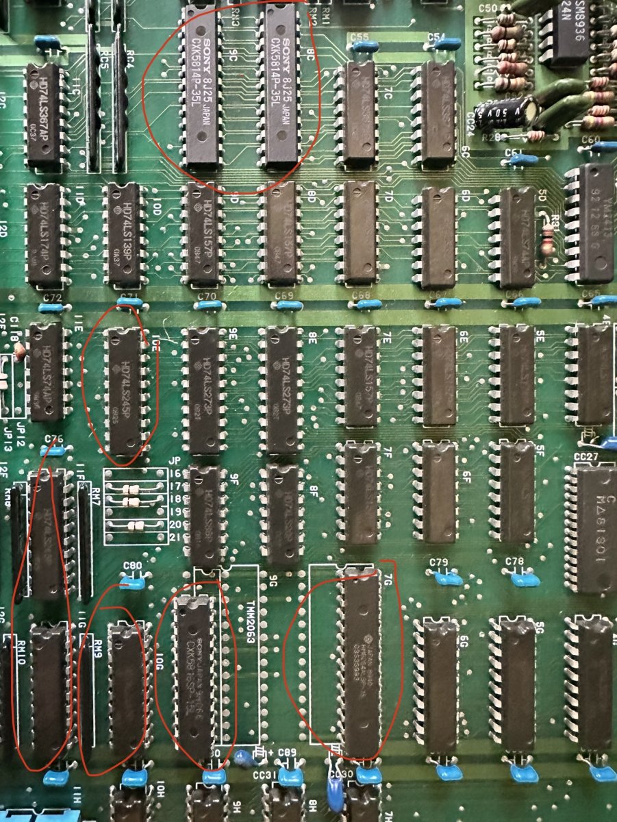

I would like ask for your help and guidance, I have a Super Buster Bros board that I acquired as dead a while ago the previous owner did not knew if there was other problem apart from the dead battery, I desuicided it with Eduardo's method, and now I'm facing a new problem I see CPU activity and some times shows this "0" pattern on screen:

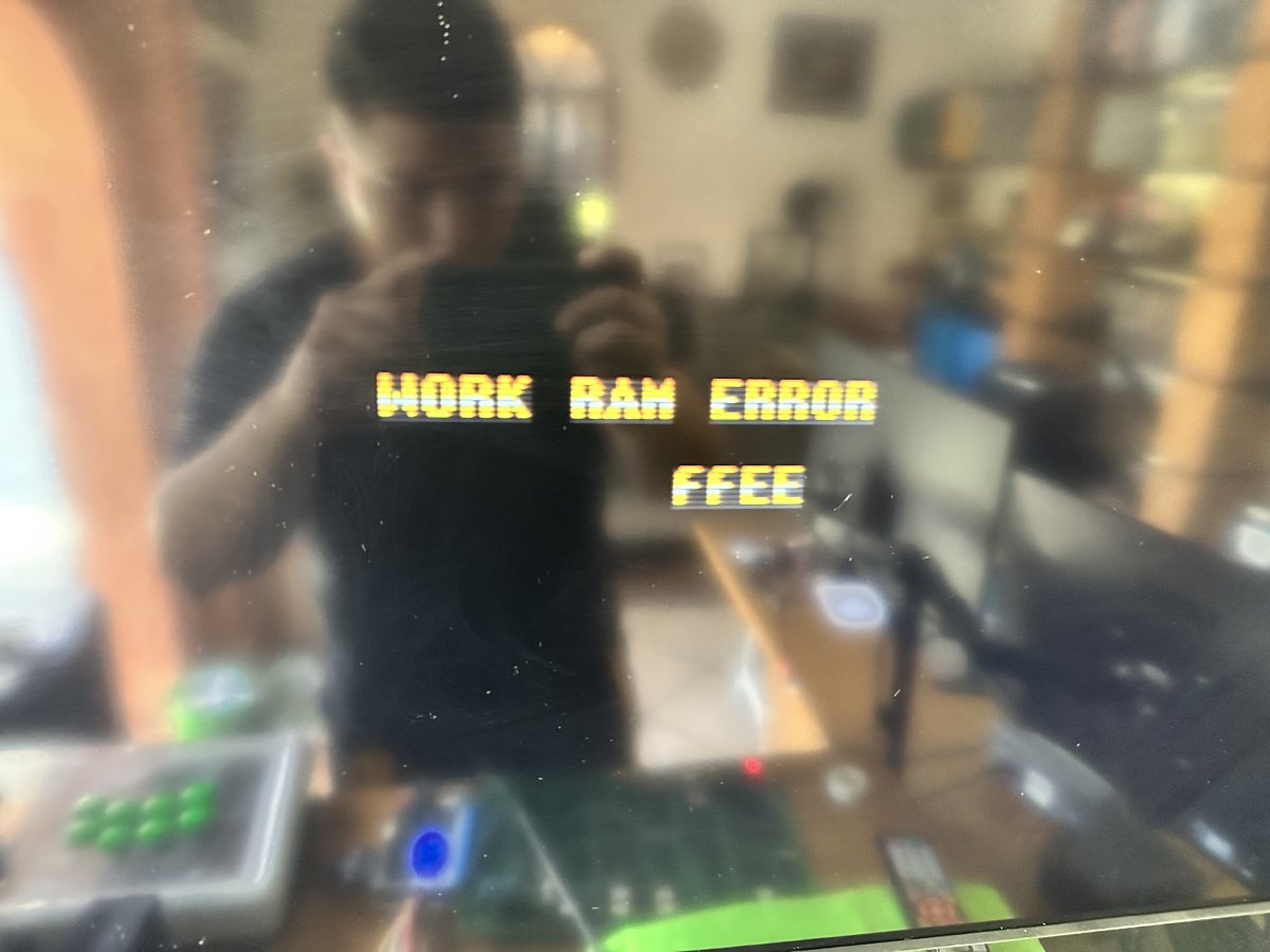

And also sometime shows the "Work Error RAM" message:

While I was checking if there was no broken or corroded pins I noticed that several TTLs (74LS245) and SRAMS (CXK5814P, CXK5816 & HM6264) were getting hot at touch, is there any feasible method to test it without desoldering these chips?
What other actions do you recommend to check or test ??
