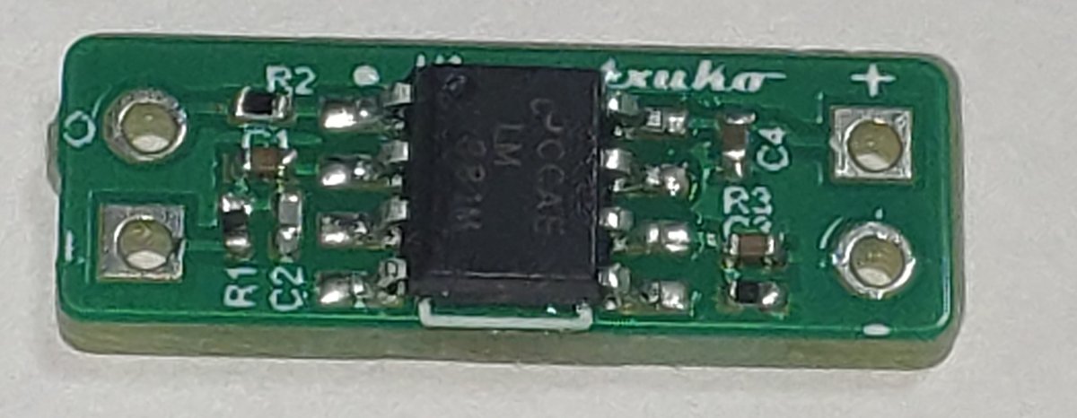

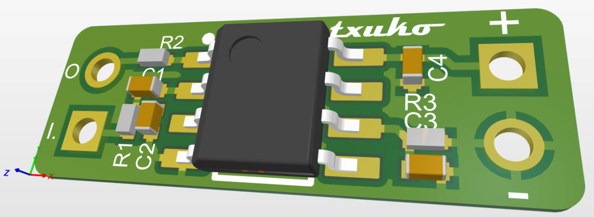

I read somewhere that a Sync cleaner might be helpful to fix this so problem so I made a little PCB using the usual
LM1881 IC
Sent it to manufacture cheaply to the far east and I received last week so decided to put everything together straightaway

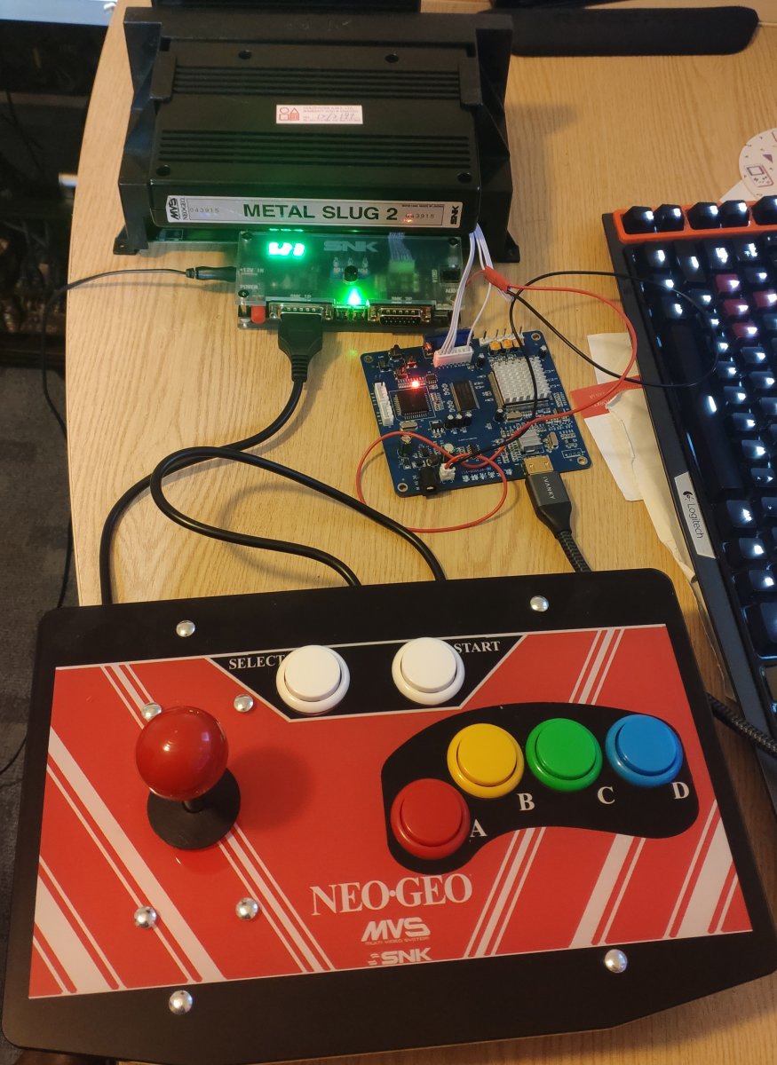

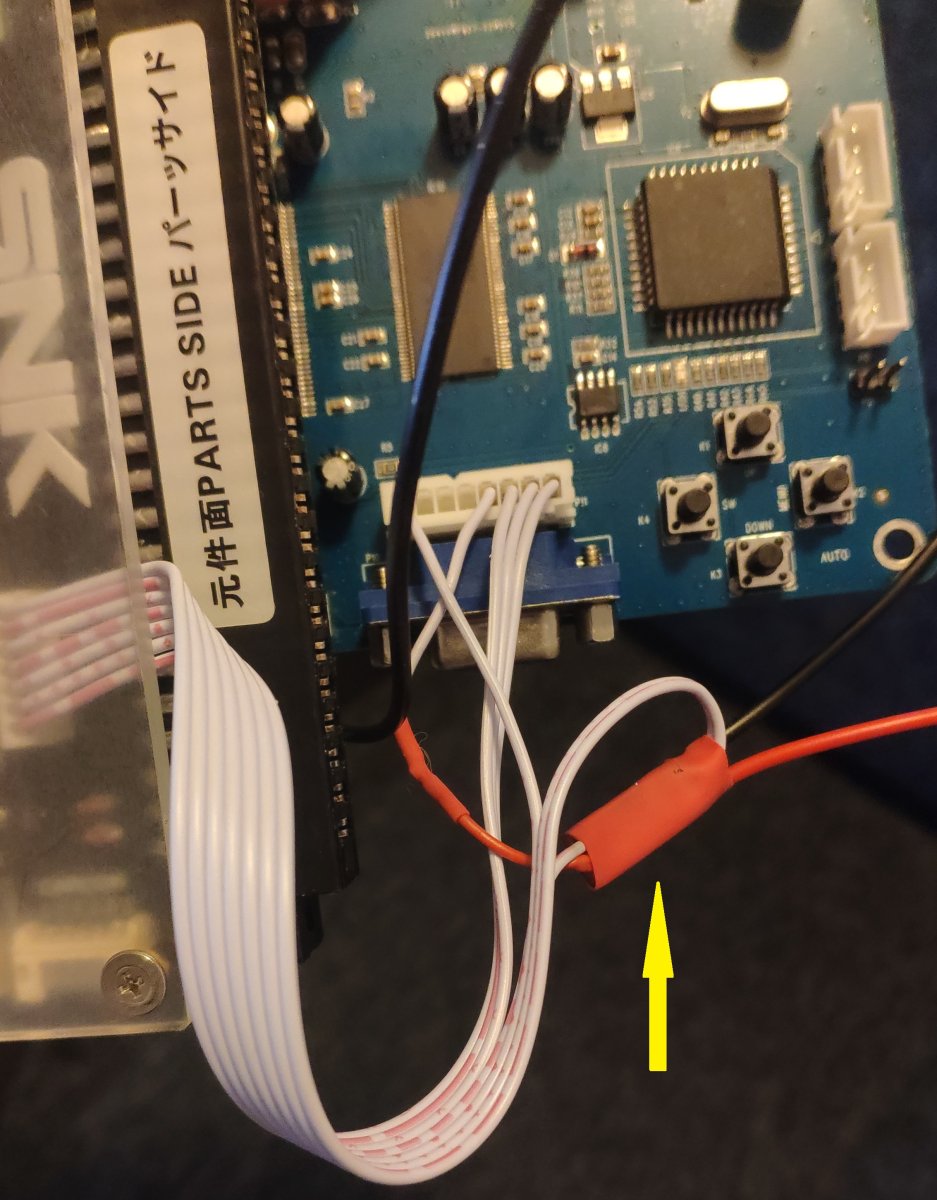

Tested it after the install
And as soon as I pressed scan it picked up and worked almost perfect
Does it make any sense? not sure what type of RGB output I'd expect from these sort of superguns...
