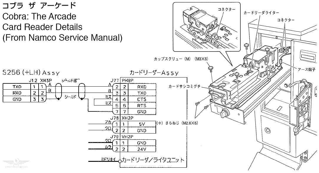

The card reader checks can be bypassed although I HAVE gotten lockups on game over/clear without it present, so YMMV.
Is this possible to play all chapters without connecting the cardreader? How? Can you explain the details please?
And where I can find the whole pages of this Cobra The Arcade Service Manual? Can't do the other connection thing without pinmap.

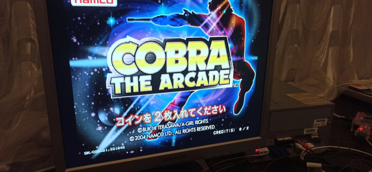

Finally finished setup cobra the arcade. I use OpenJVS because irs and gun are expensive. This game is fun!
