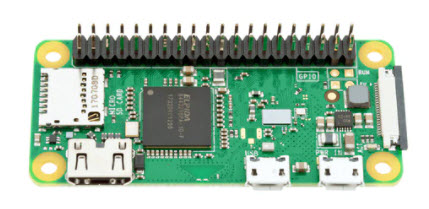

I recommend using a Raspberry Zero W

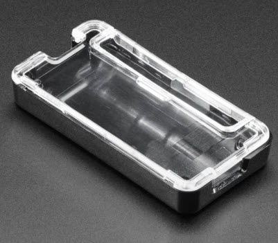

This is the case I am using for it:

NOTE: The pcb connects directly to the 40pin GPIO pins on the RPi - make sure to match up pin 1
Connect a USB to microUSB cable from the multi selector to your RPi in order to power everything from one place
