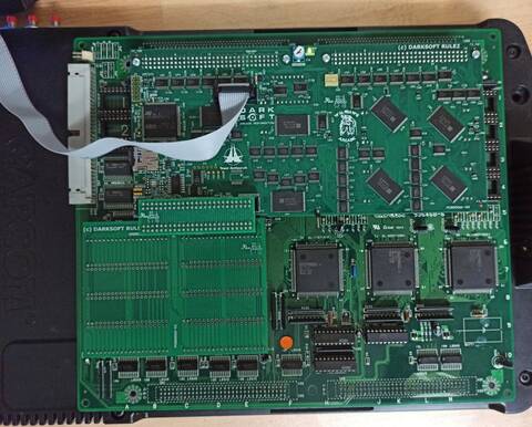

Hey everyone !
I've got a weird issue :

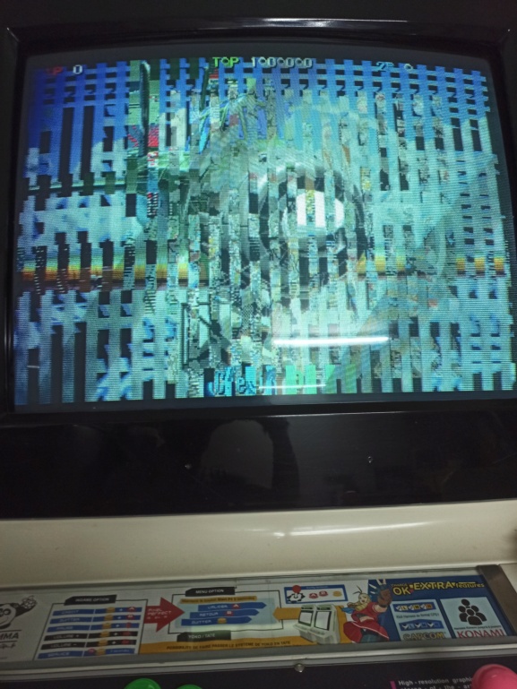

My cps2 darksoft works fine with Street Fighter 2, 2x but when i load an other game and reboot the board, i can see the new game but with some glitches (pics below).
When i reload SF2 it's ok again.
The voltage is tested at 12v,5v.
I was thinking about the EXC5 and shorted it many times without success.
The romset is decrypted (avalaunch and also tested the one from archives.org), tested it with 4 differents sd cards, but the loading process seems ok.
I've seen that we could shorted the capacitor pin by pin, how does it work please?
And do i have to short EXC 1,2 3 ,4 also ?
My kit was bought on savesyourgames in August 2019, i guess it's the version before the actual edition, it worked well before this (i've let it unplayed like 4 or 5 months also, perhaps it has not helped).
I've made a topic on that but perhaps it have not been seen by someone who had this case or an idea about this.

Try reseating your multi kit on the B board and your A and B boards
Thanks for your answer xodaraP.
Reseating consists in reload the firmware by the sd port or disasembling the multi kit and reinstalling it on the B Board ?

Disassembling the multi and reinstalling
I've entirely disassembled and reinstalled it with the same result : SF2 is ok but when i load others games i can play on the background but half the sprite are ok...
Could the PAL G be corrupted ? I've tried with a modified PAL F but it was not better..
Are you lifting a pin the PAL as indicated in the instructions?

The pin on the PAL G is not lifted, only the former PAL F was, do i need also for the PAL G ?
If i need also for G do i just lift it or with a wire to the darksoft also ?
The thing i don't understand is that all was working well before in this configuration.
I don’t think rev 6 would need the PAL jumper.
It’s even more strange that Super SF2 and Turbo both work. Super SF2 uses the no letter PAL and Turbo uses a…. B? I think?

My edition is not a Champion, it's the last before the champion (bought on 08/2019) .
I've tried Alien Vs Predator and Super Puzzle Fighter but they didn't run better than the others.
SSF2X and Turbo are OK, HyperFighting is not.
The strange thing is that we can hear and play at the games between the jaibars...
May be i can reprogram the PAL G or something in this type ?
