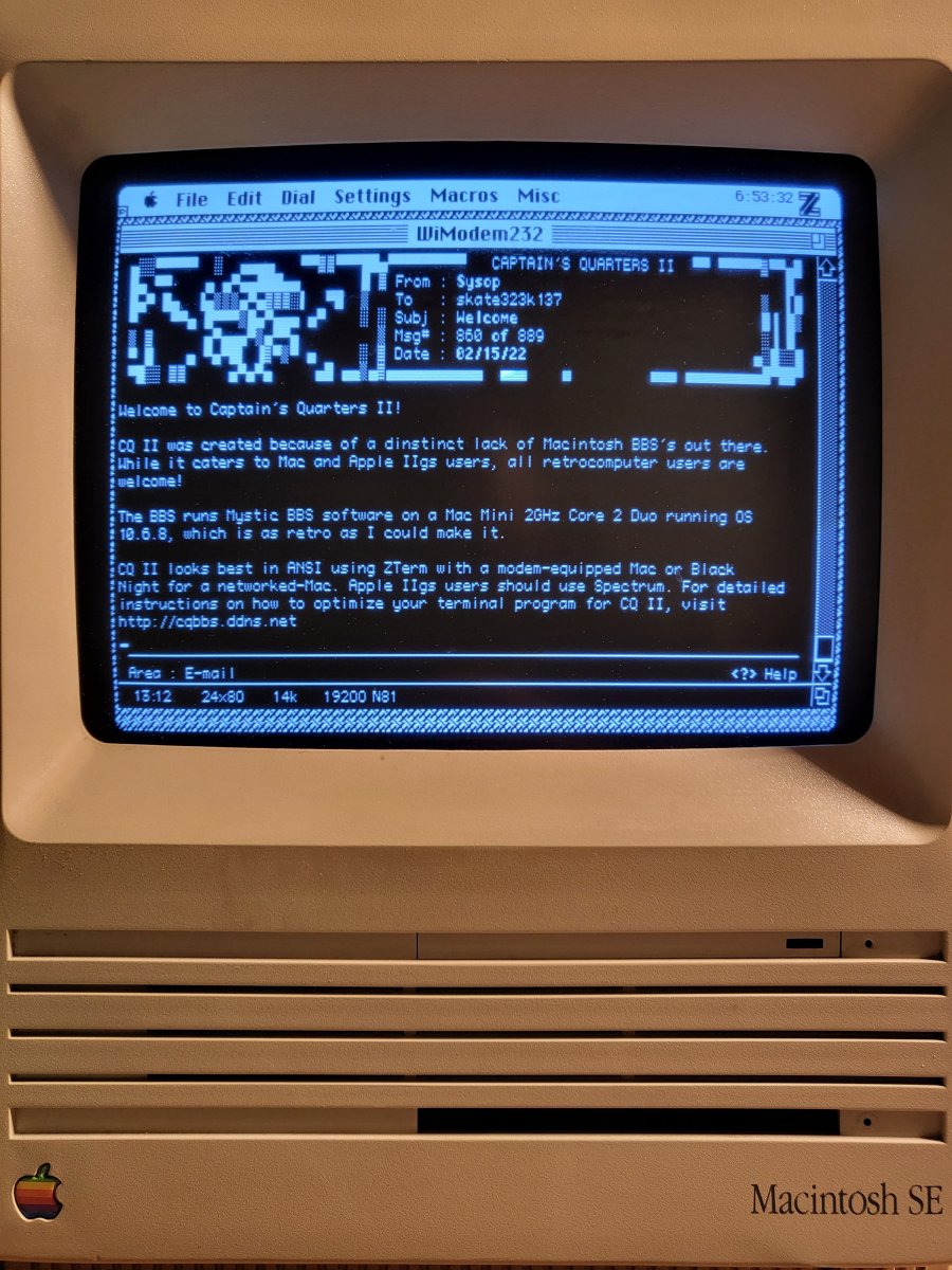

I also recently got a WiModem232, which is a tiny PCB that connects to your wifi, configurable over a serial connection. Nearly any PC with a serial port can use the thing, and it acts as a Hayes compatible modem with extra options. You can "ATDT host.tld:port" right to a BBS.

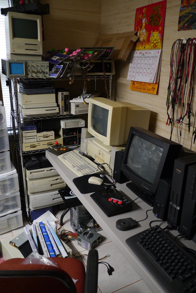

My favorite mac era is the late 68k days, and my Performa 631CD is one of my favorite computers. I grew up with DOS machines at home only (a 286 until 1996) and always lusted after Apple IIs and Macs at friends' houses and at school. When I got a job and a car I would drive around to flea markets and thrift stores and buy and fix up all the computers I was deprived of. This was the late 90s/early 2000s so the pickings were good.
Unfortunately not enough space to have it set up right now, but once I move to a different place it is getting a permanent place with the matching Apple RGB monitor, SCSI Zip drive, etc.
Too many computers
Also love Apple II and keep a IIe permanently set up, on a shelf above is an Imagewriter II to make Print Shop cards and banners and stuff :D

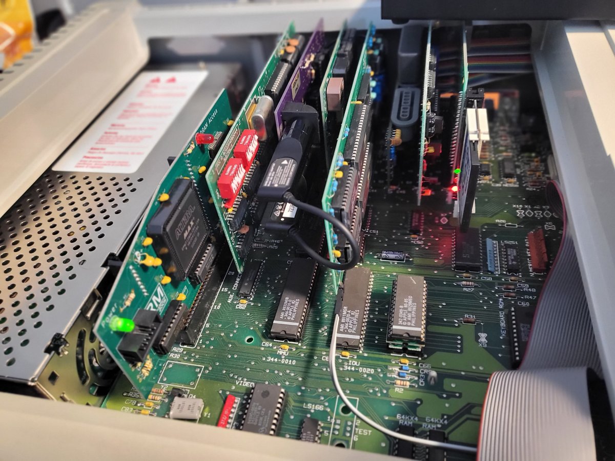

Maxed the IIe out!
L to R:
New PSU (installed inside original metal case)
Ramworks IIII 4MB RAM
Super Serial for modem (wimodem232)
Apple II MIDI (Passport clone)
GZ80/S (runs CP/M)
Mockingboard multivoice sound card
SNES Max Sockets
Disk controller w/FloppyEMU
Reactive MicroDrive Turbo CF drive (cold boots all but instantly)
Lifted EPROM in front of the disk card and installed a no-slot battery backed RTC PBC under it.
Everything works great. The new PSU is an absolute must, even with a recap I would almost certainly exceed the current ratings of the original.
Also I learned the new Rev C floppyEMU can do *two* Apple II 5.25 drives at once on one FloppyEMU. Huge for Ultima, CP/M, and all sorts of other stuff where having 2 disk drives really helps.
