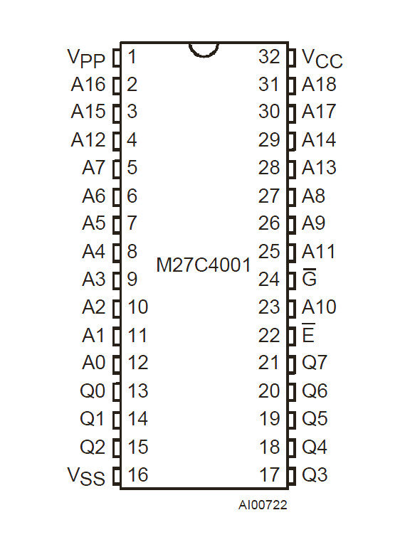

Isn't 27C4000/4002 a 27C4096 equivalent?
MX27c4000 is a 32pin equivalent to 27c020
HN27C4000G is 40pin equivalent to 27c400
27c4001 is a 32pin equivalent to 27c040
27c4002 is a 40pin equivalent to 27c4096
EDIT: Fixed
Double wrong.Macronix MX27C4000 is equivalent to 27C040 (32 pin 4Mbit JEDEC EPROM) but Hitachi HN27C4000G is same of 27C400 so 40 pin 4Mbit EPROM device with MASK ROM pinout.Always best thing to read datasheets before :)

you're right I was confusing 4100 and 4001

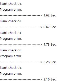

Everything went smooth except programming the Hitachi HN27C4000G. I bought 10 of them through BuyICNow, and all of the 10 results in a "Program Error" at about 3 ot 7%.
I tried to download the romset though different sites, but none of them (sets or the 4 different possible files for this chip) worked :/

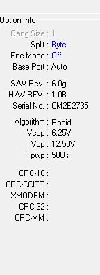

Maybe there is voltage drop (possibly due to dirty IC legs)? I'd try setting 13.5V in the programmer.
Disclaimer: I'm not an expert so take my advice with a grain of salt.
While not the same programmer I have a Stager vSpeed which is... temperamental at best with 27c4000. I actually had to up the vpp inside the configuration file by 0.25V increments until it finally started programming them. I think mine's either 13 or 13.25V, not able to check.

Let us know what EETools says. I've had the same issue with those chips refusing to program with my ChipMax 2. They do program correctly with my Wellon VP-390.
Sent the Hitachi 27C4000 to EEtools today, now wait and see!
In the meantime, I used Macronix MX27C4100-C and the conversion works perfectly :) Thanks all for your help!
