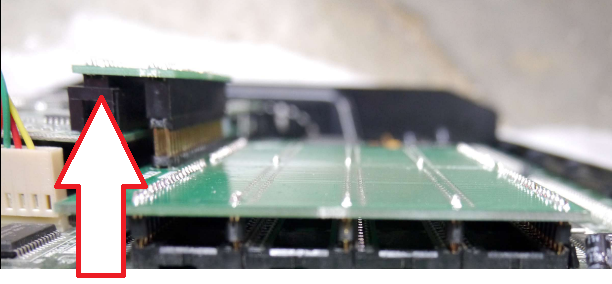

A problem with black/white screen in general indicates that no code is being executed, so we have a problem with the program roms. Checking your pictures. I can see that the intersection PCB that joins program roms PCB with the main PCB of the multi looks like not completely inserted in one of the sides. See picture attached. Make sure it's properly inserted, shortcut EXC5 (with the power off, of course) and let us know how it goes.

That picture make it looks bad but the connector is fully bottomed out, however there is progress.

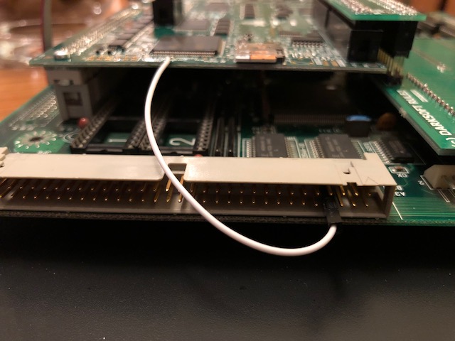

Okay, I have soldered a wire from SWD7 to A29 which the V3 instructions say handles the reset function, but my board will not auto reset. I soldered and then re-soldered it to make sure I had a good connection, but no matter what I do the kit will end the flash with garbled graphics on screen and sit there until I power cycle it. Does anyone have any ideas? I have a 93646B-3 board and I am using these instructions:

Can you take a pic of your setup where we can see where wires are soldered?
Here are a few pictures of my setup. Any help is appreciated.

I have been trying that with no luck. I was inserting the pin on the bottom set, 4th pin from the right. Am I correct that is the A29 pin?

That doesn't look right. Here's a photo of mine. It is working and using the encrypted rom set.
