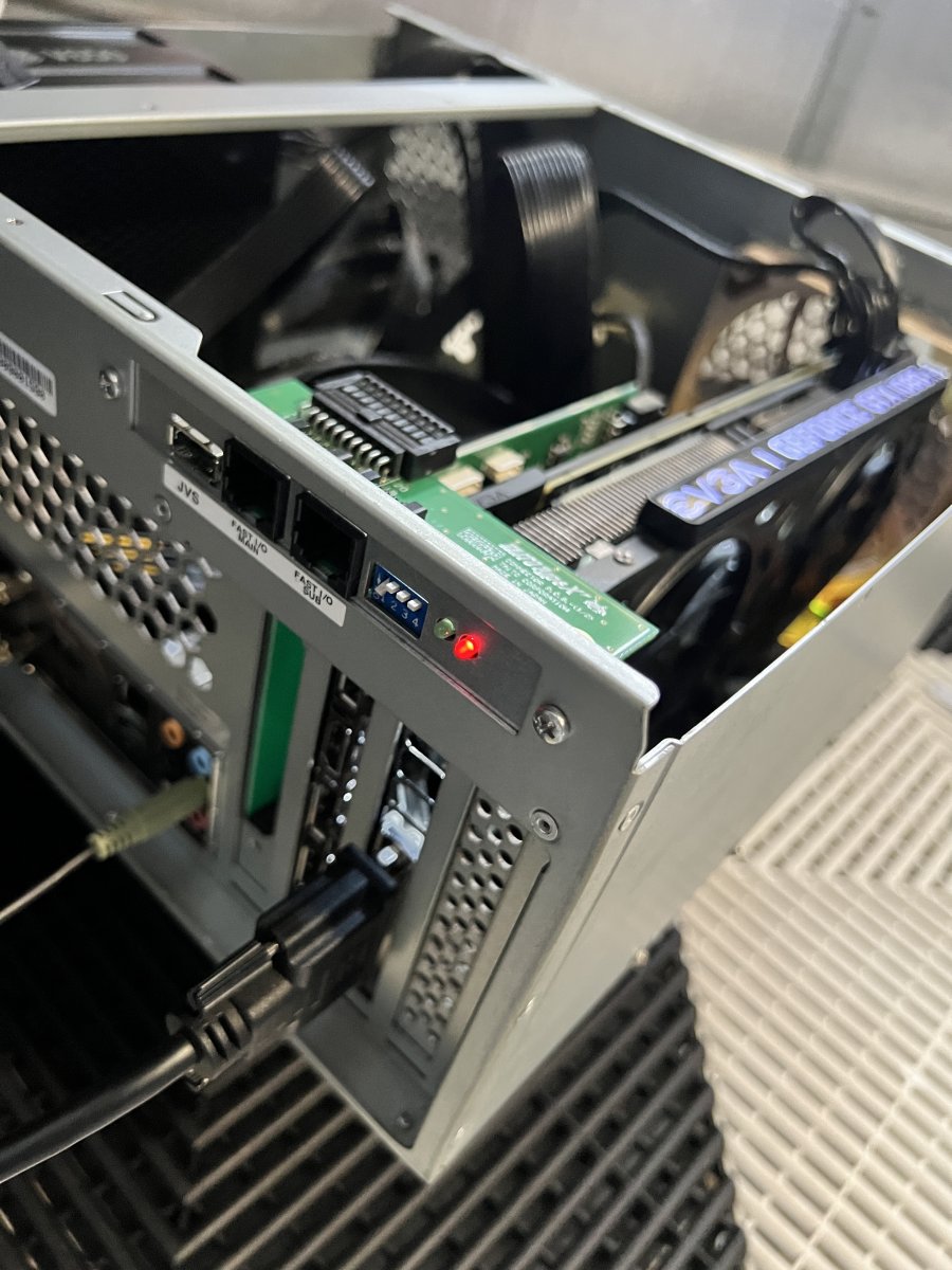

Can you post a pic of your TTX4 with the Fast io PCI-e? If possible, a photo of the interior to see how you have assembled it.

RS1 and FP1 not need to be connected. Just the pci card plugged and the small board connected for input.
(if you need only fast io)
Work great on my Alls and Ttx4
Here's integrated into an Alls.

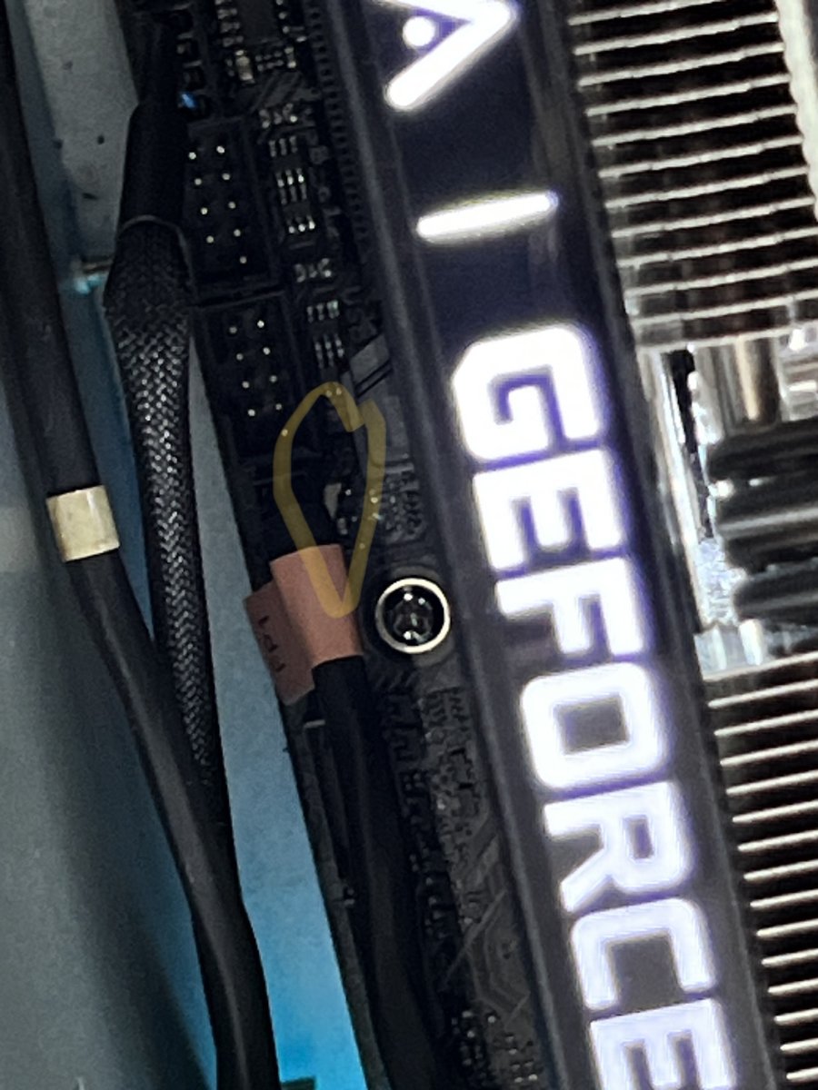

For working led, you need to add the "FP1" to the Pci card.
Break out carefully the white wire from the FP1 connector on the motherboard and connect it to USB +5V pin.
Ty! I was able to break it out from the header and found a 5v source nearby that was close enough. The 5v from speaker header!
