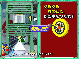

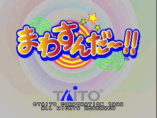

I also took a video of the game playing:
View: https://www.youtube.com/watch?v=vQR3-MolTyA
this is designed for "spinners" but surprisingly the menus and some of the mini games worked with joystick and buttons

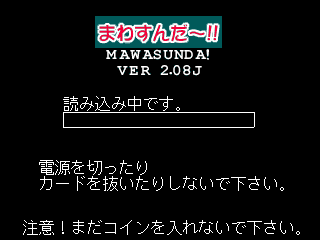

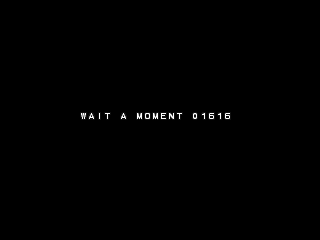

There is a very long boot sequence every time the game starts, it's unclear to me what it's doing but it seems to be AFTER the screen where the game loads off of the CF card and into memory.

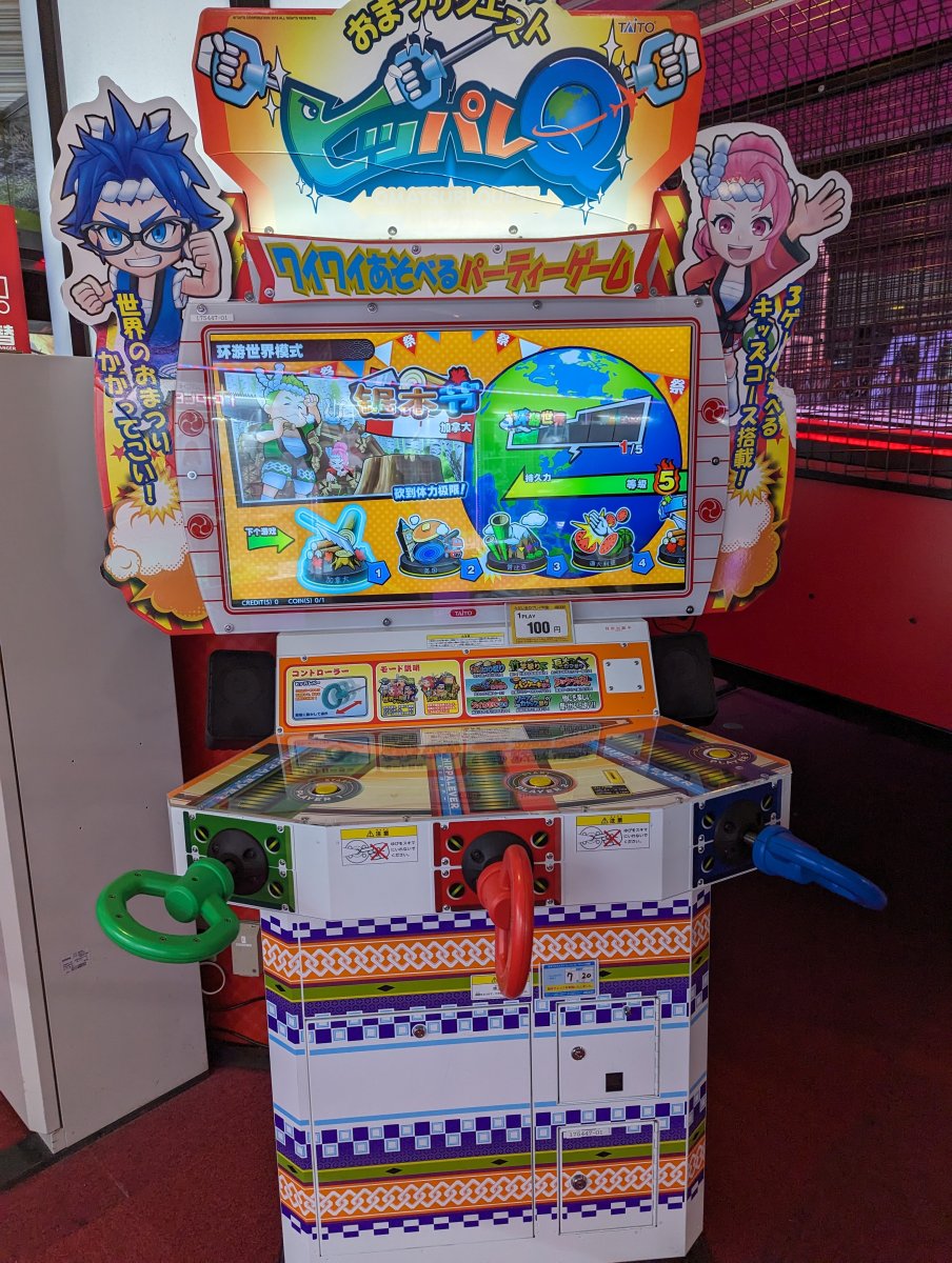

The "T" harness that connects the mobo to the filter board just integrates that "trackball" connector and some power leads. This is because the game is played with 2 giant spinners (as can be seen in the system-16 cab image).
The huge ribbon cables and additional IO boards are for the "lamps" of which this game supports 16 lamps according to the test menu! As well as the "weight" of the spinners. Which I'm guessing adds resistance or force feedback on the spinners to make the games more challenging.
