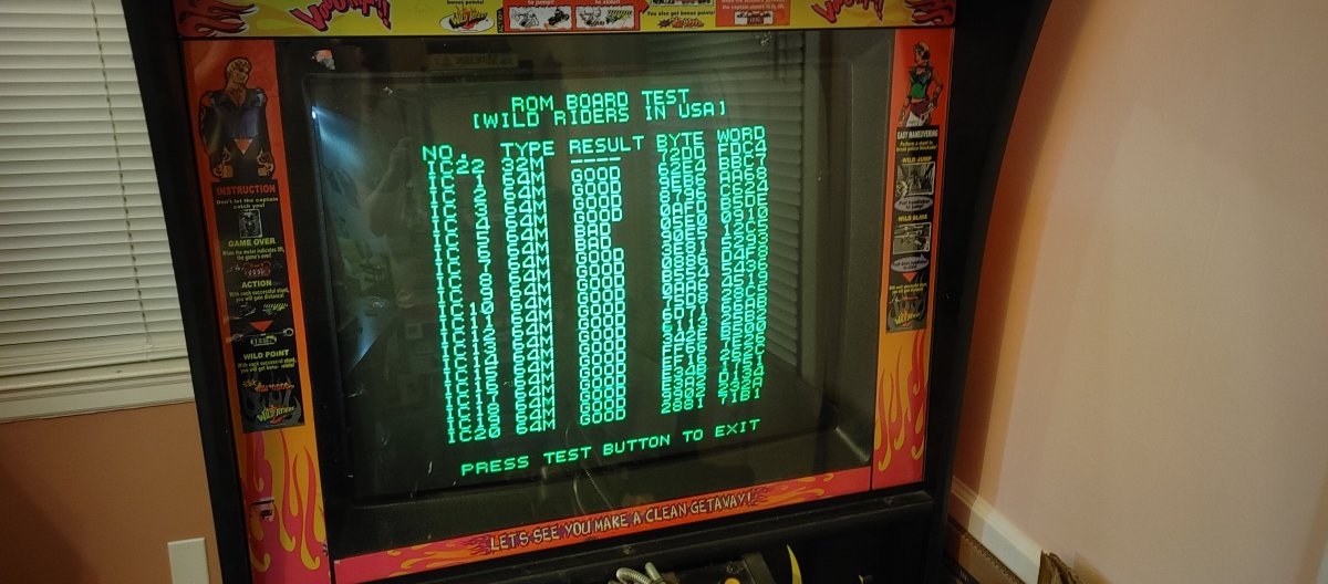

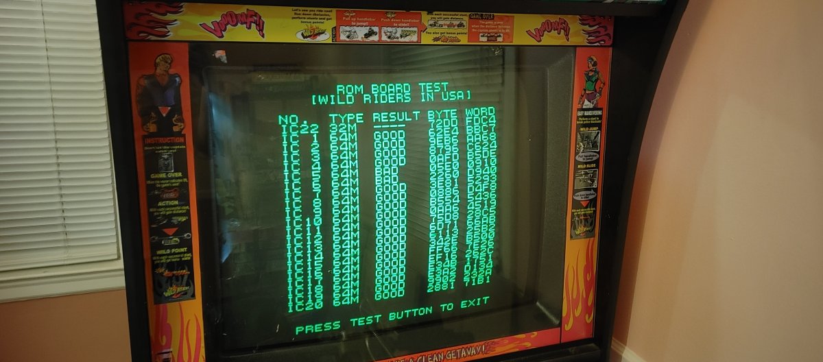

I ran the tests built in to the Naomi platform. All the RAM was good. The cartridge was recognized. If I removed the cartridge, it would boot and then yell at me about there not being a cartridge. However, running the ROM test resulted in a few bad ICs. Namely IC 5 and IC 6. Looking at the cartridge board, these appear to be on the same chip. Interestingly IC 5 always reports the same checksum: 05E0 0910. However, IC 6 always returns something different, even if I run the ROM test and then run it again immediately after with no changes, it reports back something different every time. So I'm not sure if that means the whole chip is bad or what. Visually inspecting the cartridge, the chip in question looked fine, if a little dusty (it's directly underneath the air holes on the top of the cart). Even then, I dusted it off and plugged it back in and got the same results.

So I've got a couple of issues but the main one is the fact that the game never boots.
