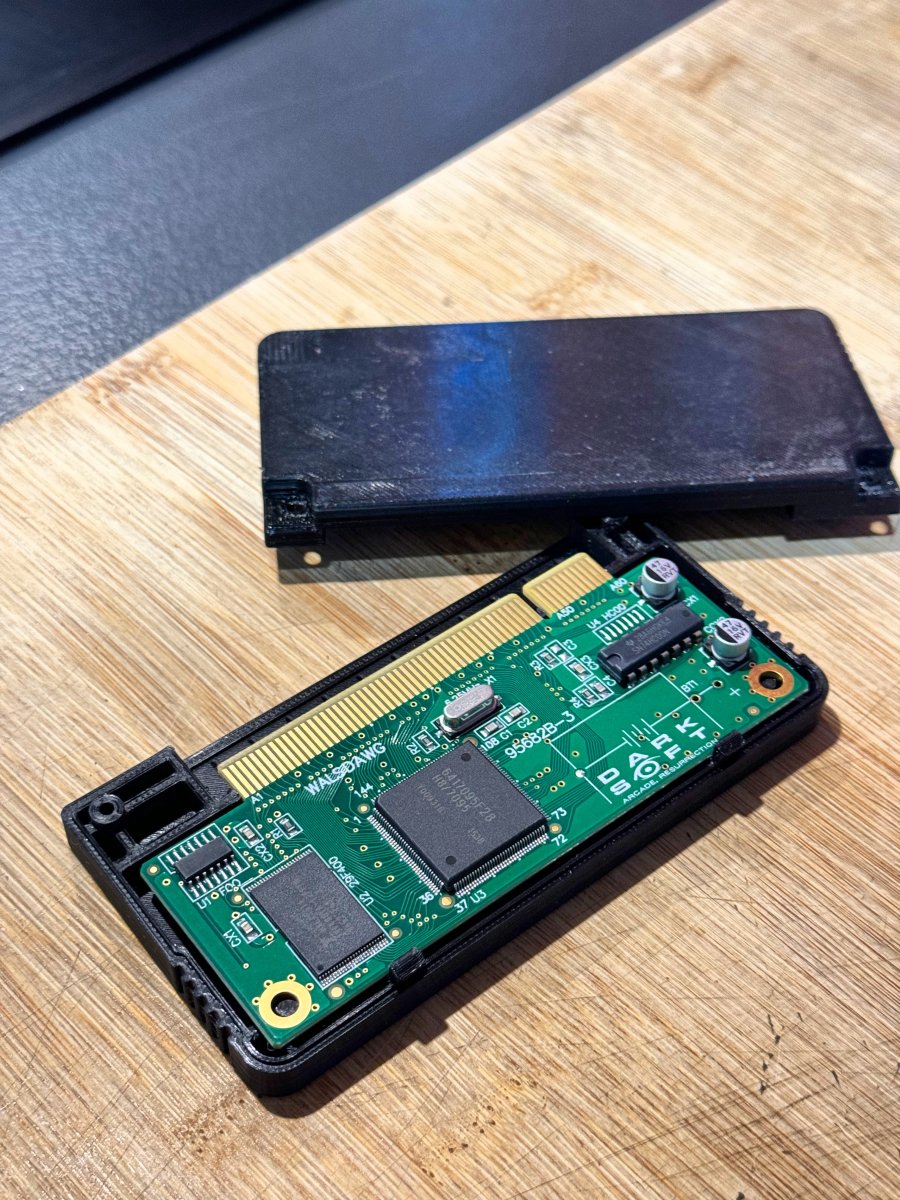

Okay, now that I know how it's supposed to close I can say with certainty I'm unable to get it down onto the pegs on the front side.
It looks & feels like the top part of the pegs have extra material or the material printed kinda rough and it came out oval. I'll try to get a picture of it tomorrow.
The two halves do fit together without the board in them, so the supports are the right length - I just can't get the board onto the pegs. I wonder if I can lightly dremel it back into shape.
I see what you're talking about. Hrm... I think this is an artifact of shrinkage? because all of the "ovals" are in the longer dimension axis? When I measure the dimensions of the print the horizontal shrunk to 118.35/118.6. the vertical shrunk to 58.1/58.6. So it shrunk twice as much vertically in the shorter dimension.

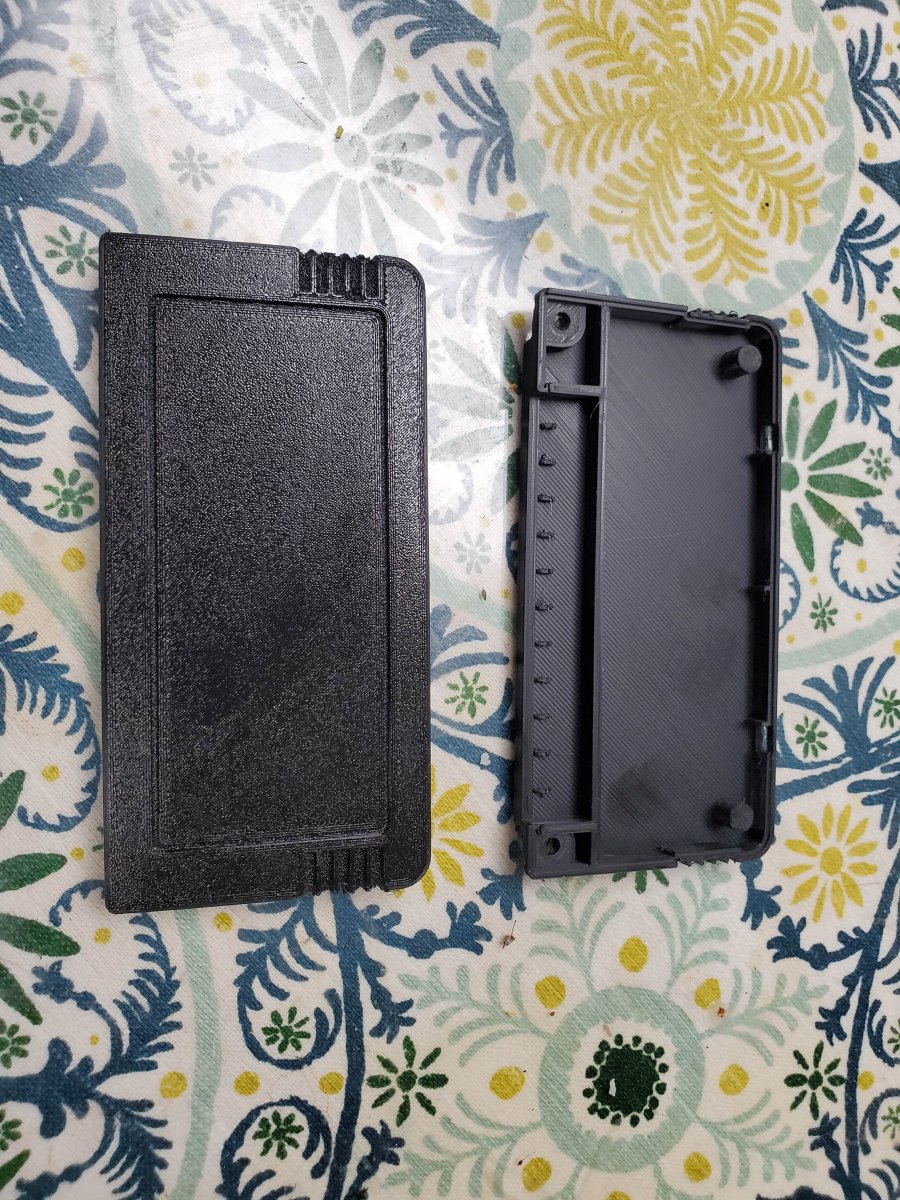

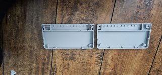

So they Seem to fit together fine, the piece that's supposed to fall off to accommodate the screw, I think having some kind of recessed Hole would make that easier, as when it broke off it wasn't all that level... and the fact that once is breaks off it's kind of rough (texture wise) so overall I'm very impressed it's a very cool piece to print, and I think it should fit (Waiting for my cart to ship), so that I can test it.
Note: I didn't add any supports,while in Prusa Slicer, just loaded, moved the model to the place on the bed I wanted it to print, and it went...
I did have some adhesion issues so I used a bit of glue stick, just a tiny layer, for better bed-adhesion.

Yeah, it sounds like he included that bit of support in the model so that you can print the rest without supports. I like that. I found that the best way to snap out the corner support is with a straight razor. I just get it started in there and keep pushing till the whole piece pops out. the surface is rougher than the rest of the model but not too bad that way.

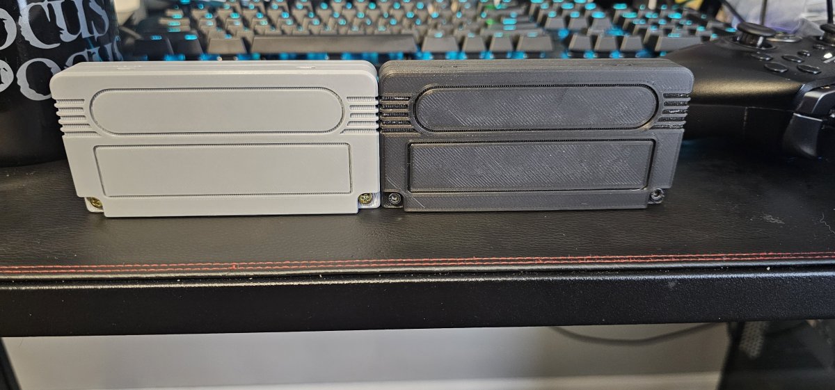

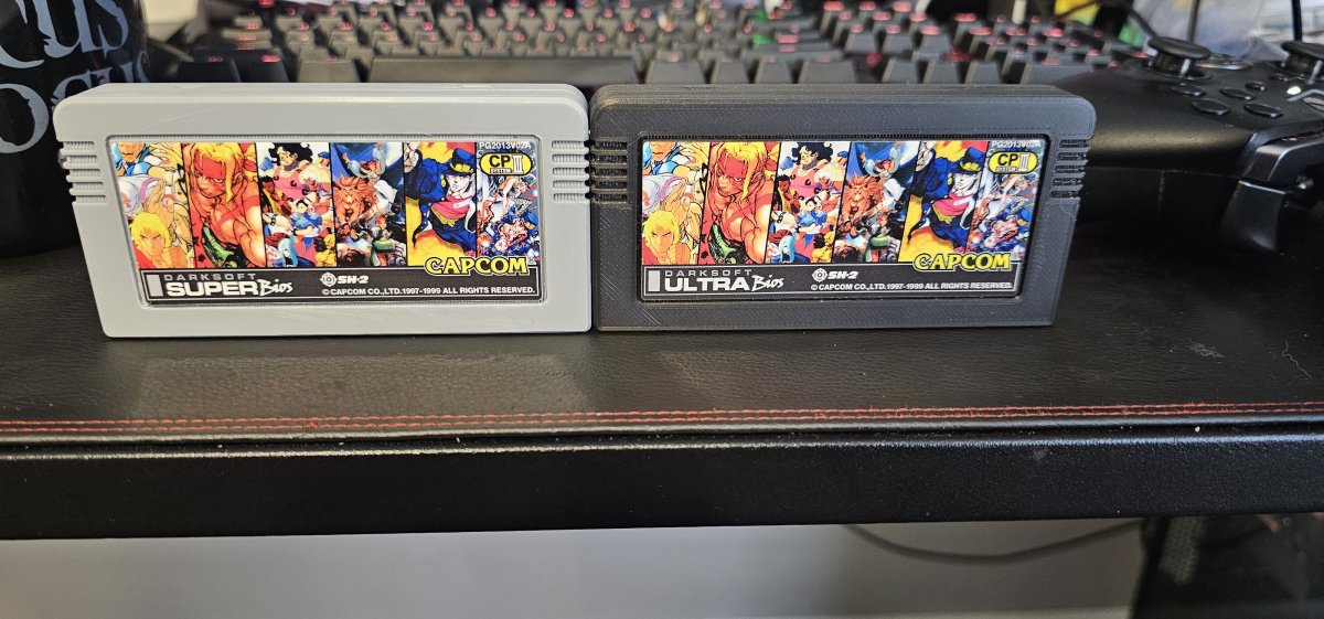

Success!
Dremeled off about 1mm of the excess that was causing it to look oval on each side and it fits like a glove now and is screwed in together.
Thank you for the awesome case KaPH33n & hatmoose! :thumbup: Glad the issue was identified and ya didn't need to send out another one.

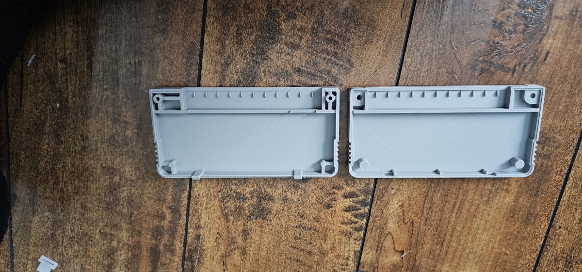

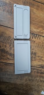

I printed the original design from thingiverse by mistake 😢😢😢 although it looks good

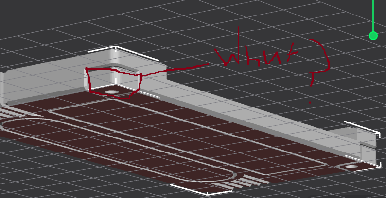

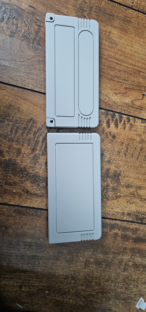

You know i have printed this a few times and this part seems to be weak and useless.
Edit: I say that as a completely new dummy to 3d printing, i would assume it's a support? but if it is, when taken off the surface under there looks rough.

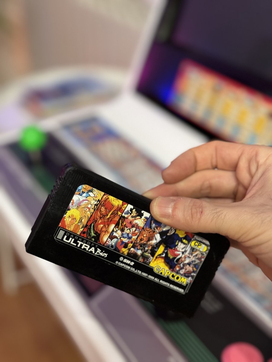

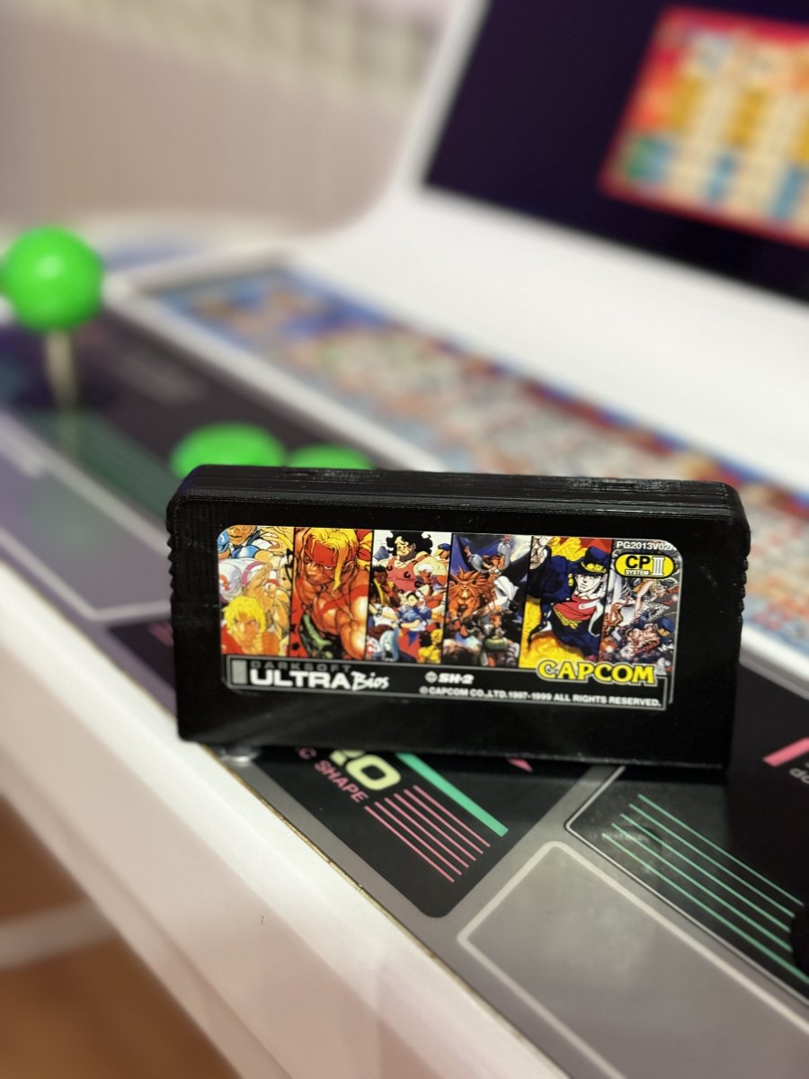

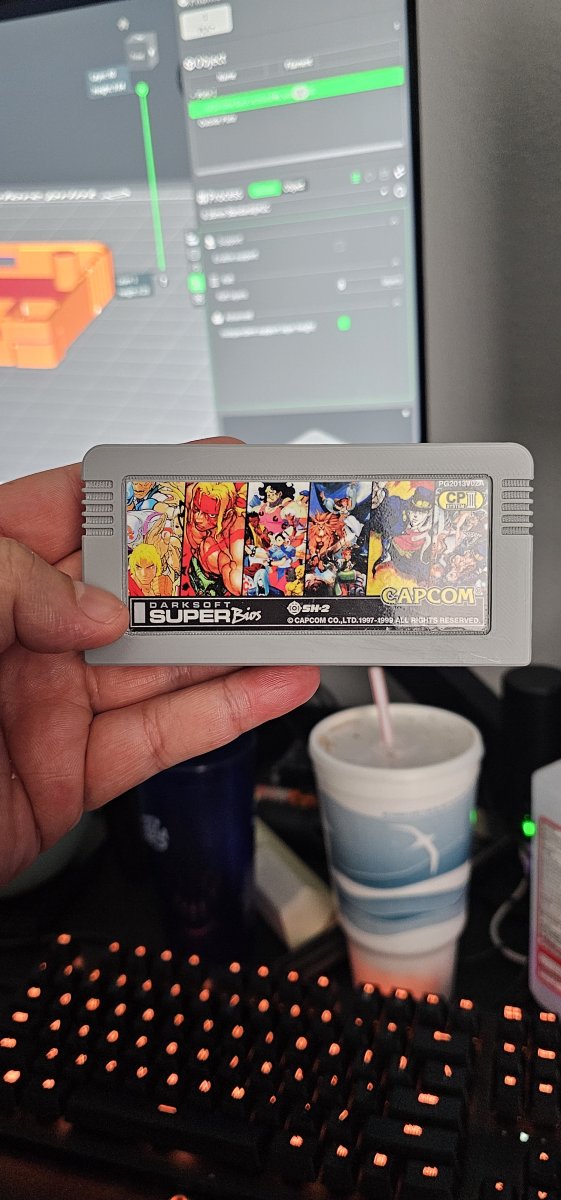

Turned out pretty well. Thanks for the shell solution guys. Gonna do a textured shell for the ultra bios. Probably in Black PLA:CF.
Nice prints! I’m constantly amazed at the recent advances in 3D print quality.
100% agree. That part is weak and useless. It was designed to be snapped off and thrown away so the case would print without supports.
With slicers now generating awesome supports (trees!) and multi materials for dissolvable supports it feels a bit redundant now. I’ll see if I still have the CADs and tidy it up.

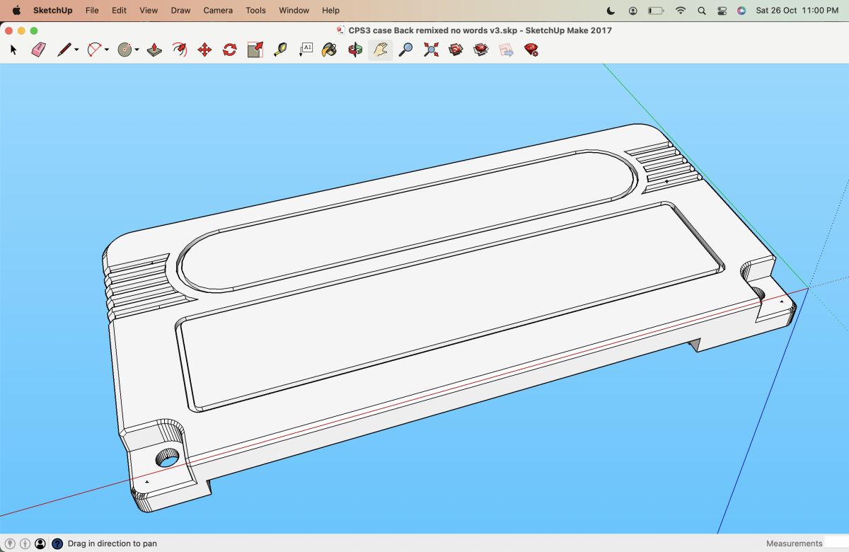

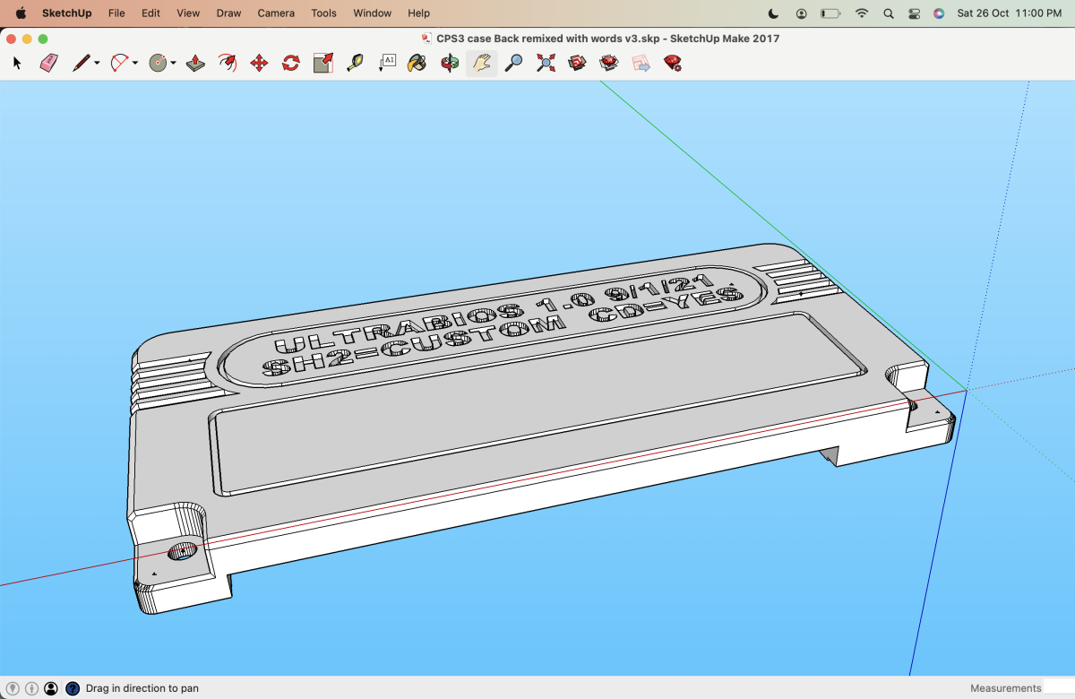

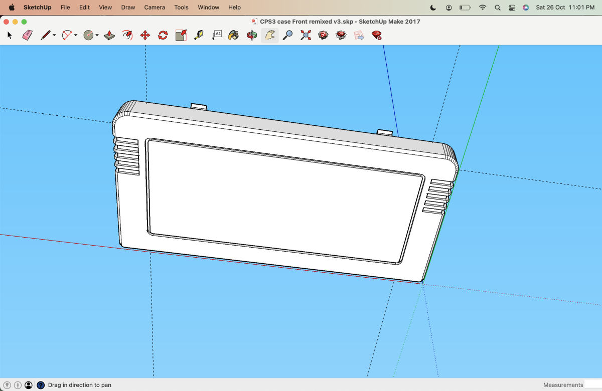

Have updated to "v3" with the following changes, edited the original post to include these details
Back Shell, with words and no words variants = removed the supports from the model = need to "print with support" now
Screen Shot 2024-10-26 at 11.00.34 PM.pngScreen Shot 2024-10-26 at 11.00.06 PM.png

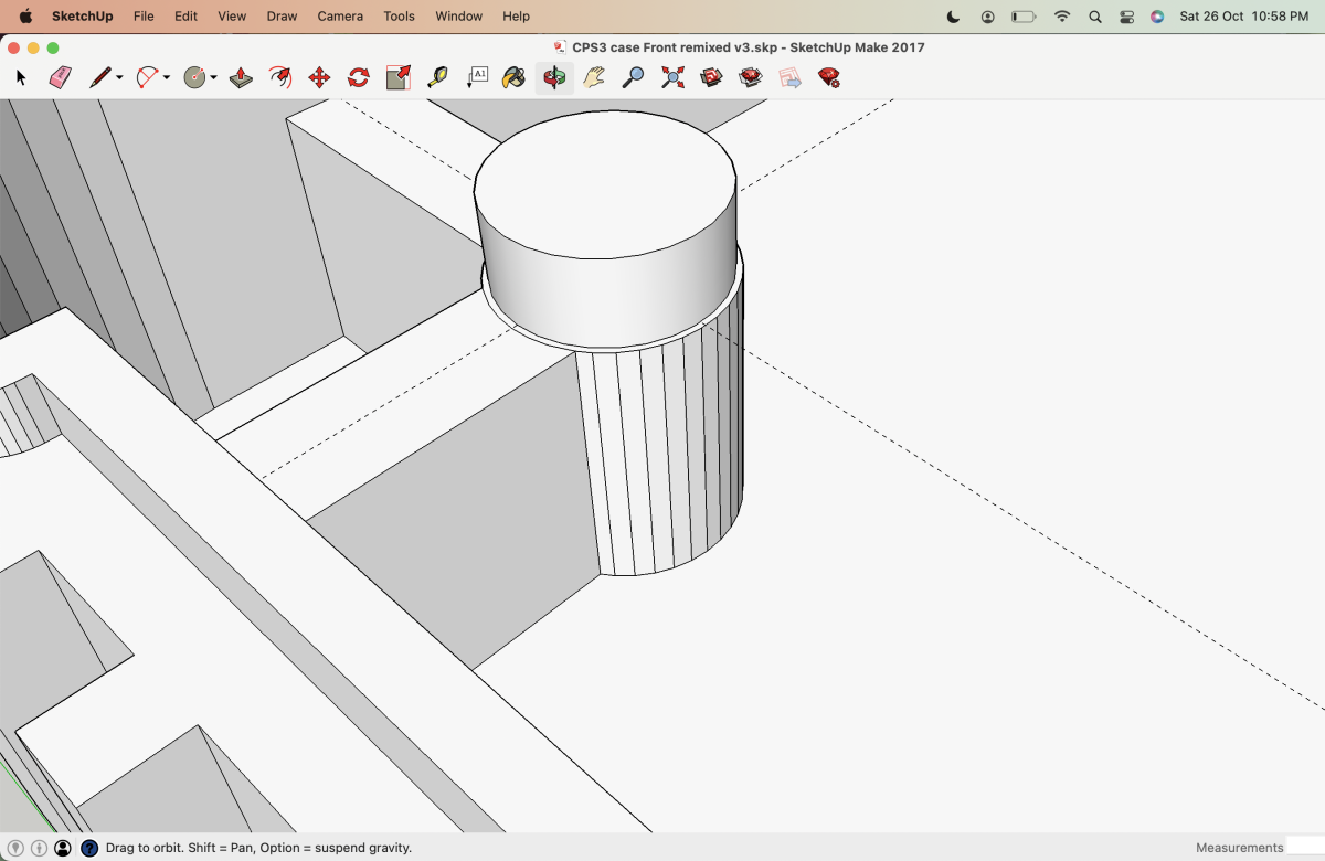

Front shell = shaved .1mm off each side of the retaining peg that goes through the board = many printers dont print dimensionally perfect, this should help the shell fit without manual rework from those printers.
