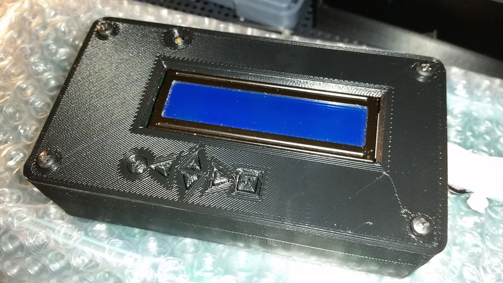

You can thank @brentradio for encouraging me to do this project and lending me his LCD Selector to design the case.
The case requires no supports to print, the only special requirement I recommend is printing the buttons with a 10mm brim as it will make installing them much much easier. Also included is a small support block that fits under the LCD to prevent it from flexing when pushing the buttons.
it requires 4 30mm M3 screws to hold it together
As always you can download the design on thingiverse for free.

neat. you made buttons as well. pretty cool. thanks for keeping your projects opensource. Much Respect. let me know when you need extra likes. :thumbup:
this should print easier than most of my other stuff since I wasn't constrained to making it fit into something else externally I was able to design it to not need supports.
weird, I know some people who raft everything. seems like a waste of time and material if the part doesn't call for it. my prints usually turn out like garbage when I try it though...
