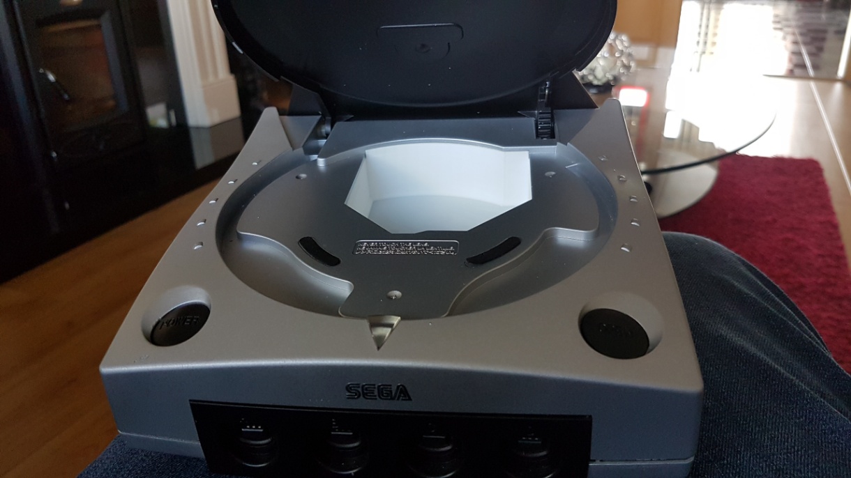

Here's how it turned out
Many thanks :thumbup:

LOVE that Silver Dreamcast By the way :)

Thanks, it's my favourite colour combination. The only way I know how to measure the cpu temp would be with a temp gun and lift the usb gdrom off completely and check the steel plate underneath, it wouldn't be the most accurate but might give an idea
