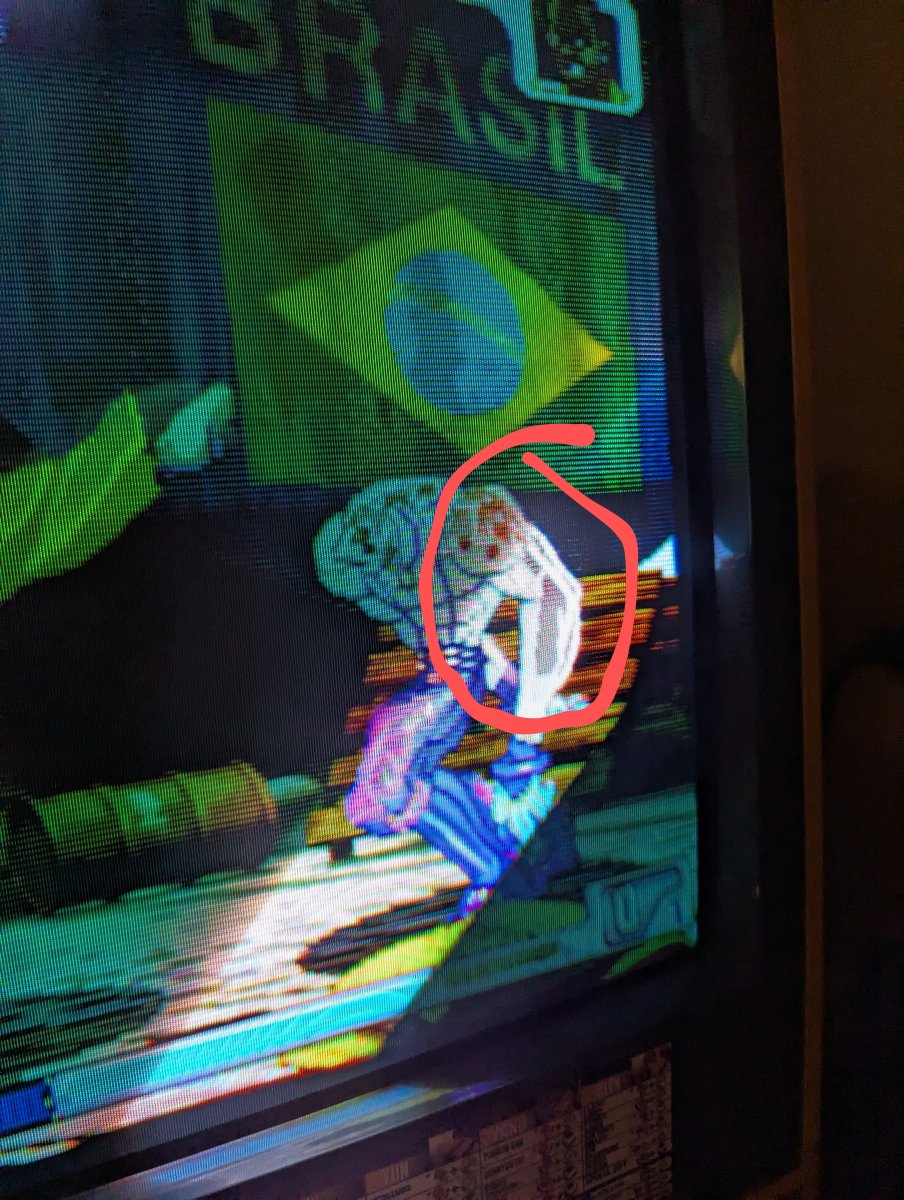

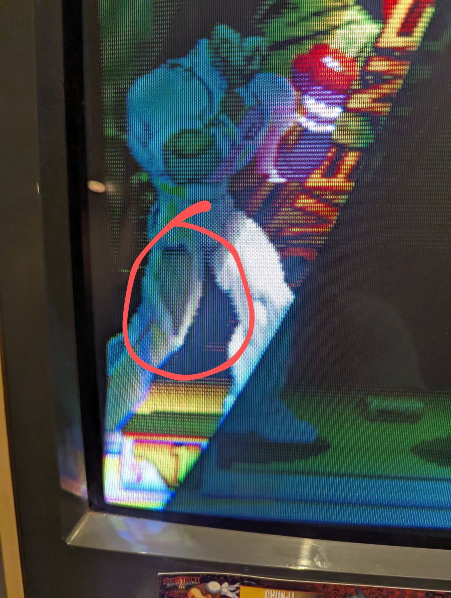

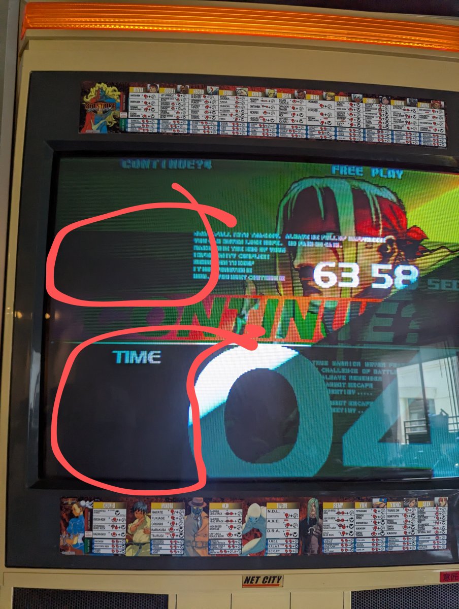

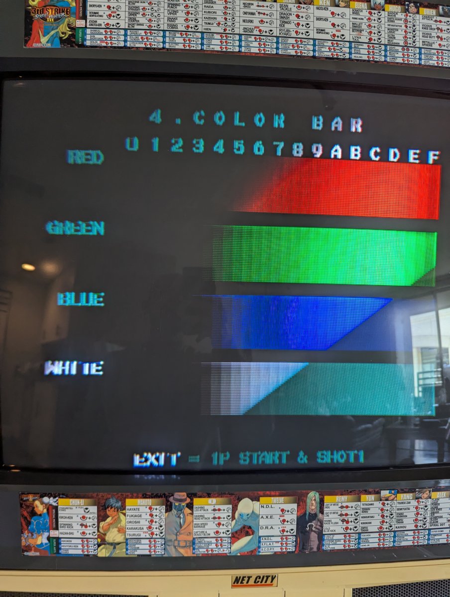

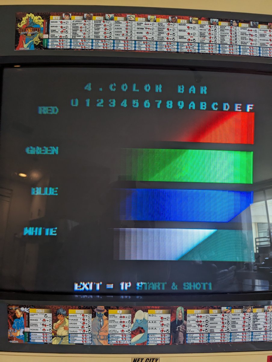

You are most likely sending Jamma level RGB (high-impedance input on the monitor chassis) through VGA level RGB (low-impedance on the chassis).
The results will be what you are experiencing on 3rd strike. White etc will be super blown out and look weird as hell.
