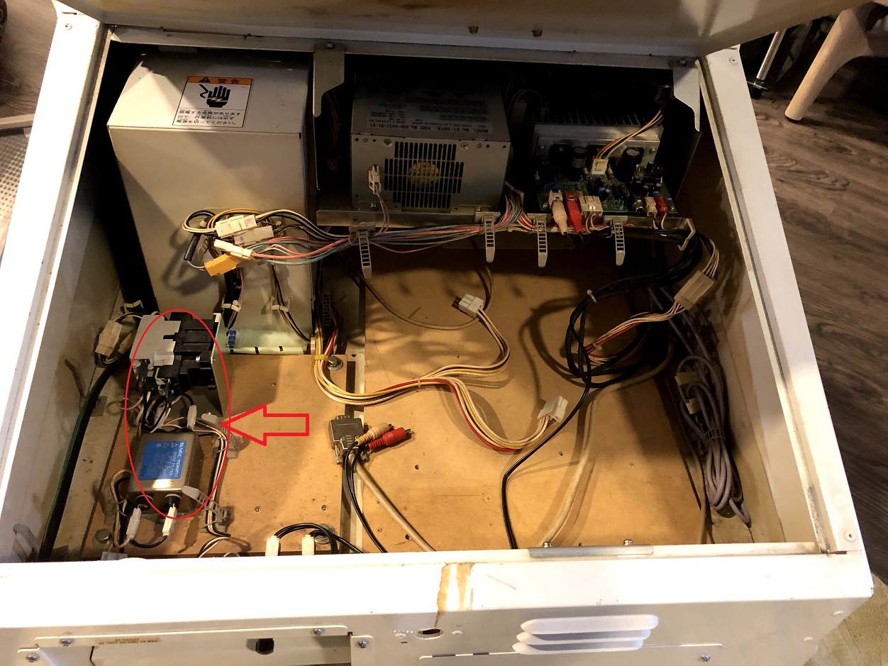

btw. what is all this? My NNC doesn't have these parts;
yeah weird, must not be standard equipment then?
which panel did you get from Alberto?
That is odd, my NNC doesn't have it either, nor does it have that odd cage around the psu.

The PSU looks different because it's a Lindbergh PSU not a NAOMI PSU, the lower box on the left is an AC filter, the black and white box above it I'm not sure, but it looks like a circuit breaker.
I'm guessing this cab was originally setup for Lindbergh use.
You are correct sir. Also many US cabs had the noise filter as well on original uprights.

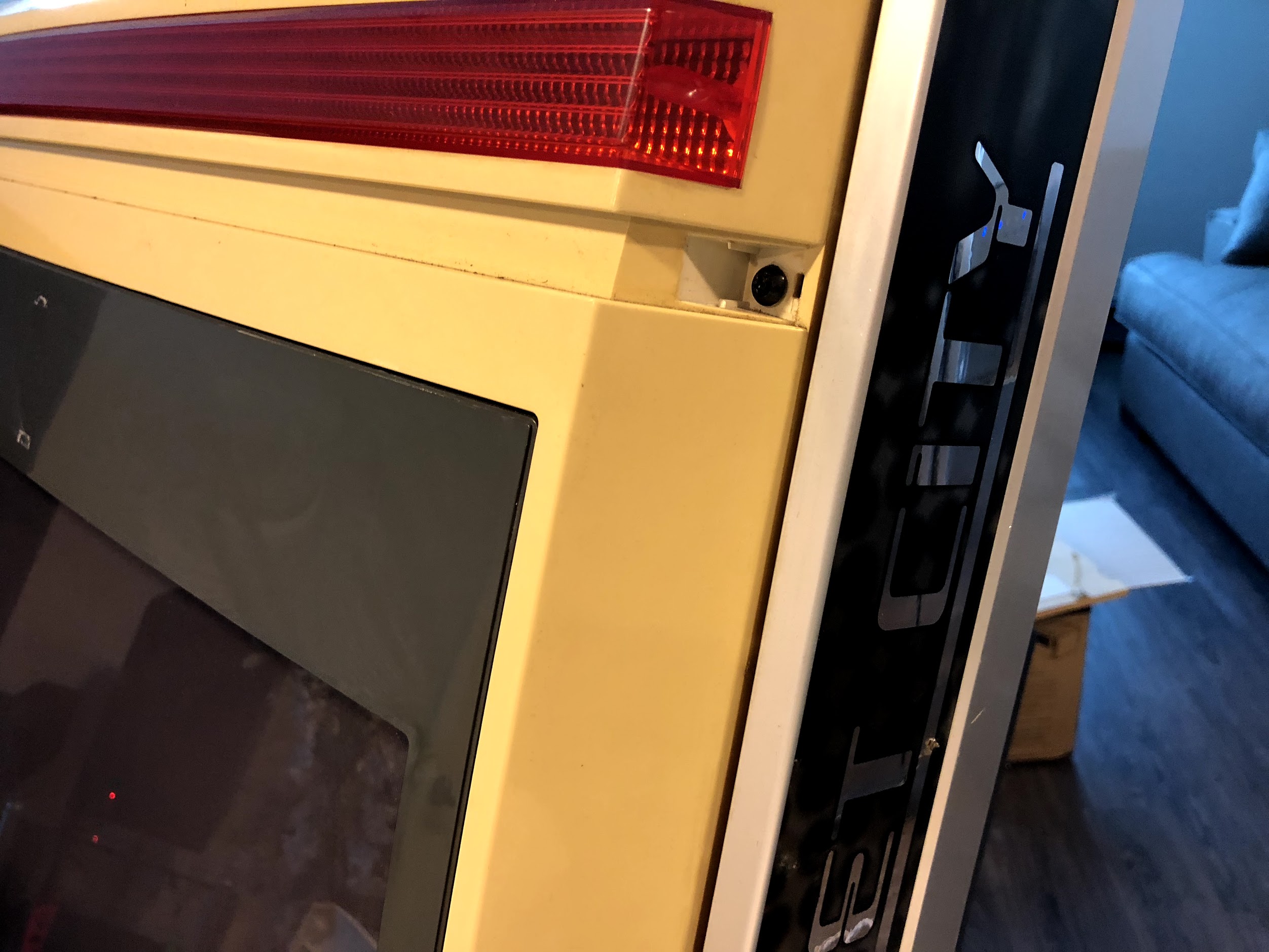

Quick heads up as I had to dig through the interwebs and only found a post from six years ago on AO on properly removing the monitor frame.
A little bit of deception happened on my end as the cab arrived with it only having three T30 torx screws, before I even knew there were screws, with the bottom right left loose. I thought it was a pull out frame and that was not the case. I heard a crack and that's probably the bezel which means I'll either have to bondo it up or source a replacement from Yaton on eBay.
To expose the screws, you need to remove those tabs below the light and around the speaker areas. Chances are you might break the tabs into pieces, so take caution.

@OP, looking good so far, I'm really interested in how the shroud will come out.
Yeah, just sand it smooth and paint over it again. Best rule of thumb with any kind of rattle can painting is to keep moving. Several light coats are the key to getting a nice finish.
Sand it down, and respray it. Just remember a lot of super light coats is the way to go, the vinyl dye spray is much lighter than other spray paints, so its more forgiving. But its always best to just a lot of light coats on anything your are spraying rather than one or 2 heavy coats. You can also add a sealer top coat to add some further protection and give the piece the sheen you are looking for, from matte to high gloss.
I've tried rubbing off the run with nail polish remover, but that's not working. I guess it seeps into the plastic quicker than I expected.
Given it's dye, am I screwed? I've heard of brake fluid being able to remove it, but it depends on the plastic. Worst case scenario, I can reach out to Yaton or Videotronics for a spare.
DO NOT USE BRAKE FLUID!!! that will erode the plastic itself which is 100x worse than drip marks.
I got the occasional drip mark or other blemish. what I did was wait for it to dry completely, then take some 450 grit sand paper and a water spray bottle and soak the plastic and the sand paper and gently wet sand it away. you may have to give it another coat or two with the dye if you sanded it too aggressively but once you're done you'll never know a drip was ever there.
