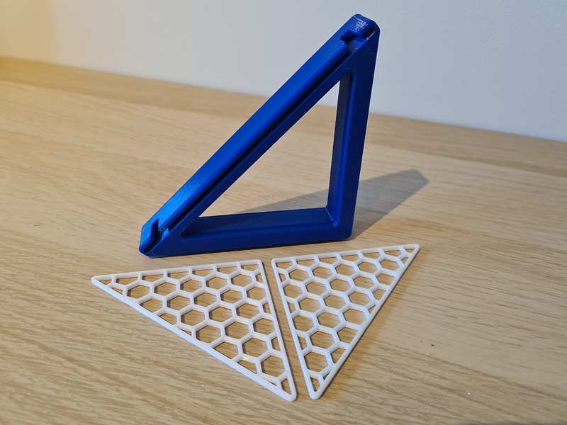

A bit of (Vewlix Dia) blue for the lads...
@Softdrink yea not bad, I wanted to utilize the threaded posts/mounting point just behind the sound amp PCB, so really it would just be adding that to this design more or less.

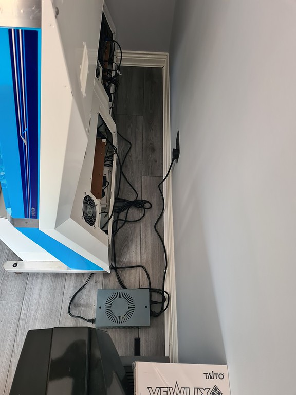

The problem with this is that every time I pulled the cabs out to work on the power cables would pull forward. When I went to push the cabs back the wires would get caught under the wheels and it was a ball ache fiddling with them the whole time. I thought about mounting the stepdown on the wall between the cabs but I didn't really fancy doing that. Another issue I found during working on the cabs is that I couldn't fit the smallest PC I have inside the Vewlixs. This meant I would have to get a smaller PC or run it external and have more wires running behind the cabs which I really didn't fancy. So, rather than using less wires, I bought a crap load more :D

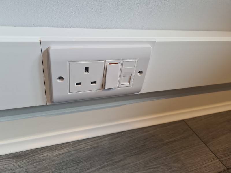

And ended up doing this:

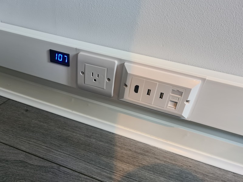

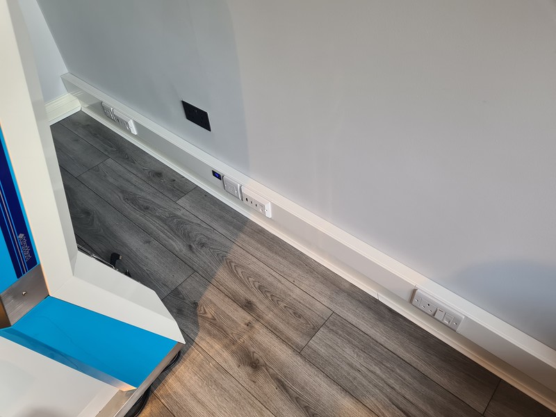

I added a 3m secton of 100x50mm Univolt trunking and bought various gang accessory boxes and plugs & media modules. The idea being that I could use the trunking as essentially a power strip with some mutimedia IO functionality. My desk and gaming rig is on the other side of the room so I figured I could also put the second PC under my desk and run all of the cabling through the trunking. That would save having PCs in or next to the cabinets.
The cab nearest the wall has a NEMA 5-15P US power socket (that JP JIS C 8303 plugs fit just fine), two USB ports that are connected to 10m USB repeater cables, a HDMI socket with a 10m cable attached and a Cat6 RJ45 socket. I had to learn to wire RJ45 sockets with was fun and I added a ~10m cable to this too.
The other cab has the same setup but I also added a AC voltmeter to display the AC output from the stepdown. I can't do anything to adjust the output but it's nice to keep an eye on what's being output. So far I've noticed it range from 103-107V.
Next to the cabs I've got a B&O MX4200 setup for consoles/MiSTer so I've added a UK plug to this with a power switch and another Cat 6 RJ45.

I've aligned the sockets to be in the centre of the cabs so that even when I pull them far out the cables then trail between the wheels when pushed back.
As the power/IO bar is low I've used 90 degree cables and/or connectors to allow the cabs to be pushed up close to the wall. Not pictured (I'll add later) is a strip/bar I've screwed to the floor to a) stop the cabs being pushed back too far and b) align them perfectly.

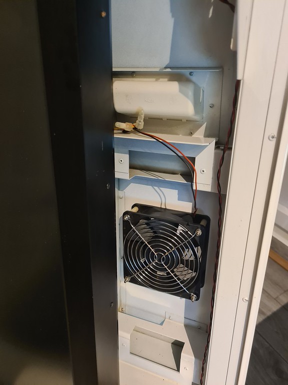

The stock fans in my cabs, like most Vewlix's I'm sure, were loud as fuck.
This was the state of the fans when I first got the cab:
Luvverly <X

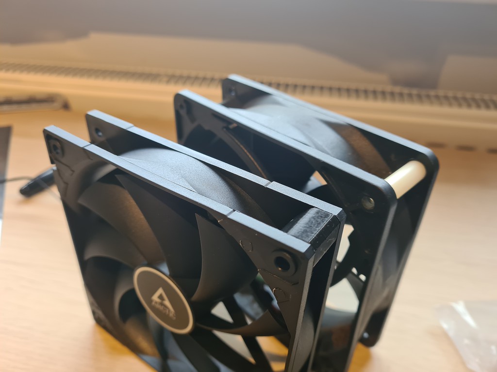

Even after cleaning them they still sounded like a harrier jump jet winding up.

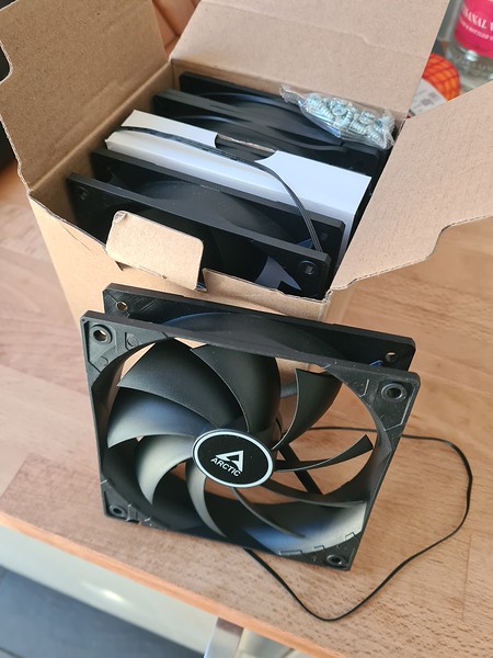

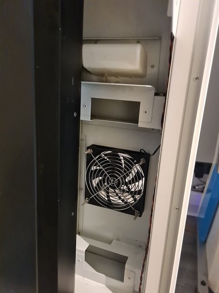

There are two 120mm fans in the Dia blues, one at the bottom of the cab and one behind the monitor. I looked at a few options for replacements and balked at some of the prices for fans, especially when I needed to buy four. I thought I would start with something cheaper and see how they go. In the end I picked up a [five pack of Arctic F12 fans] from Amazon for ~£21.
The original fans had been hardwired in with some closed end crimps so I had to cut the fans off.
The OG fans are bolted all the way through and so have those white nylon tubes to stop the flanges from bending :whoopsie: I wanted to bolt the replacement fans in the same way and so I printed some supports for the flange centers:
The fans came with a three pin non-polarised connector. I've got some pin headers that I could attach to the stock wiring but I wanted to use something polarised so that I don't run the risk of plugging things in back to front, especially when rummaging around in the back of the cab. Using a connector means I can always easily swap them out if required. I had ran out of 2 pin JST YL connectors so I used some spare JST XH connectors I had. They don't do a wire-wire connector so I soldered a header onto the fan and crimped a connector onto the cab side. I only needed 12v and GND so I tucked the sense wire into the outer heat shrink.
All done:
Now wasn't that exciting :sleeping:
The noise from the fans is a massive improvement though. I've uploaded a video [here] where you can hear the difference between the stock and upgraded fans.

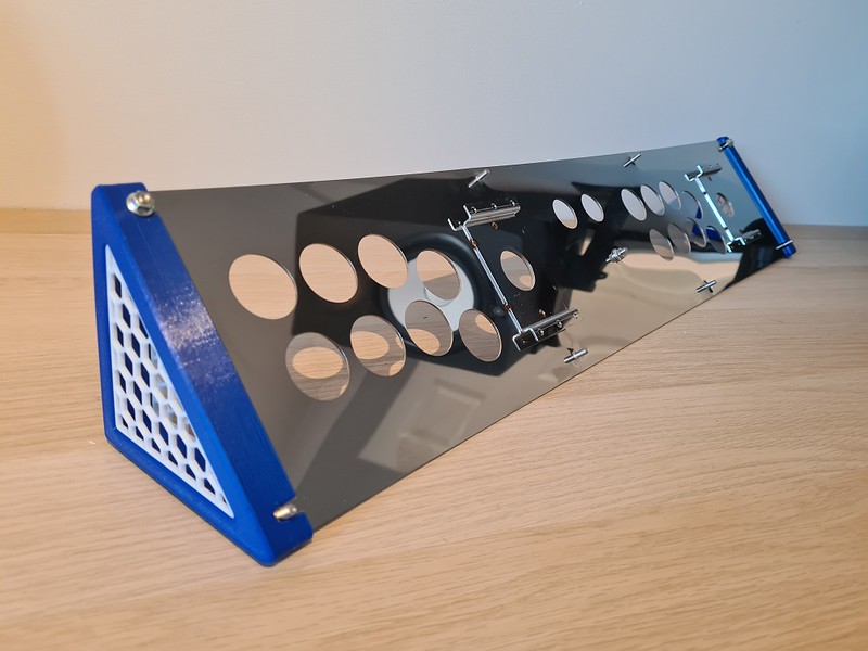

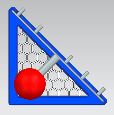

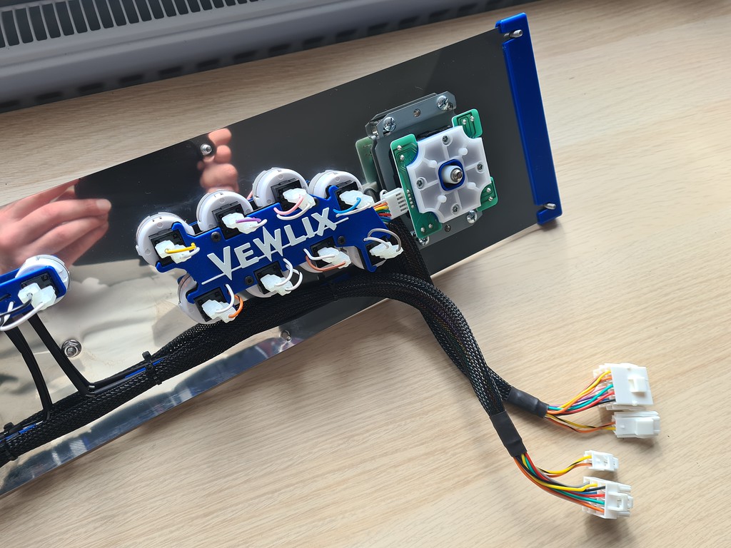

This is my latest (6 months ago) version of the sub panel:
So, top left and top right are two sets of 12mm illuminated buttons, similar to [these].
One of them (for each player) is the latching type and used for switching the Brook UFBs on and off when changing systems as you need to hold different CP buttons whilst power cycling them to set the mode. Secondly, the PCs I'm running are external to the cabs and I have USB power set to always on. I don't want to keep the Brooks powered when not in use so this would allow me to switch them off also. The LED ring also indicates when they are on/off.
The other 12mm button for each player is for a momentary type for the Turbo key and LED from the Brook. It works fairly well, the only thing to improve it would be if you could adjust the auto fire frequency. Still a worthy addition though. Once again the LED ring would indicate if any button has turbo applied.
All the white buttons are 24mm, I don't feel the need to use 30mm. The two in the center would be for P1 'Share' (Select/Back) and the other would be P1 'Home'.
The single 24mm buttons on each side of the panel would then be the 'Touchpad' buttons. I'm not running PS4/5 myself but my original though would use these as credit buttons for MAME etc. Now I'm using the [Coin Reject Button Kits] that frees up a 'designated' credit button and so I may scrap or repurpose that.
In the model above there are two rear mounted Neutrik USB ports in the middle of the panel. Ideally I would like these towards the outer edge but they would foul the mount I have my Brook UFBs on, so for my panel they would need to be somewhere around there. I might change tactic on these now and use more of a low key method similar to what I used to mount the USB extenstions/ports in my [MiSTer Ironclad case]
As i was using a tinted clear panel for the Ironclad I kept installation hardware down a minimum (i.e. none) as I wanted it to look as clean and unobstructed as possible. The Vewlix sub panels are opaque and the cables may be subject to more stress with the CP opening/closing so I've been experimenting with a different mounting method for that.
That's it for the sub panel for now. I need to get some time back on the cabs and play some games ( :rolleyes: ) to double check what 'admin' buttons I need for each console.

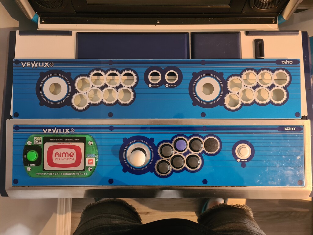

Control Panels

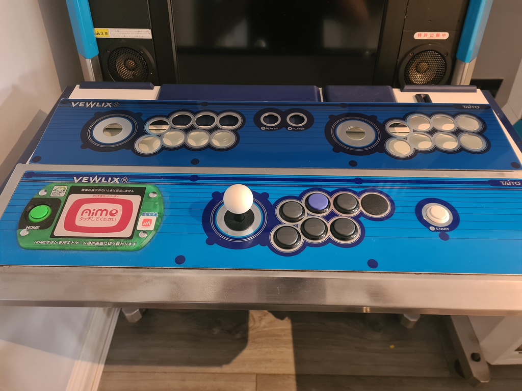

Both of my Vewlix's came with 1L7B panels. I wanted to get a 2P panel for the hori cab and I thought I might as well replace the 1P panel in the tate cab to get rid of the card reader. After playing a few games I decided to go for 1L8B and 2L16B panels. Now, I'm not expecting to play a lot of games that need 8 buttons but some games I was playing just made sense to have four buttons on the bottom row. I contacted Alberto and ordered both panels in May 2022. The 2L16B was a stock item but he needs to make the 1L8B. The 2L16B landed in August 2022.
The quality of the panel is fantastic. Alberto warned me that the colour of the overlay wasn't 100% true to the original. In fact, it's very close when viewed directly above:
However, when viewed at an angle the colour does change and appears darker, presumably due to the metallic in the overlay:
Just to note, I'm not complaining here, Alberto warned me about this up front and I'm very happy with the panel. Since then Alberto has told me he's working on a new overlay for the Dia Blues and I'm going to get a matching 2L16B overlay to match the 1L8B when it's ready. :thumbup:

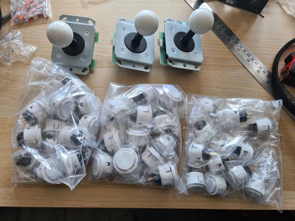

I have got the 2L16B panel wired up. I got a load of Seimitsu Sanwa OBSF-24/30 buttons and LS-56-01's from Aracde world:

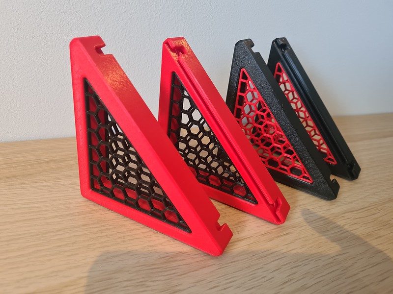

First, I made some CP stands to make it easier to work on populated CPs:
I also made some different coloured versions for some friends:

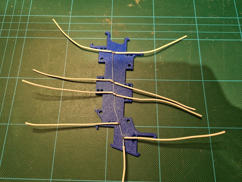

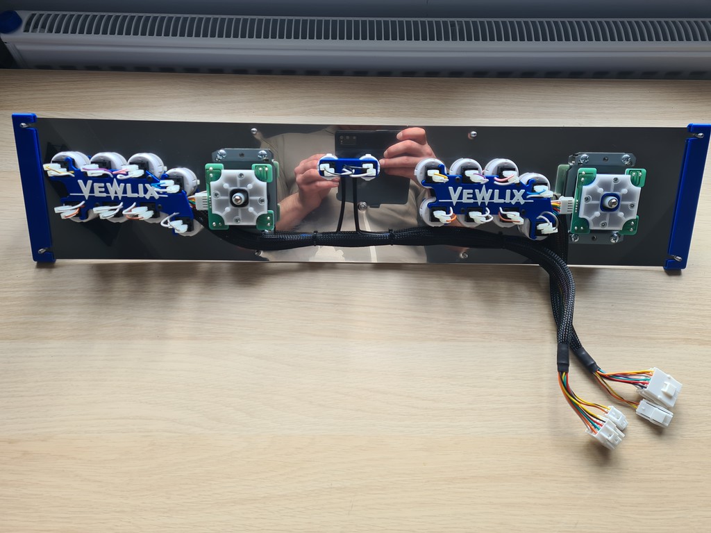

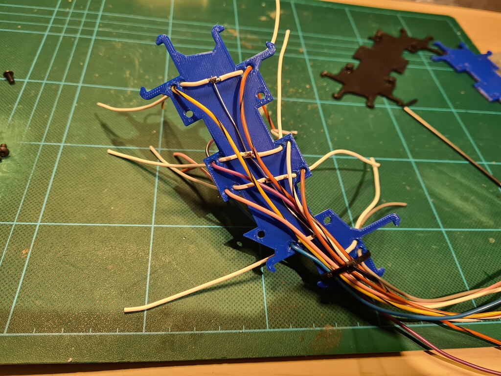

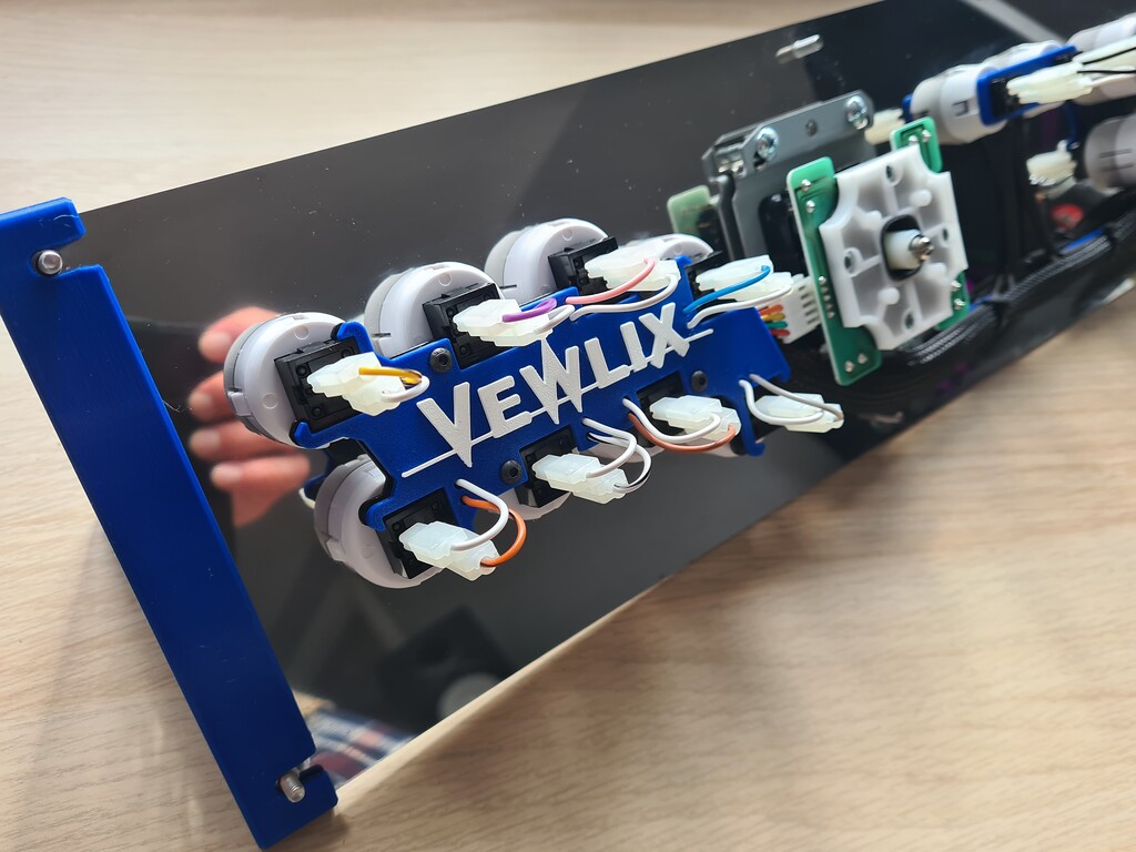

I've always tried to do neat CP wiring and I thought I would try and improve things further over previous efforts. As part of this I printed some assemblies to fit around the buttons:
The idea being that a lot of the wiring will be hidden inside the assembly/sandwich. To keep the amount of wires down I made a common ground 'spine' to connect to the buttons:
The rest of the messy wiring is then fed through and sandwiched in the assembly:

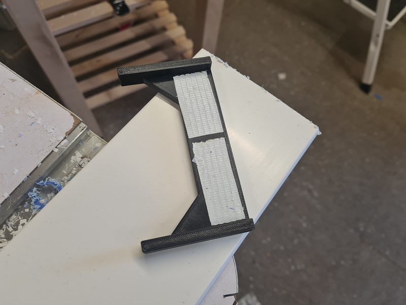

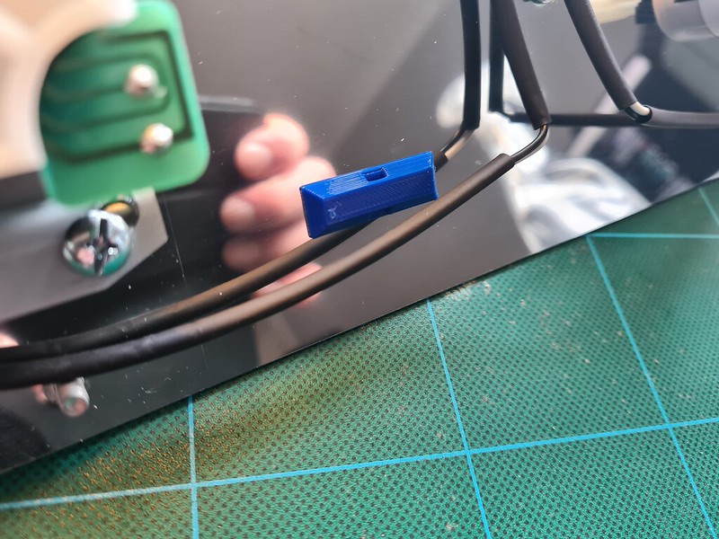

I printed some tie wrap bases to help with the cable management:
All done:

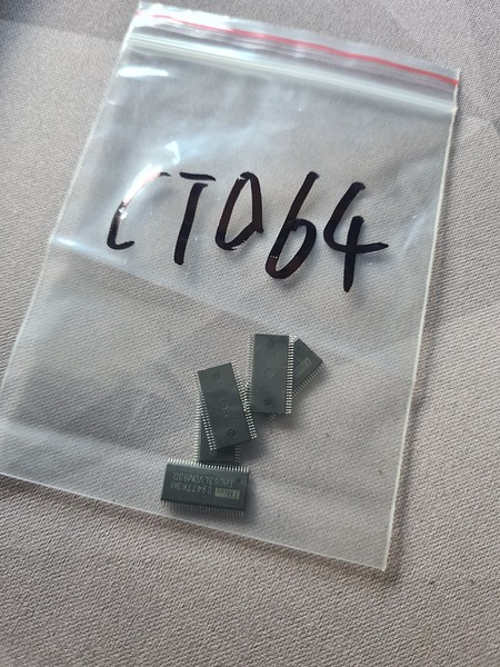

I was speaking with @Monstermug and he suggested shotgunning the [THC63LVDM83D ICs] as they sounded like they could be the culprit.
I ordered some from ebay..... and this is how they arrived :cursing:
I'm sure rattling around in a zip lock bag as they made their merry way to be will have done them no end of good X/ I mean, they may be fake but at least give them a chance!
Anyway, @Monstermug kindly changed them for me but sadly this made no difference. The chips could be fake, damaged or this just isn't the issue. There is a BGA on the board which it could be. Monstermug is going to have a go at reflowing the BGA in a last ditch attempt as rescuing the PCB and monitor. I've looked around and put up a wanted ad for a replacement V28A00122300 PCB but not too surprisingly I've not had much luck.

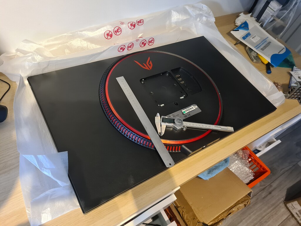

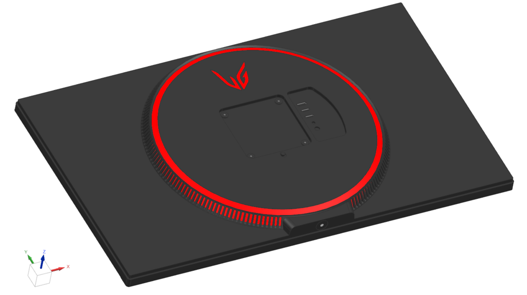

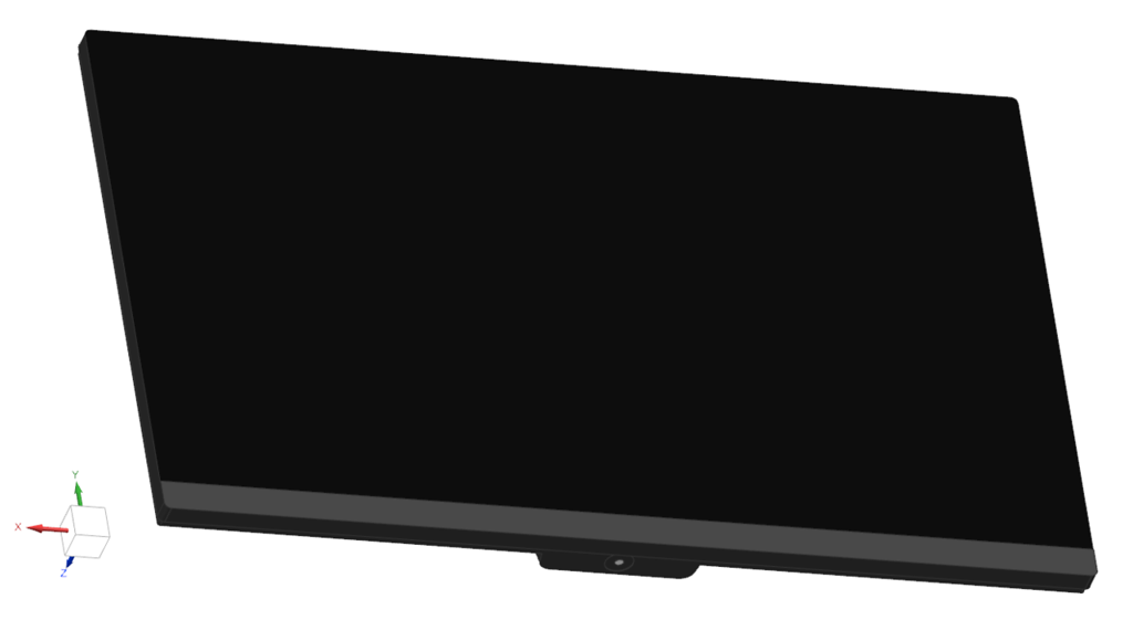

I always knew I would upgrade the monitors at some point but I thought it would be out of choice rather than necessity. Damn this modern flaky tech! I had been looking at various monitors anyway and stumbled across a great deal on a couple of refurbed LG 32GN550 monitors on ebay which I got for ~£190 each
I want to keep the OG monitors but I'm going to make some mounts for these so I can fit them in the original bezels. So far I've modelled up the displays and started to work on the mount design....
View: https://youtu.be/U7bFdMMfCm0
I went far too far detail wise compared to what geometry is actually needed for development but it was all good fun.

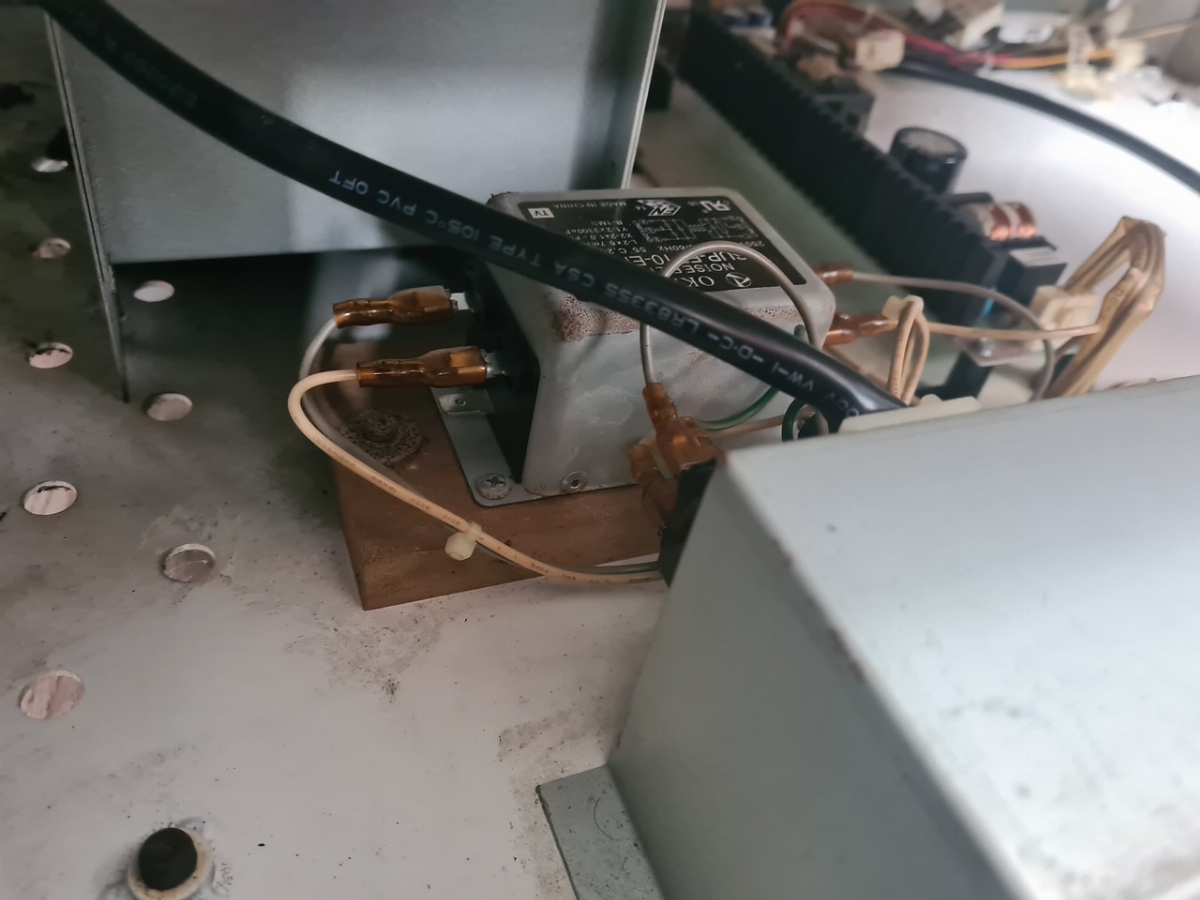

So, I wanted to only have one 100v power lead coming from the cabinet which means everything in it needs to take 100v. PCs are ~100>230v, as is my Switch. My 360 slim PSU was 230v only though. Fortunately cools had just been though similar and found some 3rd party slim PSUs that were multi voltage so I picked one up. [This] is the one I got.
All of these have UK plugs on so I would need to install a UK powerstrip but power it from 100v from inside the cab. I looked in the back and there was the perfect place for a power strip right at the back:
There was even some M3 tapped holes which looked to be in an ideal place too. Originally I planned on running the power strip from the Service Outlet but this is only rated for 4A and I didn't really fancy running a PC etc from this:
Instead, I decided to run it from the LHS of the filter:
I bought some power strips and added piggy back spade and ring terminals to the wires. I printed some brackets so I could screw them to the base of the cab with those M3 holes.
The terminals then hooked up to the filter and I grounded the earth ring terminal to an earth point.

Any free time I've had has been taken up working on some replacement monitor mounts. I made a couple for myself and a few people have shown interest so I've been working on refining the design and getting some made. Rather than post the whole process here I'll link to [this] thread that has most of the development details.

Found this in Okaya’s FAQ:
So I think that means it should work just as well for US voltage as for UK. My piggyback connectors arrive tomorrow, so if anyone knows better, I would appreciate any corrective guidance before I blow up the neighborhood 😅🧨
Looking at the data sheet it doesn't specifically say if that is 250VAC RMS or peak to peak, so I suspect they just mean RMS in which case mains voltage as measured 100/110/240 etc.
Anyway as you said yeah anything below 250 is fine, also says on the data sheet they use a test voltage of 1500VAC for 60 secs so yeah pretty solid.
Thanks, @FrancoB and @tiff_lee. Worked out great!
The noise filter terminals had a mountain of solder, so it was much easier just to solder the new power strip's wires on rather than desoldering everything to put in the beautiful piggyback terminals like FrancoB. It's ugly, but worked.
