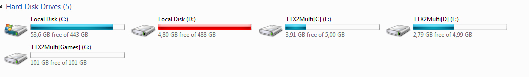

i dont have any errors in the writing process,and i able to see three partition . dipswitch 1,2,5 is on
i already copied Artfate Front end to my Multi SSD

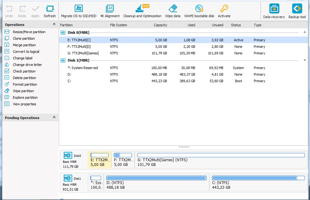

this is what the hdd looks like in Easeus parittion master
UPDATE
it doesnt work,i didnt expand games partition,still doesnt work,same problem. does anyone have torrent link with full games on it?
i dont know what to do anymore.
UPDATE
i use Niko Multi File 128 GB,still doesnt work,same problem. Taito Splash Screen and then Operating System Not found.
do you guys have a SSD compatible list ? my Kingston Supposed to be working well,but in this case i am gonna try to buy another SSD.
i believe this is not the Image Problem,its either the SSD or the TypeX2 itself.
