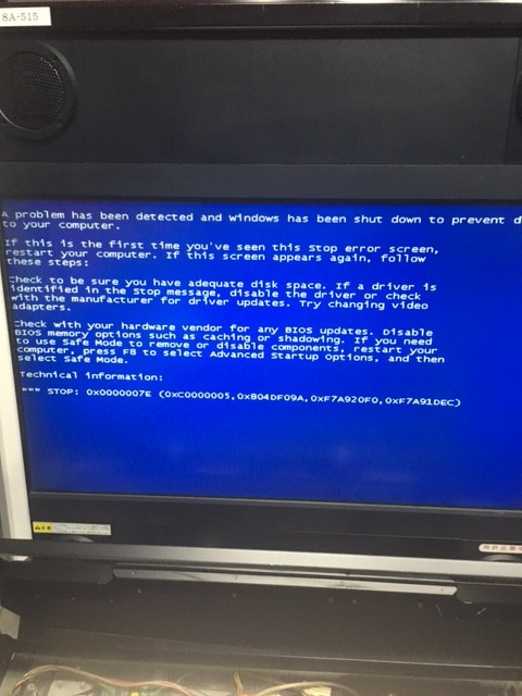

Looks like a bad video card to me.
(Prob, ram or GPU fault).
Next step: Test unit with a known good one. If old card tests bad, then replace with new part.

Hey Guys
This a updated picture I believe Lemony is right it is A Video Card issue.
Hi
I recently got a Taito Type x2 and I just received a Multidrive for it but I am getting this on my Vewlix F screen.
I NEED HELP.

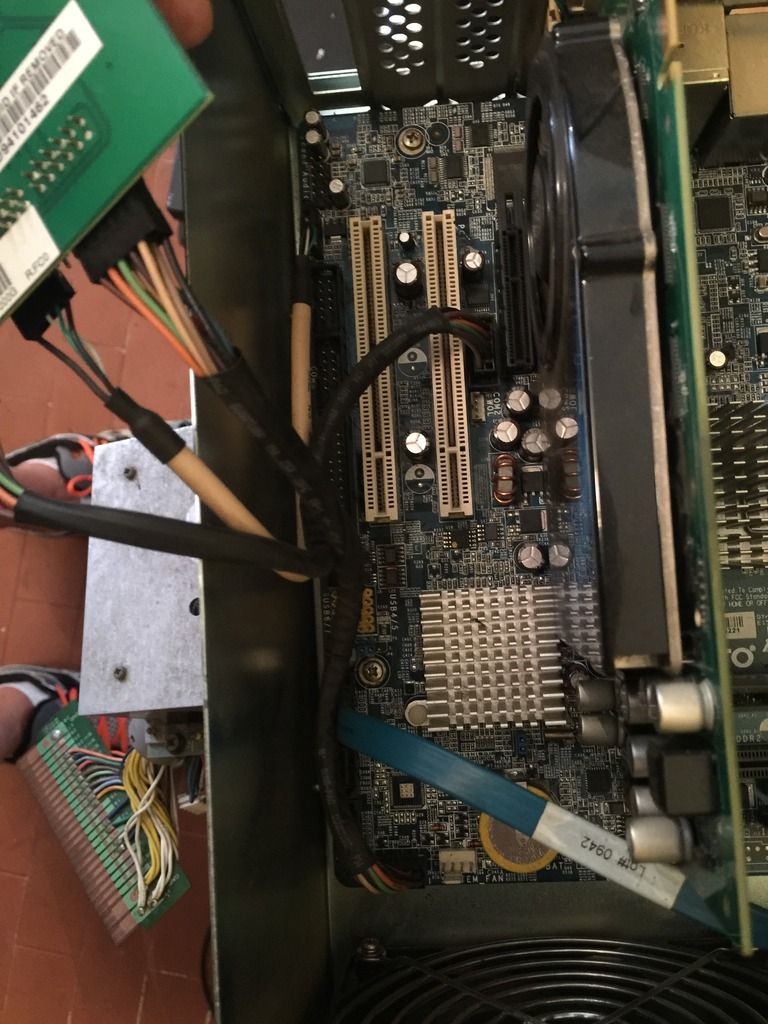

Here are the hardware details of this Type X2:
I tried connecting the Type X2 into a naomi cabinet with Sega JVS IO, with a Sega JVS-Jamma REV B. and with a Sega JVS-JAMMA Type 2, all with the same XIO ERROR.

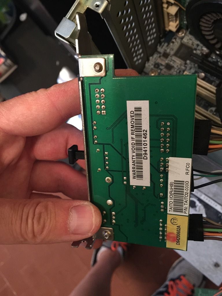

Here are the IO board into the Type X2:
Someone can help me resolving this problem?
Is this related to the game itself needed some specific IO interface, or it's related to something else?
I'm not familliar with that type of hardware.....

where's the dongle? If this is the original drive and game, then it needs a USB dongle to authenticate against.
Hi.
I recently got a Type X2 from Japan to have it multimodded.
But i got a problem IO problem and i don't know why, with it's original software (Cyberdiver).....
I got XIO ERROR(-3) as you can see below:
I received that way, without the dongle.....
Could be that the cause of the XIO ERROR?
If i understand correctly, i can resolve this problem is i use the Nico multigame, right?
So it could be related to that specific game?
Good to know it.
So i just need to know if the multigame works with the 9800gt.
Yes i mean multigame.
Niko was asking me to post pics of my FIO and conversion boards, I should do that some time...
