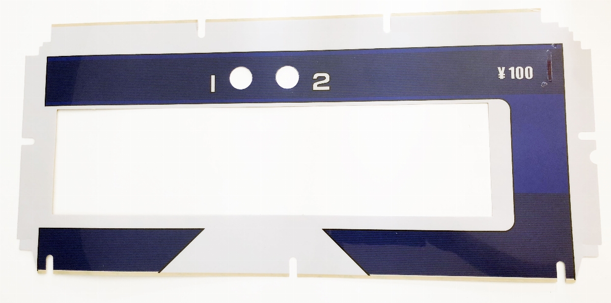

Has anyone applied one of these and have any tips? I've already ruined one and I was slow and careful with it.
Made several incisions in the backing so I could stick it down in sections but still managed to end up with a wrinkle that I couldn't correct and ended up having to scrap the whole overlay.

I did recently.
The only problem I had was the bottom part where your wrist sits. The overlay asks that you fold it underneath and stick to the bottom all the way around. However the the wrist section is especially tricky because it folds back even more due to the bend in the metal, causing the blue part to stretch and distort the graphic. Plus if you don't get it right the first time the adhesive wont be as strong. I had to use some 2-part epoxy to further stick it on then quickly bolt it to the CP frame so that it could sit. If you don't do it right the wrist section will bubble and make an irritating noise during play.
The overlay is pretty thick so you shouldn't end up with wrinkles.
I will do a write up about it when I post in my cabinet thread in more detail.

Yeah that bend at the bottom is a real pain in the ass and absolutely will distort because of the printed Lexan material.
Regarding the wrinkle, I'm not sure how it happened since I thought I had it aligned well along the top and Blue side, but along the bottom and White side, as I was starting to stick it down I noticed it was producing a bubble I could not flatten out.
It's probably for the best since I also learned that you do not want to apply it over anything but white paint. Anything else will show right through and alter the color of the white portion (primer, metal, etc.)

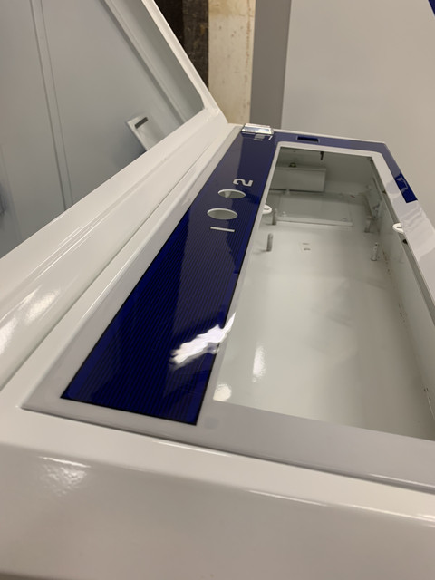

hoagtech
Mar 28, 2019
1,114
1,134
Bellingham WA
If I ever restore my parts Aero. I will mark the underside where it folds under the bottom of the CP and bend the sticker slightly then place a book and a cinder block on top.
have a crease there before application seems like a must.
I am really happy with the quality from gate-ninety. They are the thickest stickers Ive peeled.
